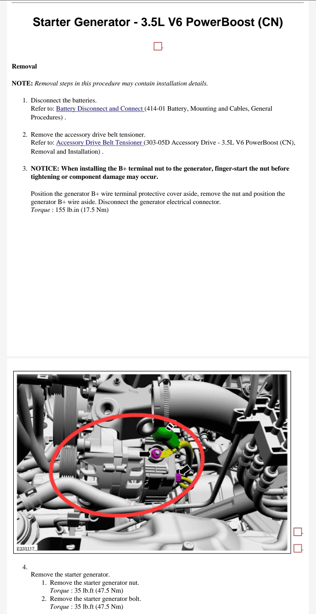

Dealer’s going to replace the generator and starter. Parts ordering takes 5 days and they don’t suggest I drive my truck in the meantime. I’m waiting for a loaner as we speak.
You threw that one momentary code, and no other issue, and Ford ok'd replacing components?
That's amazing.
By the way, those terms are almost generic on the Powerboost.
Which starter? (there's a couple)
Which generator? (there's several)
The Powerboost even has what Ford calls a Starter Generator. :)
CrAzY trucks
That's amazing.
CrAzY trucks
I know, it seems out of the blue to me as well. I asked the Service Adviser what issue they found, and she said it was the faulty generator causing that code, hence the replacement.
Very interesting.
Regardless of the ambiguity, at least your dealership seems to take customer service seriously. :)
