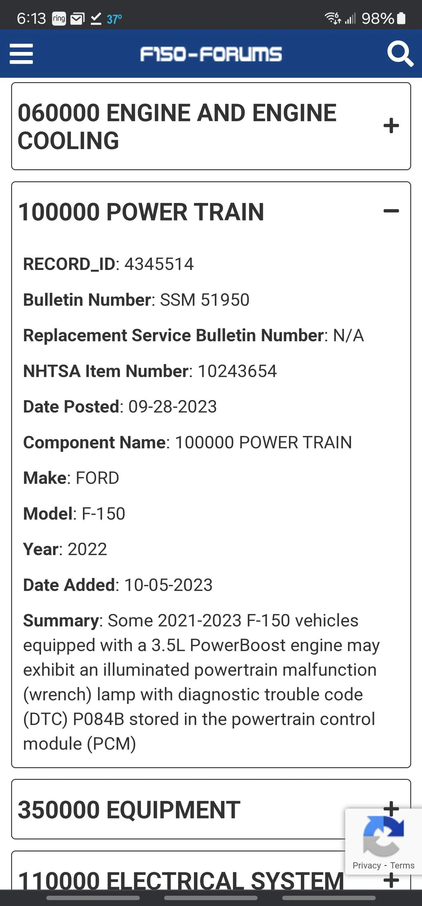

The BISG (Ford's acronym for the "Belt Integrated Starter Generator) has been being mentioned in various threads as being replaced on folks trucks.
I personally believe that the warning Stop Safely Now, or Power Train Malfunction, are both generic in the sense that multiple things can trigger those alerts. Neither the remedy or the cause will always be the same.
