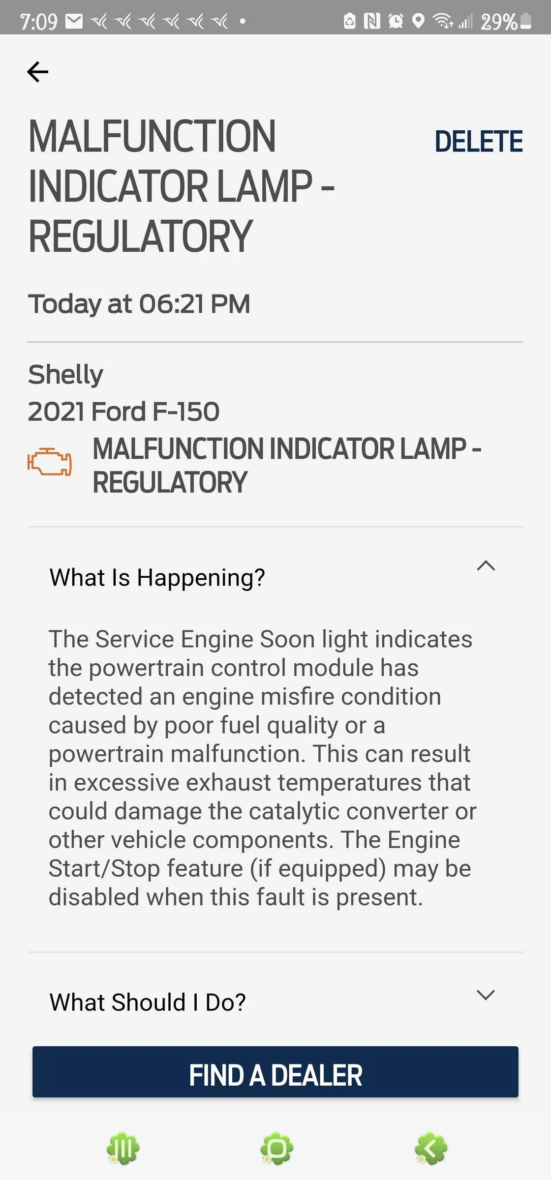

2021 F150 lariat powerboost 6,200 miles had it in for the sagging insulation recall this week as well as a oil change then 5 days later while driving all of a sudden it was stuttering bad and than the check engine light came up. I have read multiple threads but no real answers, Any help would be appreciated picture below of ford pass alert.
Ford F-150 Powertrain malfunction/ misfire .. Screenshot_20220320-190925_FordPass

I had similar issue, but only lasted for about 20 sec. Got the same alert. Seems ok after that, but I took it in and they tested and found a bad spark plug.
