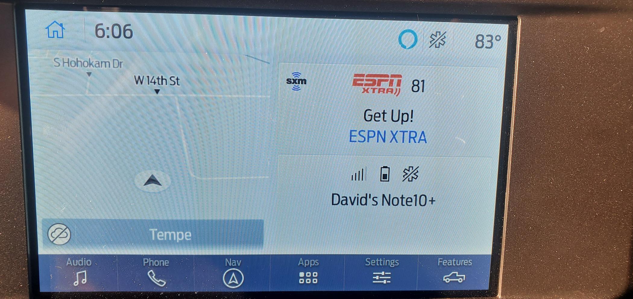

Hello guys.
Im having some issues with my 2021 F150 powerboost, I lost the powerflow screen after an update about 2 months ago, also now im dealing with no connectivity message on the display, no traffic for maps and no wifi. Has anyone had problems like this? I have Forscan, can it be resolved with that?
Any help would be greatly appreciated guys!
Also, need to mention that I have the 8"screen on my F150 XL.

Hello Javier.
1FTFW1CD2MFD01692
I attached a pic that shows the cloud icon with no connectivity and the missing icon for the powerflow screen was sandwiched between the settings and the "Davids note 10+" phone name, bottom right side.
I have done the battery cable removed all night, the power cable from the Telematics unit removed for 5 minutes and all night, deleted the truck and now cant get it back with ford pass. Also restored to factory settings with a master reboot.

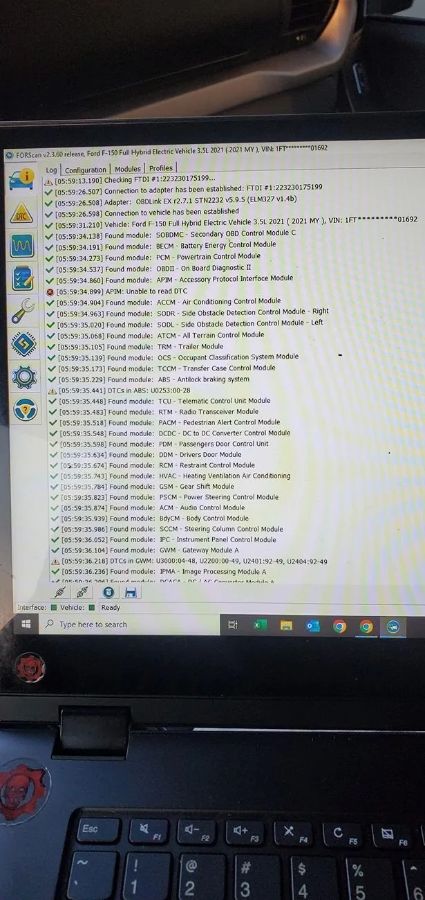

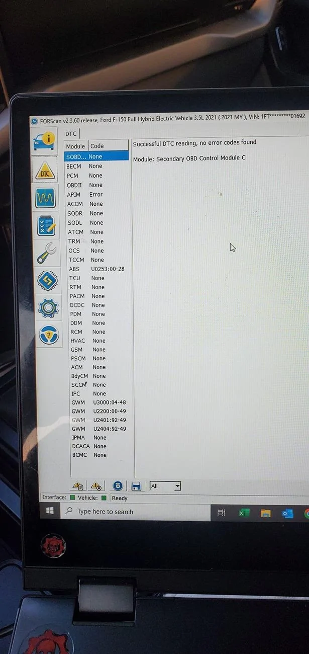

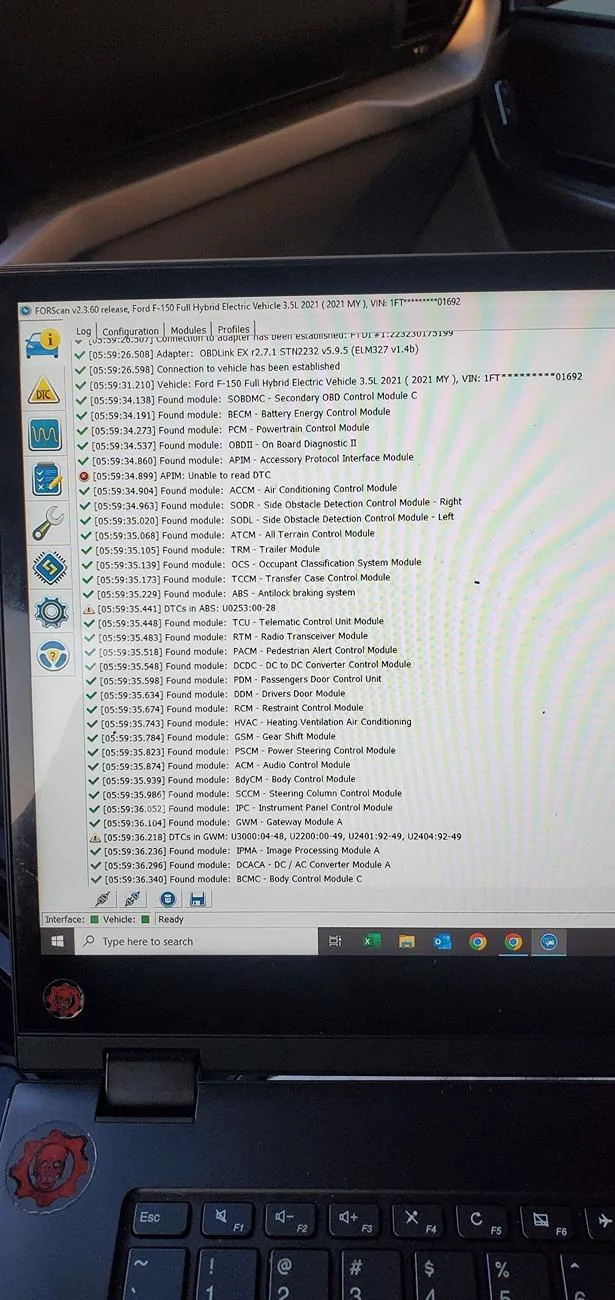

Oh, my bad. I'm guessing since you didn't quote me or tag me when you responded with your VIN, I never noticed you responded.
Anyway, the country code in the TCU is correct, but PTS shows your modem is not authorized, so it is offline. Therefore, I cannot see any codes your truck may be reporting. Since you have FORScan, plug your truck in and post screenshots of any codes it is showing to see if that can help pin-point the problem.

Hello and thank you for your help!.
Took these pic today, ill have time today if more is needed.

That is an unhappy gateway module.
When you go into software update and hit the details button, does it still show an update there? Should have text at the bottom with the update name installed.

Have you tried resetting the gateway module?
Should be under the wrench icon.
Also try clearing all the DTC.
