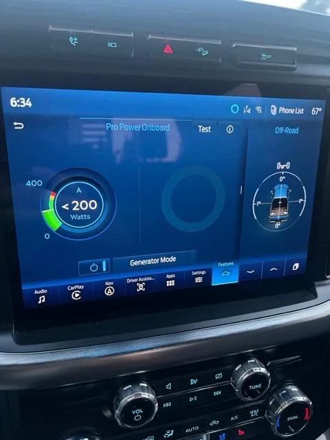

Update on this. So this morning I drove the truck to work, and I noticed the Pro Power Onboard was on, but generator was off (see top pic). I then turned everything off (bottom pic). Not sure if this related to the starting issue yesterday. When the car shuts off, it shuts down all the power outlets anyway right?
