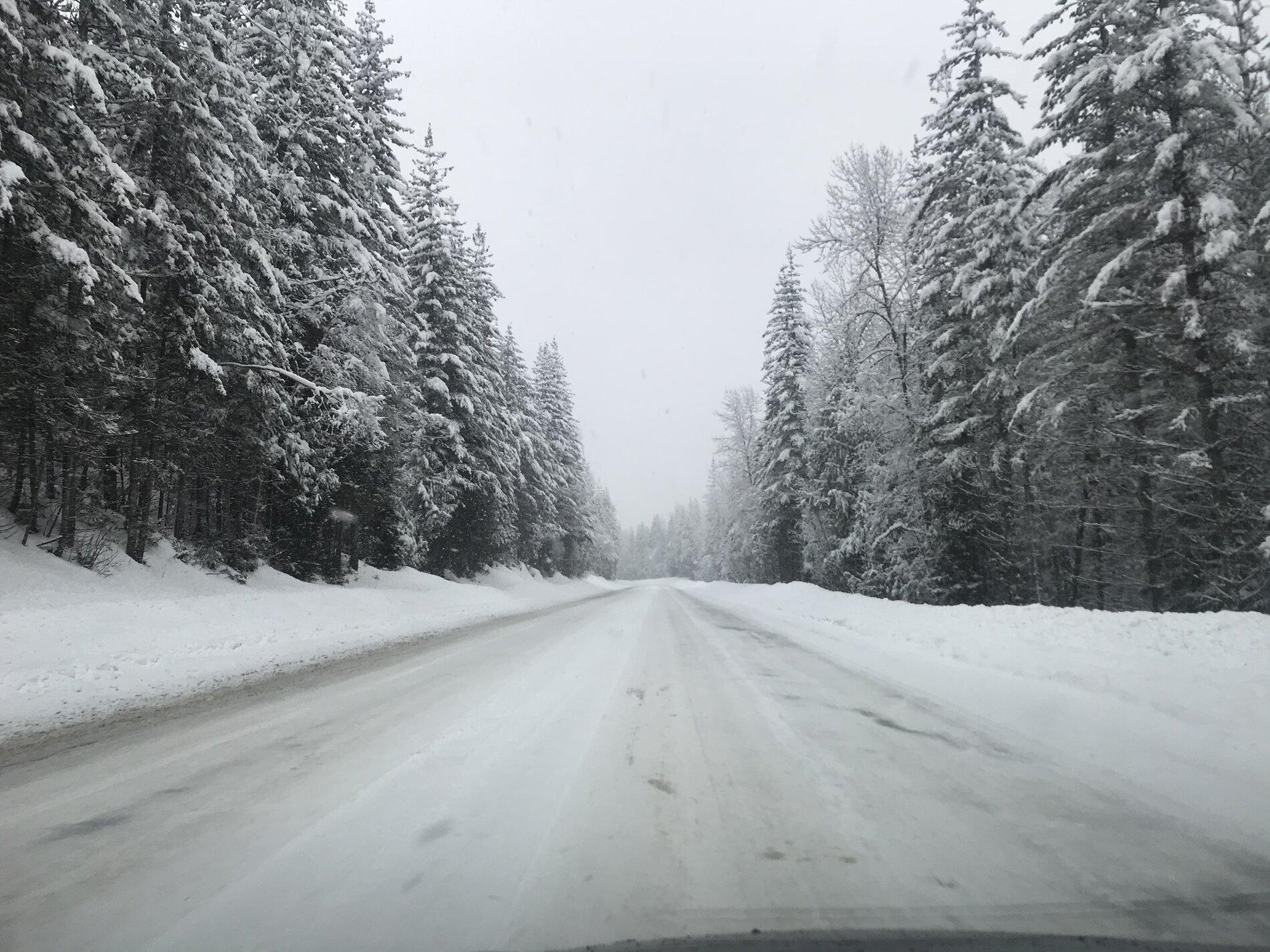

Having a Powerboost on order, and as someone who regularly drives in snow, I certainly hope the regen braking is not a safety hazard. This is a photo I took just today driving on the TransCanada highway east of Revelstoke. This is part of THE main highway across Canada! Having the rear wheels accidentally lock up to charge the battery in these conditions would be very dangerous.

Honestly, I suspect that it will be fixed. My complaint is the only one that I have heard of. Maybe it is just my truck. It is a non issue in 4wd, only in 2wd.
I have just 1000 miles/ 1600 km's on the truck and it has been absolutely amazing.
