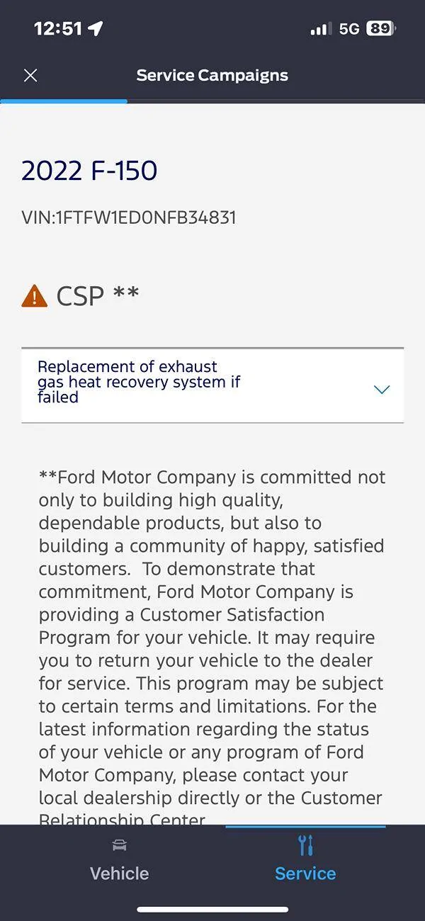

I recently had my 22 PB in for a few issues. One was ICE to EV and EV to ICE creak or squeal noise. After a back and forth with the service advisor I provided a copy of WA_502A’s (Thank you!) service receipt and a screenshot of the Ford Pass Service campaign to replace the “Exhaust Gas Heat Recovery system”. The service advisor quickly responded and said “ Great news your repair is covered “. I’ve read somewhere else on here that replacing that valve increased MPG. Sure enough mine went up several MPG immediately after getting it back from the dealership.

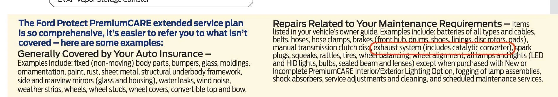

I have the PremiumCARE plan. This is what the brochure says is covered for the Emissions parts. Apparently "Exhaust Heat exchanger" isn't on here (unless it's just called something else in the brochure)
Ford F-150 Powerboost squeal when going electric to ICE - Help me! Premium Care Emissions Parts

There's also a brand new CSP regarding the Exhaust Heat exchanger and Ford is warranting it now for 15 years/150,000 miles for a 1 time only replacement.
Admittedly it's not specifically for the noisy valve, but rather a malfunctioning valve. But maybe your noisy valve is an impending failure?
Yeah, I just checked and I've got this in my Ford Pass too. It's the same CSP that @Snakebitten mentioned. Keeping my fingers crossed. There's not certainly they say it's covered since I don't have a coolant leak.

After some back and forth between the service center and Ford customer service, the I was told by Ford that this isn't covered under my Premium Care ESP nor the drive train warranty. Ford did offer to "help" by covering $500 of the nearly $1,500 repair, but this isn't what I expected.
I mentioned the CSP that @Snakebitten and @Jasco informed me of and they're checking to see if it's covered under that. I'm worried they'll tell me it isn't because I don't have a coolant leak or a complete failure.

The service advisor at the dealership tells me that the exhaust heat exchanger in CSP 24N04 is "a different part" (and it's one of the "first things he checked"). How many exhaust heat exchangers are part of this hybrid system?
Still going talk to Ford Customer Service, but I'm afraid they're going to point to this fine print in the PremiumCare brochure.

So, still dealing with this. Ford offered to cover ~$1K and the rental which would leave me with something like $500 to pay out of pocket. I tried speaking to a supervisor at Ford Customer service (which took forever since they give you no way to contact them directly and you have to wait for them to call at some random time of day). They claim that if the part number (PL3Z5A212B) isn't covered then they can't do anything to say it's covered by any of the warranties I've got (Powertrain, PremiumCare, or CA Emissions warranty).
