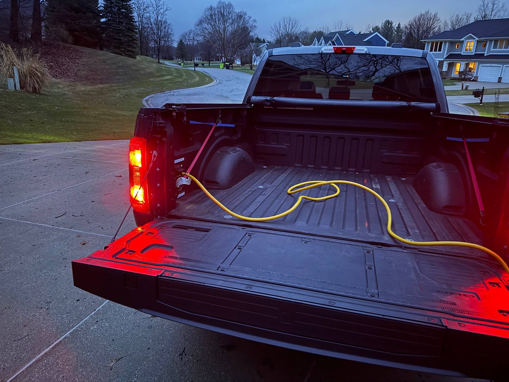

I don't have anything set up yet hardwired, but when we lost power in the windstorm a couple weeks back, I flipped off our main breaker, and backfed through my dedicated 20A RV circuit outside the garage (just one phase, so half the main panel) and was able to power our fridge, living room (TV/Lights), boiler, bathroom, and a few other things. (Yes, I KNOW, electricians please do not crucify me, and yes I had to break the ground where I plugged into the receptacle)
I ran another 12ga extension cord to the truck on the B side to run the microwave and rotated with other high power loads (wife's hair dryer, etc) when needed. Peak draw for the "half a house" was only 850watts for all the "essentials". We let it run all night, and for just about 24 hours of use we used less than 1/8 tank of gas.
Once I get a transfer switch set up, I should be able to weather any storm for any length of time easily with this truck. Could probably even run the electric stove (probably not the oven) if I were careful with other loads. Electrician comes out in 2 weeks.
