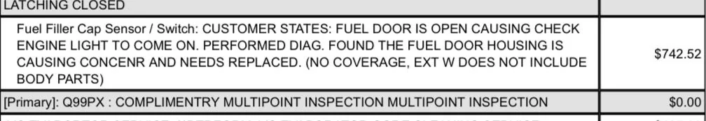

Here is a picture from a customer of ours a couple weeks ago. As you can see it says his warranty won't cover it which is insane, so he ended up buying a billet pin kit from us instead and saved himself $700

Thank you Will. I ordered the Billet fuel door pin. I hope it works. Now I have figure out how to turn off the "Check Engine" light.
Once you install the pin and the truck sees the fuel door latching properly again, the code will self clear! Thank you for buying a Billet Pin, you will be extremely happy with the quality and effort put into the solution.
