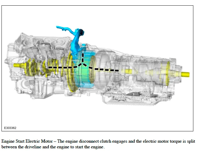

Just curious where you found that info. I read the service manual I got for my truck, and based on the starting sequence, this is not something the truck does. It uses the traditional starter for cold starts and the generator/starter for everything else.
Honestly, on here. I’ll see if I can find where. I jives with what I feel though. And I know for a fact the traditional starter is extremely rarely used, source is putting 12,800 miles on my Powerboost.
Edit: attached service manual excerpt I found on here

Powerboost has 3 methods of starting the engine.
2 used in normal operation are a belt integrated starter generator which is the only belt on the engine and it uses the small electric motor (starter/generator) to spin up the engine via that belt. This method is used most of the time when the engine is needed while stopped or at low speeds.
Second is effectively “bump starting” the engine by connecting the clutch between the flywheel and the electric motor/transmission assembly, this is used when traveling at higher speeds and the engine is needed.
Third is rarely used which is a 12V starter to the flywheel. In 12,800 miles, I’ve heard this starter 4 times. It’s only used in a condition where the high voltage battery is either very cold, or below minimum state of charge. You would only hear/use this starter when first pressing the ignition. Never while driving.
