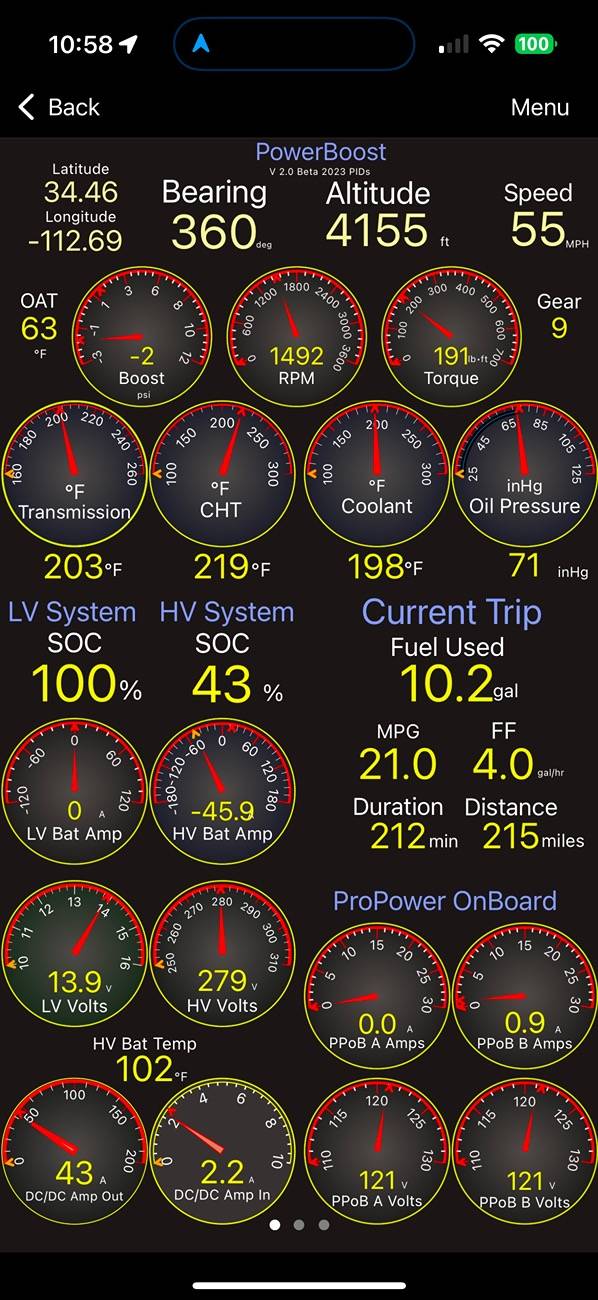

A new version of PowerBoost is now available. For newbies and those with PowerBoosts from the 2021/2022 model year go to the previous PowerBoost 1.5 thread. Also you will find troubleshooting tips in the previous PB 1.5 thread to deal with installation problems you may encounter.
PowerBoost 2.0 was developed on a 2023 PowerBoost using 2023 Ford Enhanced PIDs. If you have a 2024 PowerBoost test it out and see if it works then report back here. This version of PowerBoost will likely not work on 2021/2022 PowerBoosts but I have not tried it. All the testing of this version was done on my 2023 PowerBoost using 2023 Ford Enhanced PID's.
This is a very busy screen. I use this version on an iPhone 16 Pro Max with the iPhone mounted over the vent just to the left of the Sync screen. I have not tested this version on a smaller iPhone screen or any Android devices. I have found it is less distracting while driving to present all the PID's on one screen rather than paging through different dashboards. Others may prefer to create several larger font dashboards. Not hard to do in the editor.

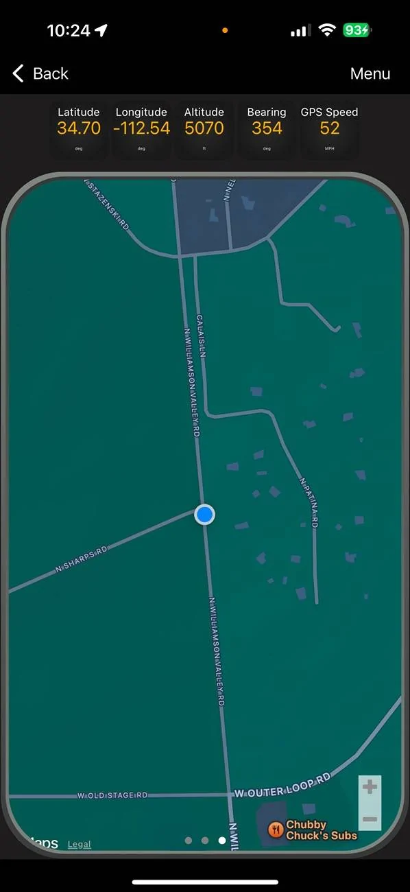

This version of PowerBoost includes a second dashboard screen that is a Apple Map rendering of your current position.
Give it a try on your various devices. Let us know if it works on 2024 and 2025 PowerBoosts.
Here is a direct link to PowerBoost 2.0 ".stg" file.
Dashboard 1 and 2

Nice work! YOU are truly the MX+ OBDLink Guru, I have stolen bunches from you, thanks!

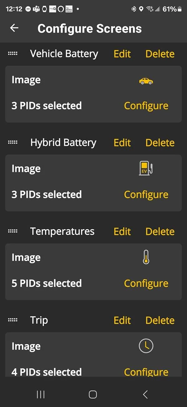

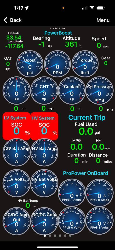

EDIT: 11/28/2024
I used the iOS version from your post and it worked great on my iPhone16+. I then imported it into my Samsung S24 Ultra and all worked.
EDIT 24/12/02: See post #18
Ford F-150 PowerBoost 2.0 - We Need More Than Idiot Lights Screenshot_20241128_001258
Ford F-150 PowerBoost 2.0 - We Need More Than Idiot Lights IMG_0027
