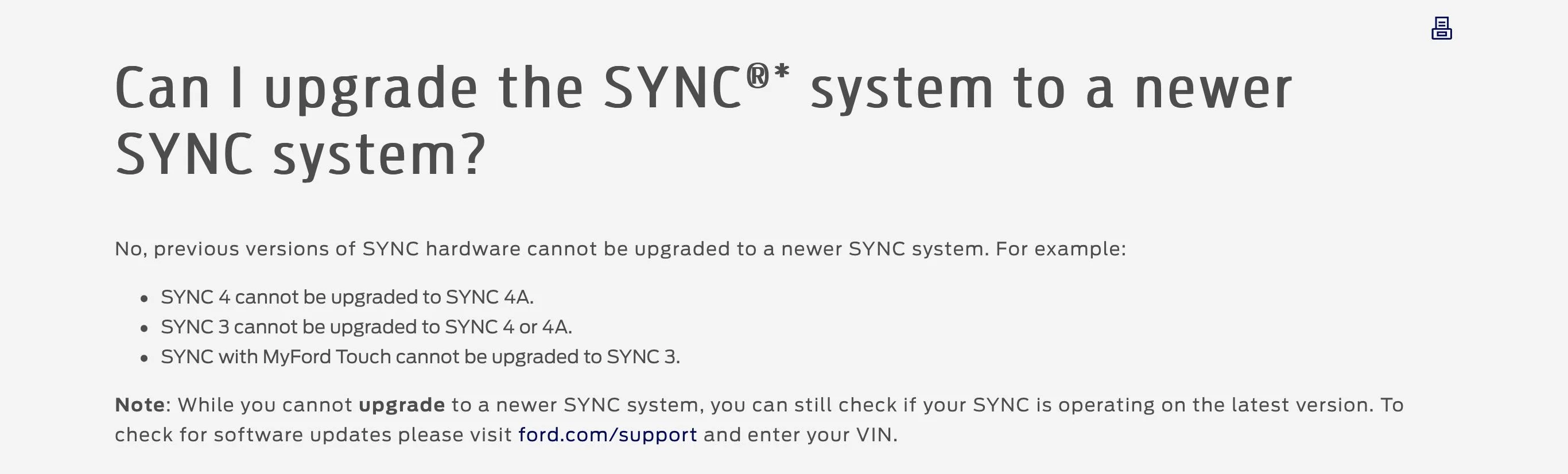

I just received this e-mail from Ford. Not sure what this means but I have a 2021 Job 1 Lariat.
I got the email too for my Job 1 2021. The email promises simplified screens. I'm not sure they're overly complicated now. I'm very curious what they are planning.
My 2ND Ford
Jun 28, 2021
728
790
Ny
Ford is shipping all us F150 owners new Sync4 screens for our non-Lightning trucks.
HammaMan is suggesting we not waste our time retrofitting.
I think I trust his advice.
He would know. :)
I don't need no stinking hardware upgrade. My truck is working perfectly fine, thank you very much! LOL

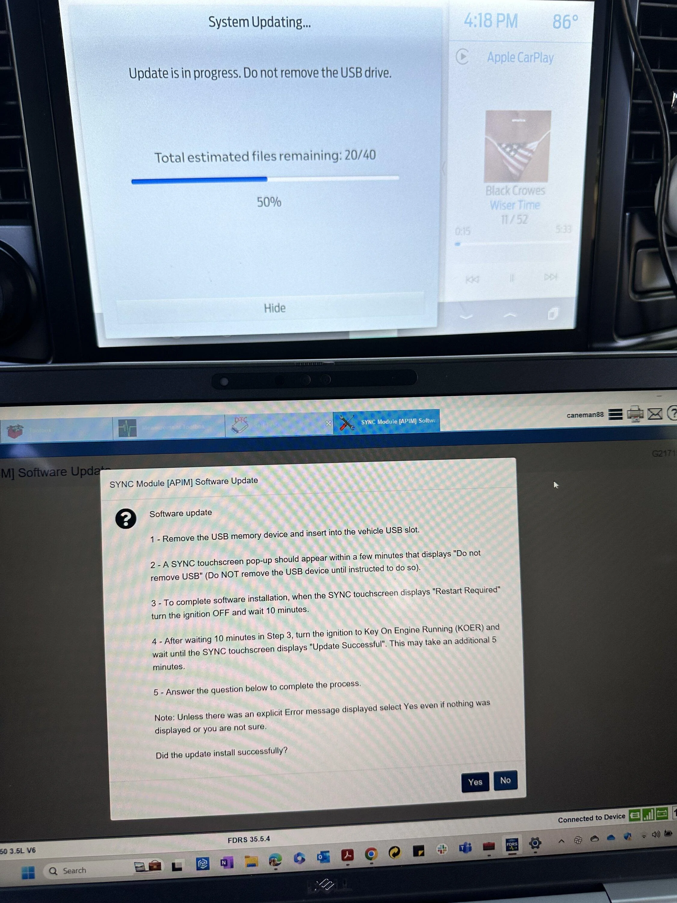

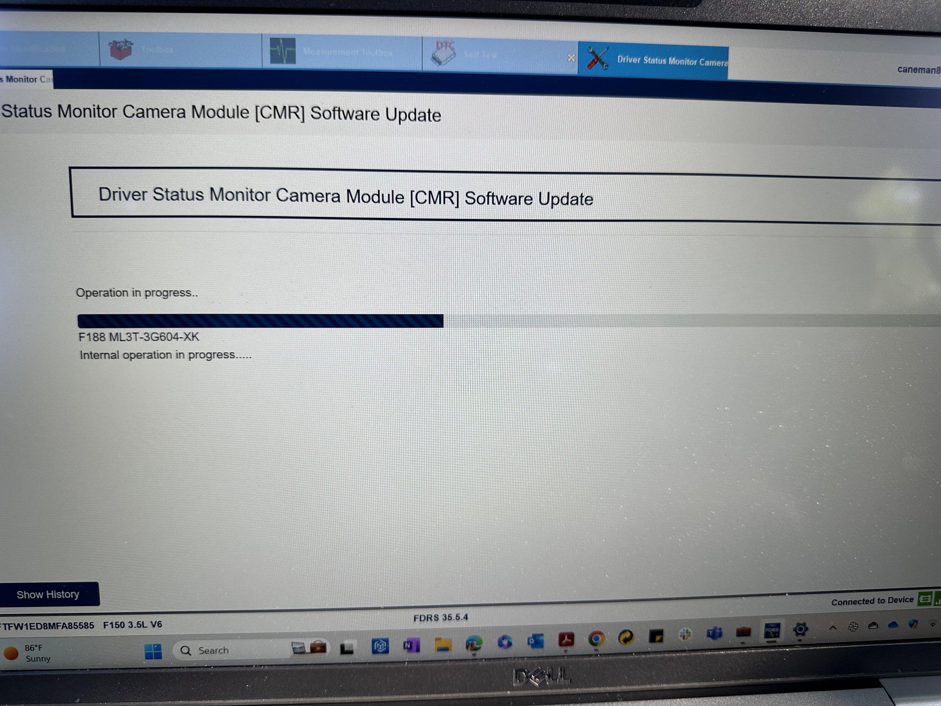

Got tired of waiting on Ford so bit the bullet and got the Mongoose downloading APIM at 4gb/5gb being loaded on thumb drive I was stuck on 3.52 right before ACP full screen
My Job 1 platty and part of EAP since Aug 2021 have BC
Here we go 2 hours later
I had very mixed emotions when I finally broke mine free with a mongoose. It was very rewarding to get everything working, but also very frustrating that I had to go through the journey in the first place. Congrats on finally getting the truck you paid for!

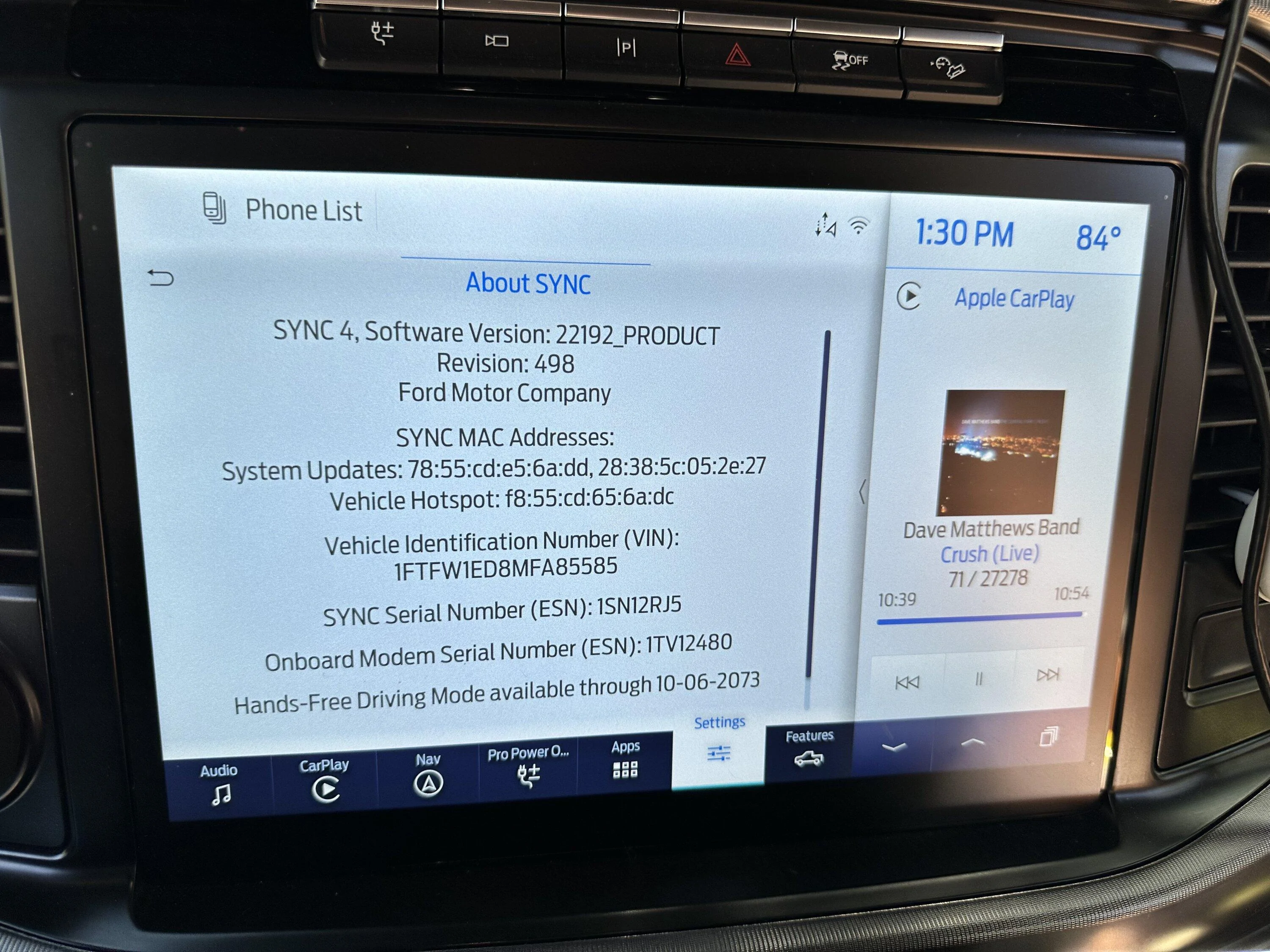

I got the same email SYNC 4A, but looking around it says this:
Ford F-150 Power-Up 4.2.1. OTA software update installed today 09A4033B-EFC8-45BA-897F-B1DEEC57A7ED

Just got 4.2.1 today while driving. Curiously, I think it skipped from 3.5.3.2. I could be wrong though.

My truck has been undriven on a battery tender for 2 1/2 weeks while I was out of town. At the 2 week mark Ford Pass tells me its in deep sleep mode. Started the truck yesterday and Ford Pass says I have 4.2.1. What is early access?
