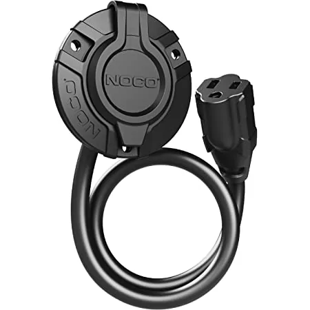

I'm considering adding a permanently installed battery tender. I've done this in my Pontiac Solstice as it can easily go months without being driven and it works well. The difference here is that I don't want to have to pop the hood.
So a few questions in case anyone has any input.
  1. I've done some research and some say putting a 120v power inlet for the battery tender is a bad idea. Actually they suggest even putting the battery tender in there is a bad idea. I've never had a problem with this on my solstice. Can anyone think of why this would be a bad idea?
  2. Even if I keep the battery tender exterior, I would want an easily accessible power inlet for it to connect to. So if it's 120v or 12v, I would need a location to put it. I'm thinking somewhere on the front bumper or just under it. Thoughts?
This is the 120v inlet I'm looking at. Though I hear there is one that can eject the plug when a 12v source is applied. I might look into that.

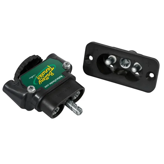

Battery tender makes a 12v one for their stuff (I'm sure other companies do too):

So the reason I'm leaning towards 120v is convenience. No matter where I go an extension cord could be used to keep the truck charged i.e. even right now my solstice is at mom's house a few blocks over. All I needed was an extension cord to hook it up (it stays over there during the Halloween season as we decorate). I also don't have a garage so if I use the 12v option, that means I'm leaving the battery tender outside in the open, though I guess I could devise a lock box for it.

The picture I show above is either the NOCO power plug (just basically an extension cord you can install on your truck, car, trailer, etc), which you would plug a battery tender into. Link is here: https://no.co/gcp1
The other is just a battery tender plug and port (no actual battery tender). It provides a way for you to easily connect a battery tender device to whatever you want to charge (car, truck, boat, etc). For this one, you still have to have a battery tender external to the vehicle that you wire into the "plug" portion of the connector. Link is here: https://www.batterytender.com/dc-power-connector

I feel I should elaborate on the first one. It's a 120v plug you can install for external access. You place the battery tender in the truck somewhere and run the 12v to the battery to charge it. This way you are only using an extension cord to trickle charge your truck/car/etc.
The latter is just basically letting you run a 12v line from the battery to an external port and the battery tender would live outside the truck/car/etc.

The battery tender connector pictured is for trolling motors , so it is designed to accept up to 6 awg wire. You could easily extend the cable from the battery connection and feed it out thru the grille or bumper area for a whole lot less. If I have to park the truck outside on the tender, I place the tender on top of the engine cover and close the hood. Sits there fine. I only do this when the truck is doing an update because the signal gets blocked in my garage, otherwise the truck sits in the garage on the tender. The tender doesn't put out any more heat than the engine, so I don't see any problem having the tender under the hood. You just need to remember to remove it before starting the truck. Sorry for the long winded reply.

I figured that port was for their chargers, wasn't sure and didn't know it was for trilling motors. I don't even know the cost because honestly, I was just going to go the 120v option and install the NOCO power plug somewhere with a battery tender under the hood. After reading some concerns online about keeping it under the hood, I thought I would safer than sorry and ask all the fine folks here who are more experienced with these trucks and their engines.
