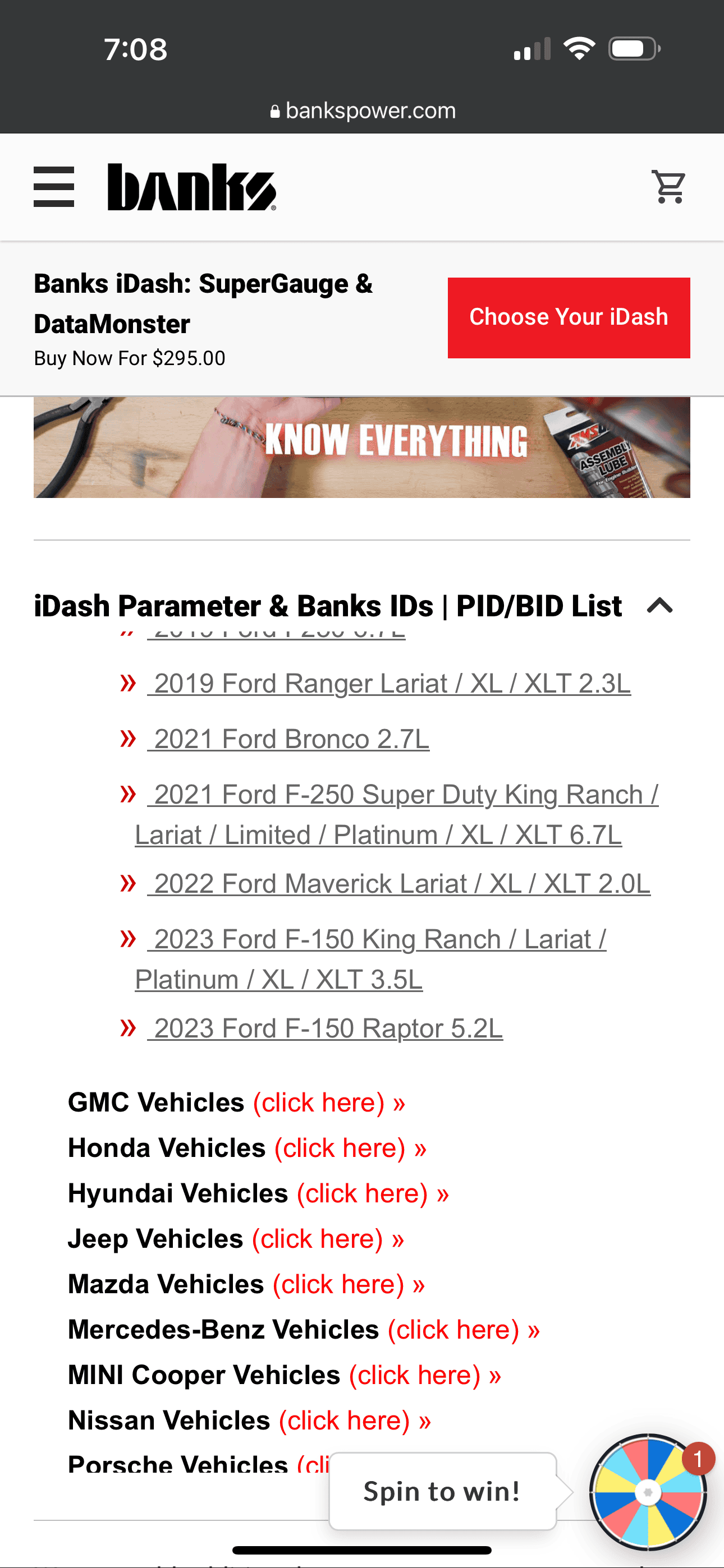

I went through their drop down menu and it stopped at 2020. But, thanks for the info. Only coolant temp that I care about, nothing related to trans temp or oil temp/pressure. Surely, this data has to be somewhere in the truck CPU/monitoring system
is there a way to enable transmission temp monitor on another solution for an XLT? Any aftermarket solutions?
It's amazing that the Gen14 XLT digital dash is every bit the equal of the Gen13 Limited dash, yet we haven't found a crack for the digital temps yet. It's crazy.
