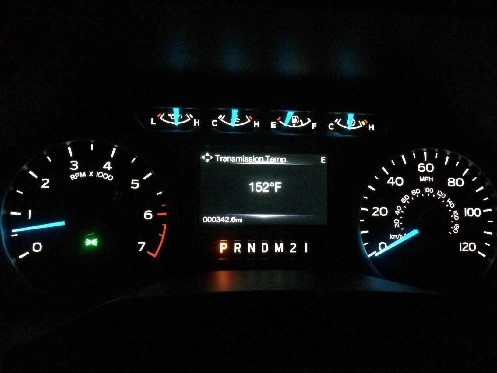

It's amazing that the Gen14 XLT digital dash is every bit the equal of the Gen13 Limited dash, yet we haven't found a crack for the digital temps yet. It's crazy.
Even more bizarre is Ford eliminating what WAS exclusive to the previous XLT display..... The large Digital Transmission Temp option in the truck information section.
I concur about Ford's elimination of the transmission temp read out on earlier Gen trucks. My old 2014 XLT w/ HDPP had that feature. I especially liked it when towing in mountainous regions.

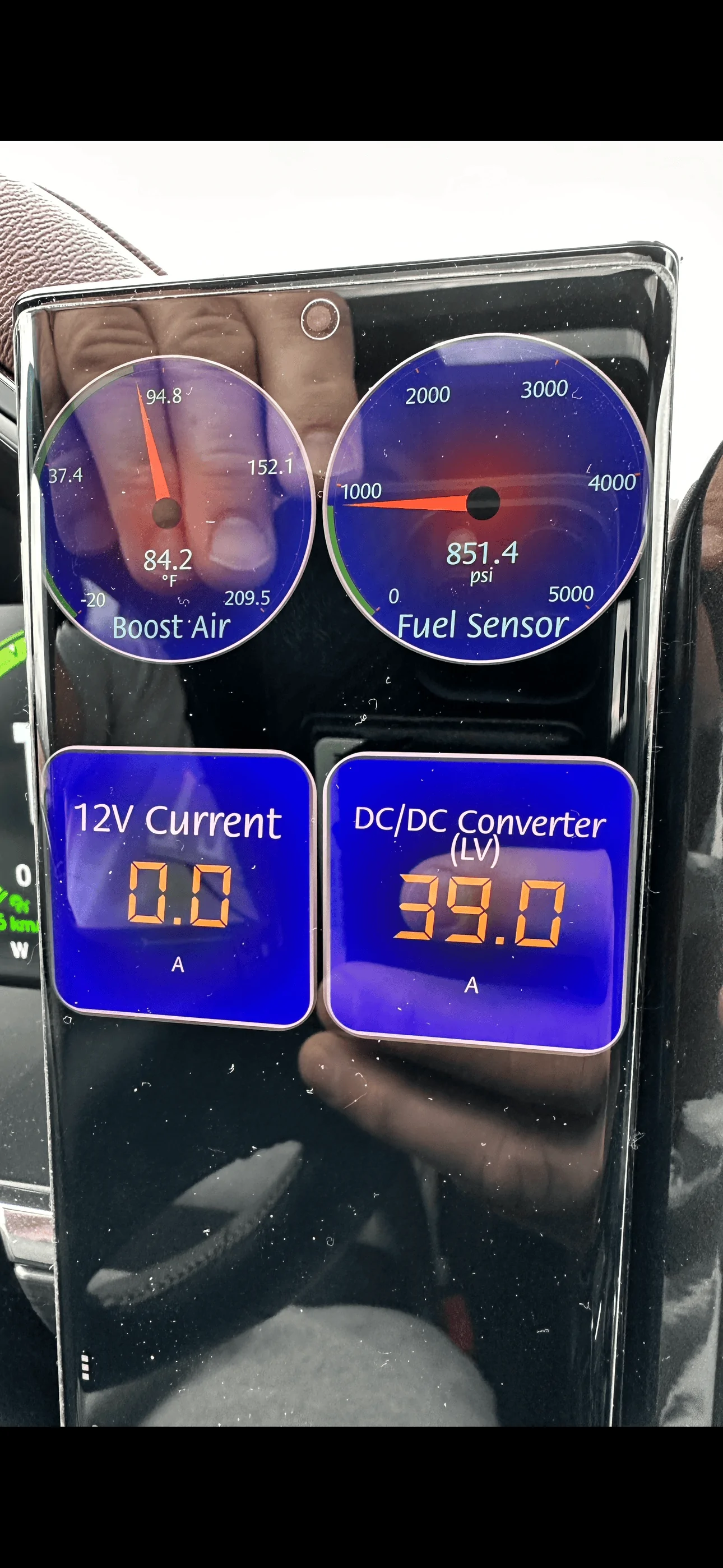

It was suggested when I asked a similar question to look at the MX+ OBD2 Dongle and related OBD Link app. Yes there is a bit of a curve to set up the gauges but the results are great. I wanted to be able to see some of this info without forscan. Downloaded the app to my last Samsung phone and use it standalone in the truck after some help from others posts here in the forum. The dongle is plug and play. Once connected it updates and scans truck for all PID info. I’ve attached a couple photos. There is more available but for now this fits my needs towing and general awareness.
Ford F-150 PB truck vitals monitor IMG_0598
Ford F-150 PB truck vitals monitor IMG_0599
Ford F-150 PB truck vitals monitor IMG_0600

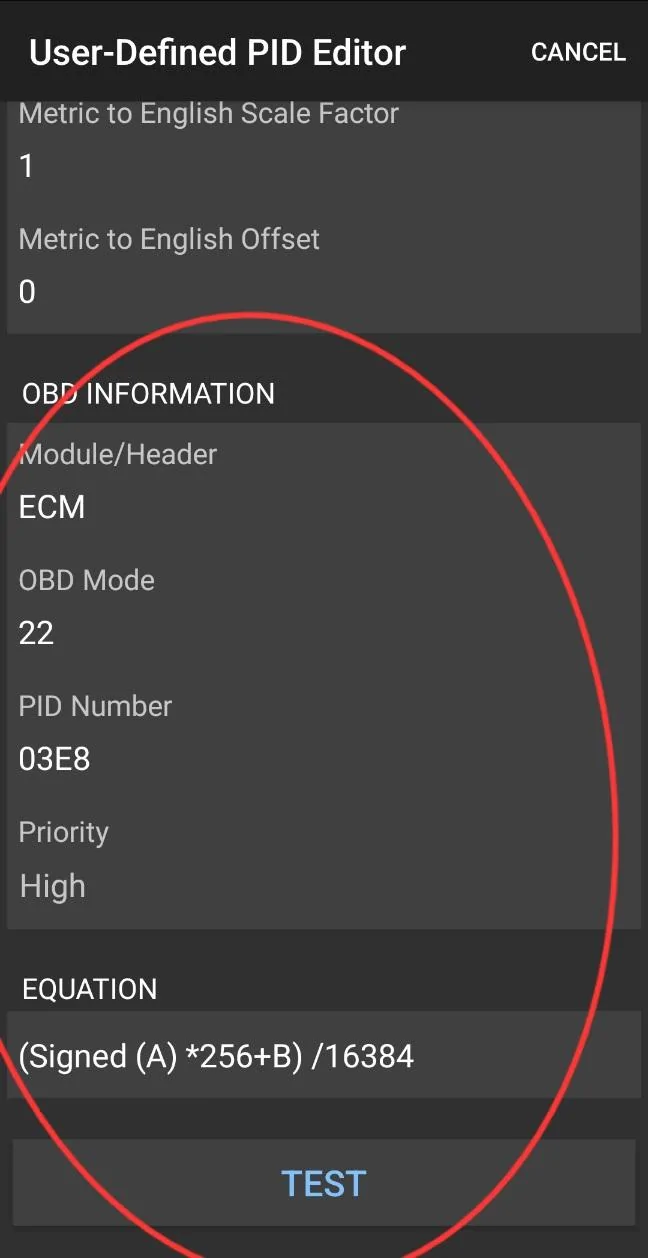

I use the OAR PID in Obdlink app, but it is a "user defined" PID, since it's not included in the PID library of the app.
If you could locate the actual "address" and "formula" for the oil pressure gauge, you could create the user defined Pid. However, things like Forscan and HPTuners Ngauge do NOT reveal their secrets. They will provide you the gauge/value/result of querying the PID, but they won't share with us the code for the PID itself.
I found the code for OAR on a Ford Focus RS or ST forum. So someone cracked the code on OAR. But I have diligently looked for the oil pressure code and haven't seen a whisper.
This is the necessary information for building a PID. (OAR, in this example)
We simply need the values for oil pressure
Ford F-150 PB truck vitals monitor Screenshot_20230616_130020
