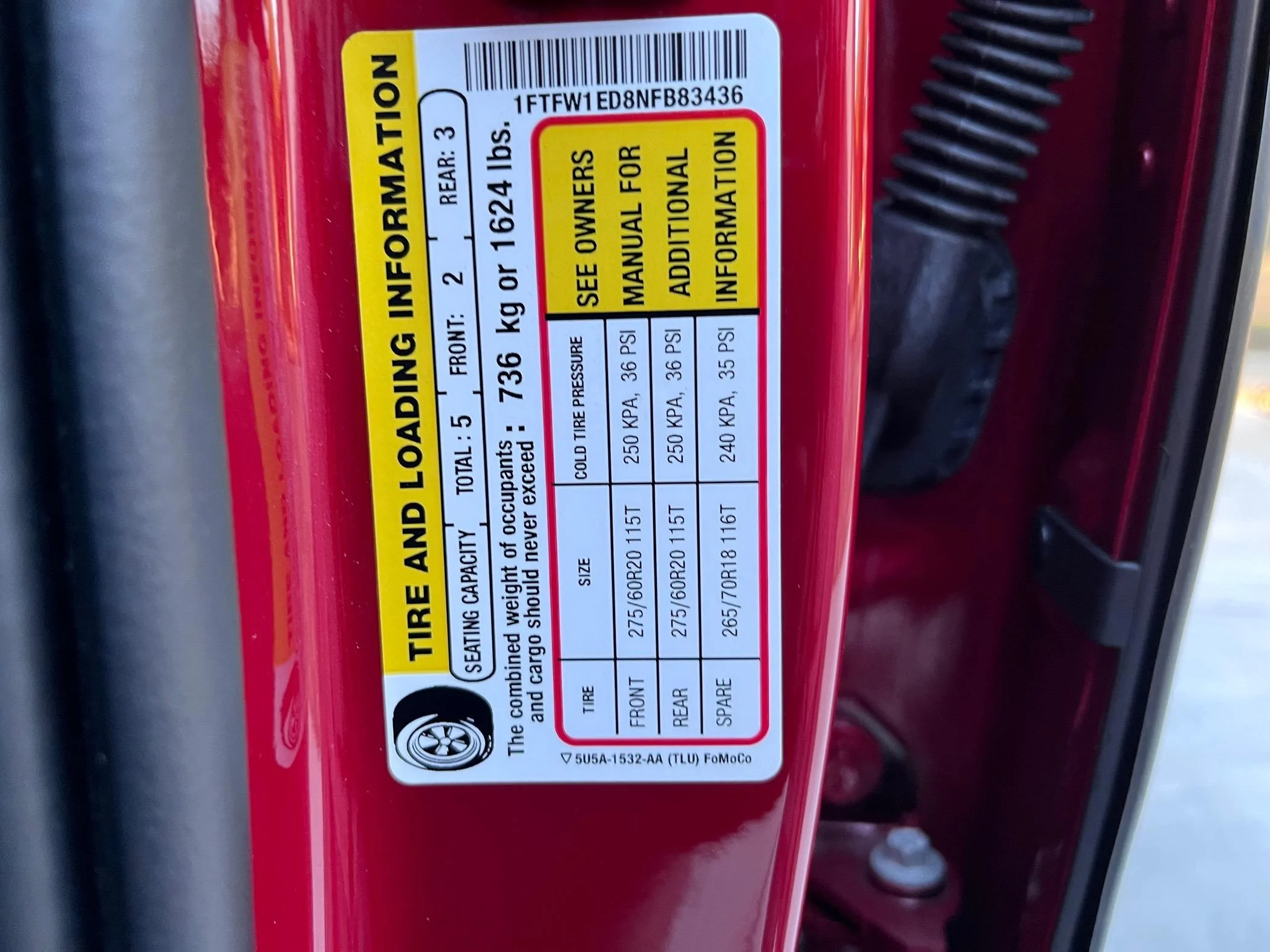

I am so depressed ....20" wheels,4x4- no skid plates,Pano roof, bed cover, spray in liner, Powerboost, running boards, regular tailgate with pull out step, 2.4kw propower,Not Max Tow ...1307 lbs !!!! I mean damn, I would have gotten superduty had I known it would have been this low

Yeah it adds up quick. I am looking at 3.5 eco XLT's just for payload

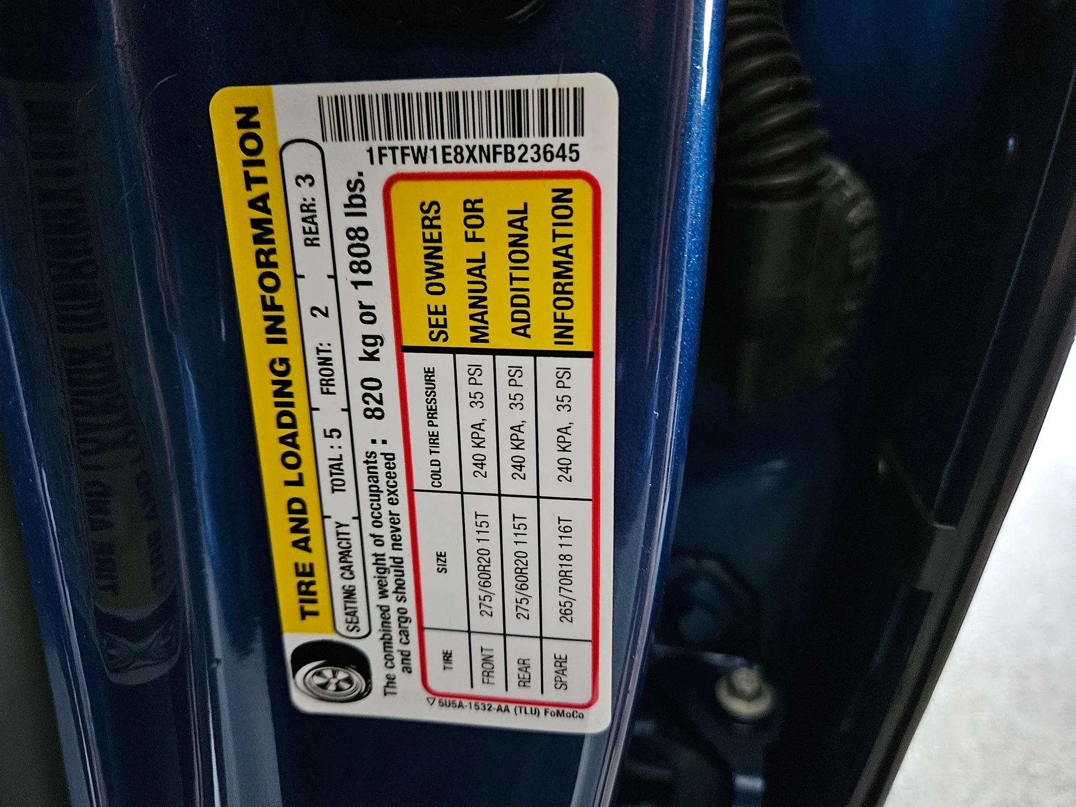

I think the pano roof and deployable running boards are heavy and difficult for PB payloads to absorb.
My little PB without those items:
Ford F-150 Payload on a 6.5 Foot Bed XLT vs Lariat IMG_1748
