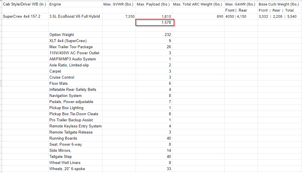

UGADawg96
Feb 28, 2021
3,511
6,199
JAX, FL
This is helpful for sure... While not 100% accurate, I'm guessing possibly close.... although it missing some things.... I'm calculating 1578 payload, but we'll see when it actually arrives. I am thinking closer to 1500 than 1600 based on other's payload stickers, but we'll see.
XLT 302a, SuperCrew 6.5' box 157" WB, Oxford White, Powerboost 4x4, 7.2kw pro power, Max Tow, 20" sport wheels, Sport package, 360* camera, Co-Pilot360 Assist 2.0, Tailgate Step/work surface, Box link, onboard scales, wheel well liners, tow mirrors, interior work surface, power adjustable pedals.
You can drop the Inflatable Rear Safety Belts, they are no longer offered. https://fordauthority.com/2020/08/2...e-rear-seat-belts-in-favor-of-pre-tensioners/
