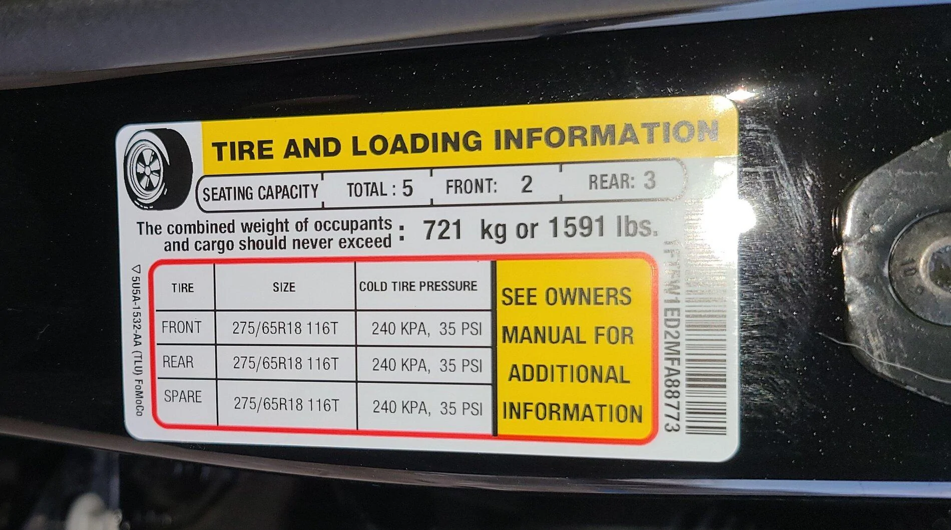

The CCLB XL I picked up today has 1990lb payload. I was pleasantly surprised.

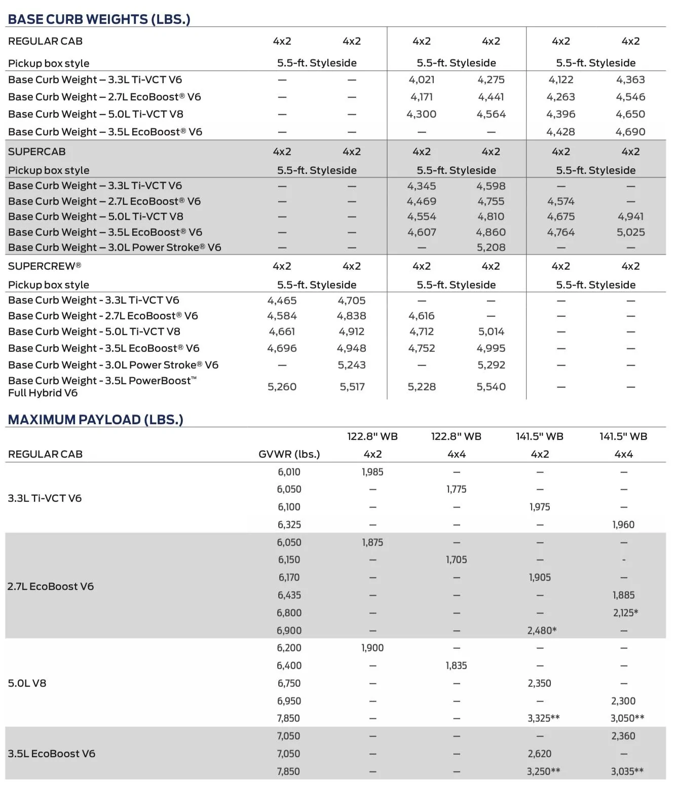

According to the technical specs, the base crewcab f150 isn’t that more heavy than the base single cab, though I imagine that disparity is greater when using steel doors and cabs.
Ford F-150 Payload #'s 6D50B626-4EC6-42F5-A078-3D2967BE4E45
Looks like someone messed up making the table, just copy/pasting 4x2 5.5’ styleside into every heading :/ but anyone familiar with the model should be able to figure it out.
