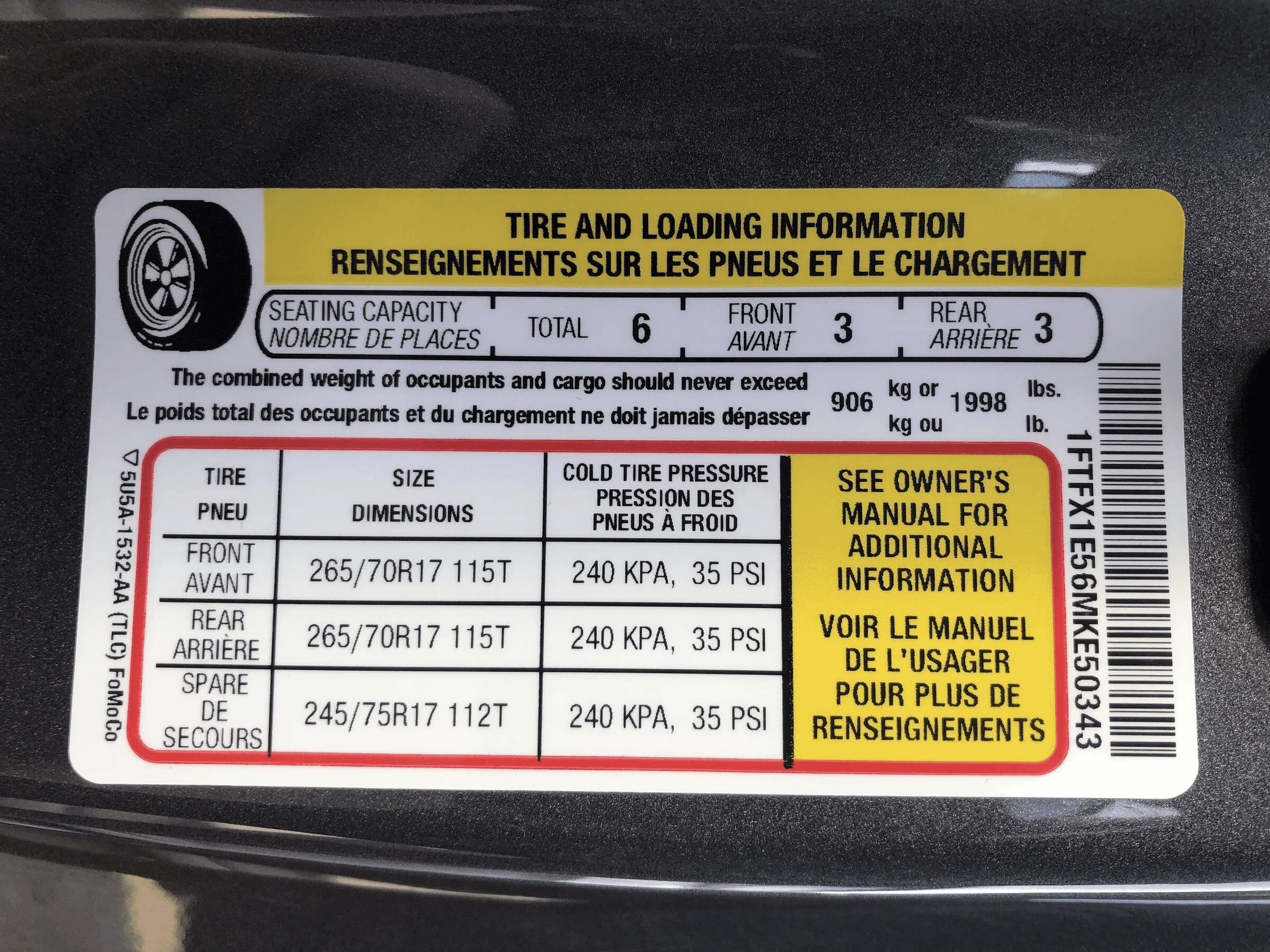

Just for reference, here's the label for my '21 Super Cab, 8' bed, 301A, with HDPP, Max Tow, and 7,850 GVWR. I pull a 6,000 lb travel trailer a couple thousand miles a year, and a 14k gross dump trailer with my skid steer onboard (11k total) for short local distances. The EB does a good job with the travel trailer, and it's not bad with the dump and skid steer, though I wouldn't be taking it on long trips. I'm coming from 30 years of 3/4 ton diesel trucks.
I noticed that you can't get the HDPP with anything but XL (maybe 300A too) regular cab now.
Ford F-150 Payload Package - Unicorn? tempImage5hlBTW
