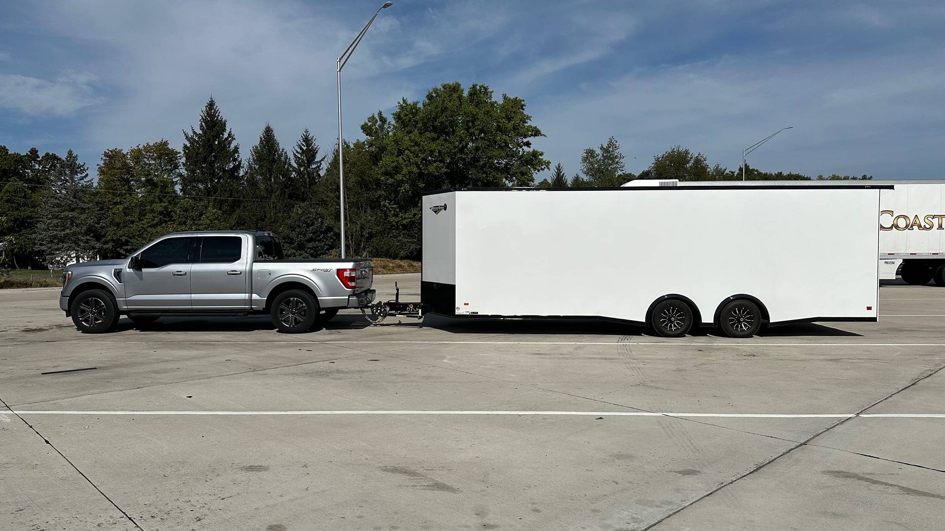

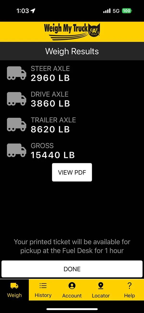

How much stuff do you put in the truck when going to car events? A nicely optioned KR power boost will probably have a fairly low payload. How did you option the trucks? Things like the twin panel sunroof really eat into the payload number.
Another thing to keep in mind is the rear GAWR. It’s 4150lbs with the max tow. I think it’s 3800# with the standard 9.75” rear.
I tow a 24’ enclosed steel trailer with my 23 Lariat 3.5 max tow. Truck is decently optioned, but no twin panel sunroof, no auto running boards, no b&o unleashed stereo, but has most other options. My payload is 1721lbs.
I tow my 2017 Mustang GT to drag race events. The car is right on 4000lbs. I load the trailer with tools, ez-up canopy, generator, coolers full of beer & food etc. Pretty heavy at ~9750lbs when fully loaded.
In the truck it’s just me, a duffle bag of clothes and some small misc items. I added to the truck a bed cover and a line-x spray in bed liner, so that eats into some of the payload. The WDH setup is close to 100lbs as well. I run the new Weigh Safe WDH setup and it’s AWESOME.
At the scales I come in 230lbs under my GVWR and 290lbs under the rear GAWR. My rear axle weight is 3860lbs, so I’m glad I have the max tow capacity there.
At the end of the day, I think you will want the extra wiggle room in the payload that the non power boost truck will give you. But again, I guess it also depends how you optioned the trucks.
