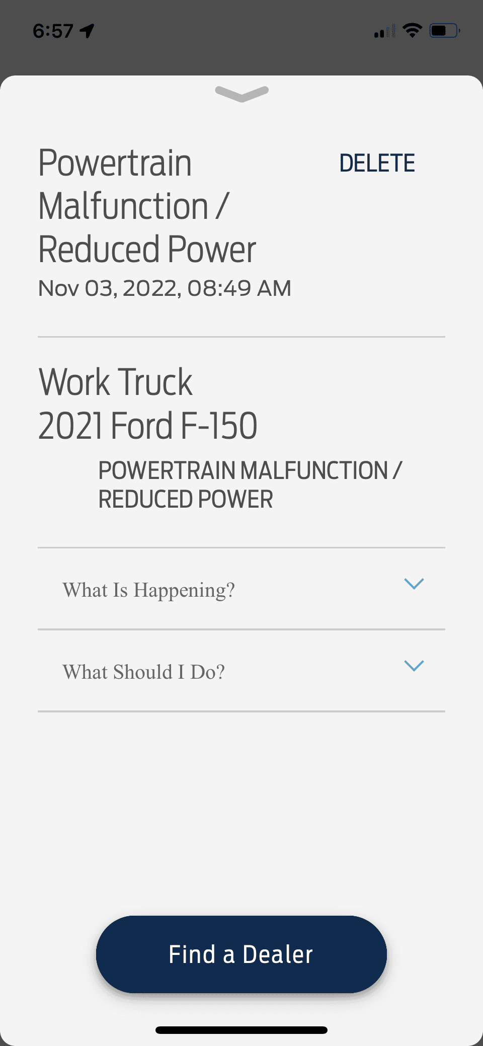

Back in May I started getting this warning during sustained freeway-speed hill climbs:
Ford F-150 P084B Transmission Fault, Slipping IMG_5165
The powertrain fault is P084B when this happens - "Transmission fluid pressure sensor/switch "H" circuit range..."
The vehicle seemed unaffected, but I took it in for service anyway. Four appointments since May. Twice they've replaced a sensor, but the fault keeps occurring.
It's recently been getting worse. Used to be just sustained hill climbs at freeway speeds, but now it almost every time I'm on the freeway. I get a notification in my FordPass app every time - I have many dozens of these messages and haven't deleted them.
Over the past few weeks this is now happening on sustained hill climbs:
Notice the transmission is not shifting. I'm not pulling or hauling anything. It feels like it's slipping/briefly losing power when the RPM's surge. This occurs in modes Normal, Eco, and Slippery, but never yet in Tow/Haul when I'm actually pulling a trailer.
I have a fifth service appointment with an "advanced" tech next Tuesday (every time I call in to say it's not fixed, the next appointment is at least a month out). Fingers crossed it's not a part that's out of stock forever!
Any thoughts from the ever-wise forum collective??

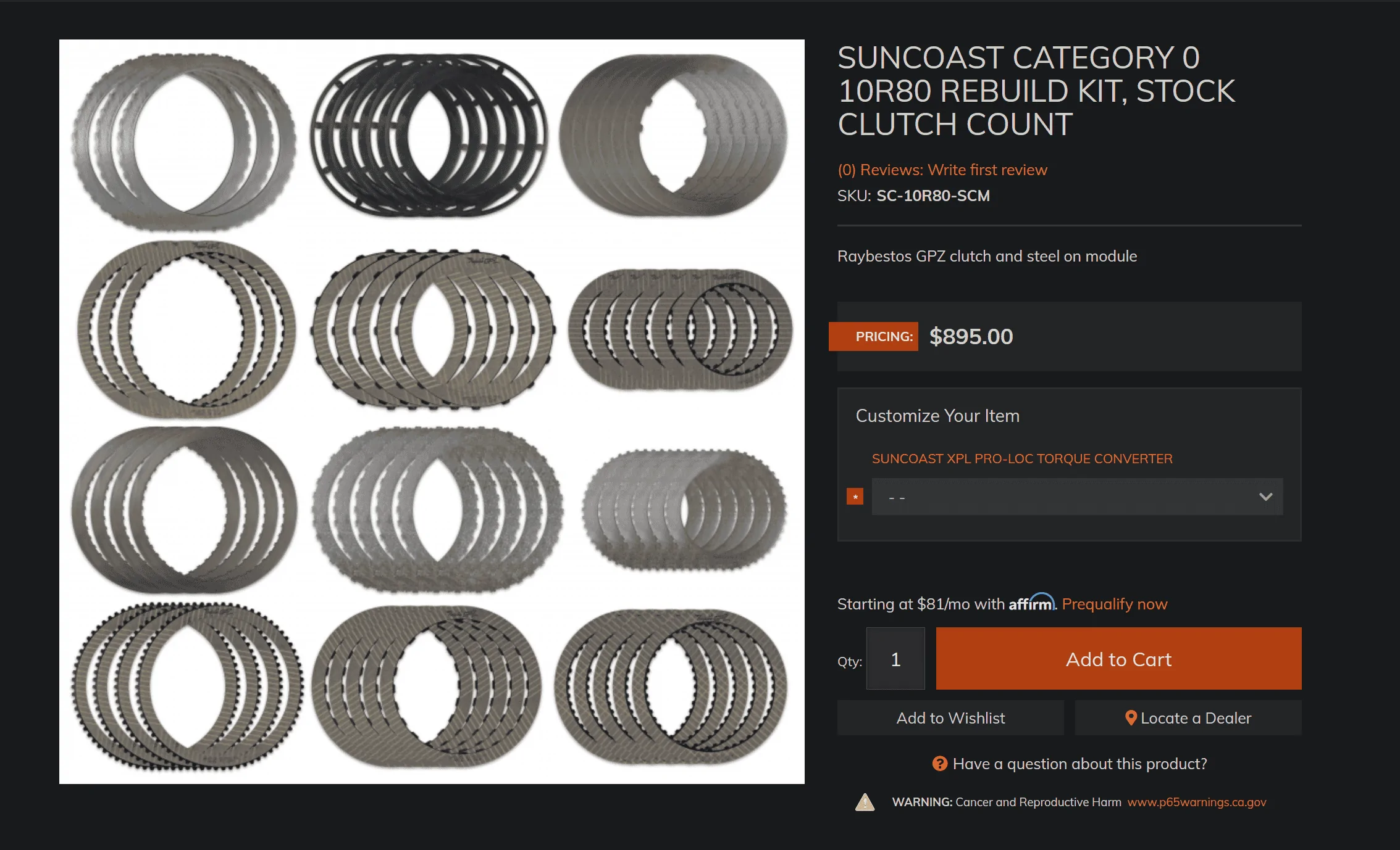

Hard to say what is slipping from here to be sure
But if it's any of these:
Ford F-150 P084B Transmission Fault, Slipping 1668087616213
It won't take long to need new ones.
