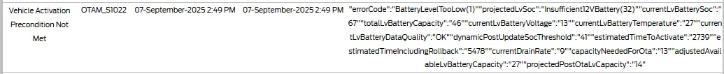

Got your message, and it's the usual suspect.....the battery is too low. Both SoC and capacity are below spec.

Thanks for checking. Time for me to get a new battery then.

After 1300 days on the original main battery I replaced it.
Now the update still will not install :(. Obdlink says the battery SOC is at 100% but it still fails. I'll keep trying but it's annoying.
Edit:
Well scratch that it succeded in updating as I was posting this :)
