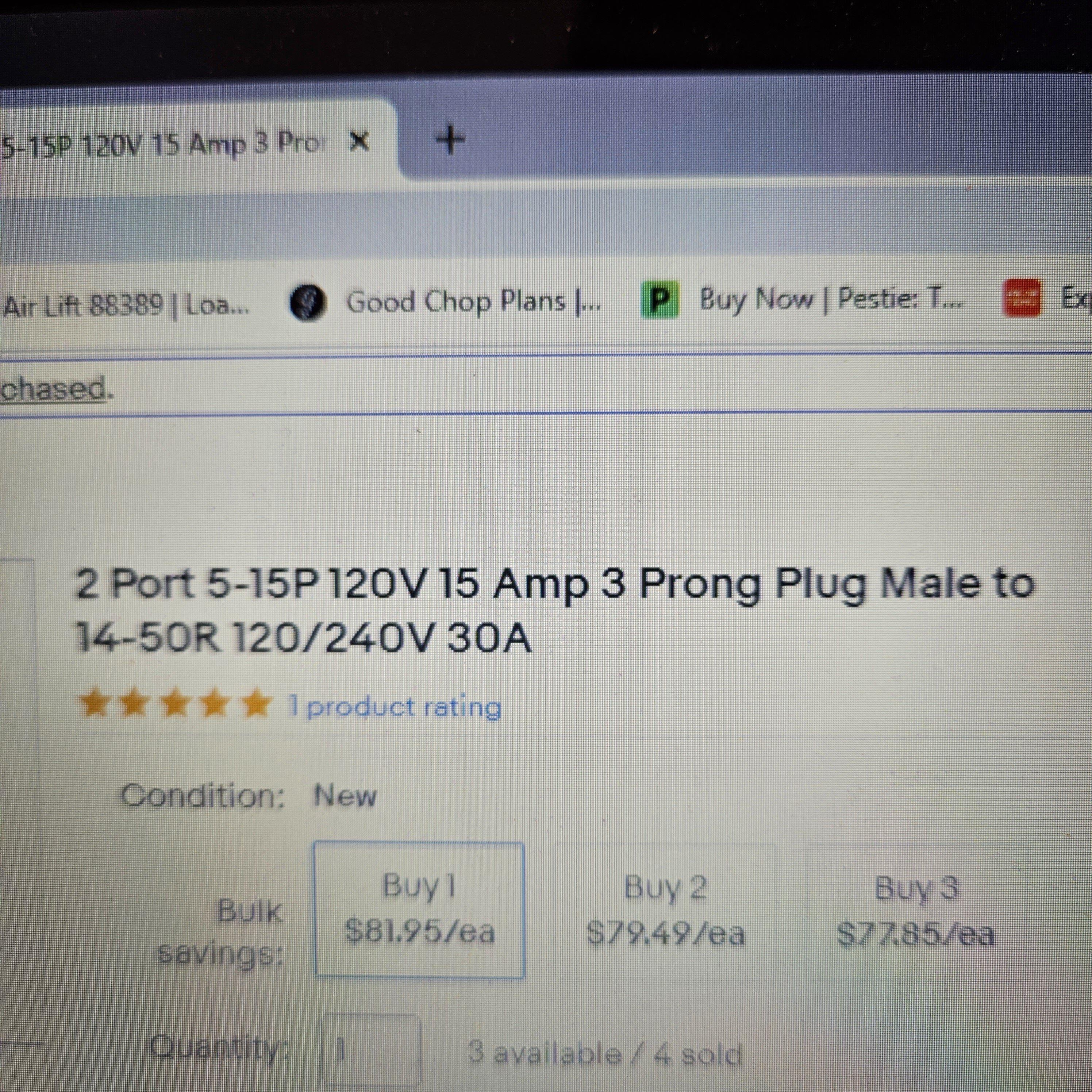

I have 2021 XLT 4WD SPORT OFFROAD Powerboost with only one outlet 2.7KW generator. 3.73 Locking rear, I Added AirLift air bags, 1619 payload capacity, 360 BLIS cams, spray in liner. Average around town 25-28mpg. highway not load 25-30mpg. Have not towed the TT yet on the highway. Class 5 Hitch wt capacity is 1160 LB, towing cap 11,000 LB, Trailer is a 2020 Coachman Apex RLDS 293 6500 empty, 7600 loaded, 2 AC units, 50 amp service(will run on 30 amp), very large tanks for boondocking. Hoping the 50 amp adapter will run one AC and the rest of the trailer when needed.
Ford F-150 Ontario to Mrytle beach 1500km (~900 miles) towing 7000lb trailer with 2022 F-150 3.5 EcoBoost Max Tow 20230515_163142
Ford F-150 Ontario to Mrytle beach 1500km (~900 miles) towing 7000lb trailer with 2022 F-150 3.5 EcoBoost Max Tow 20230515_163148
