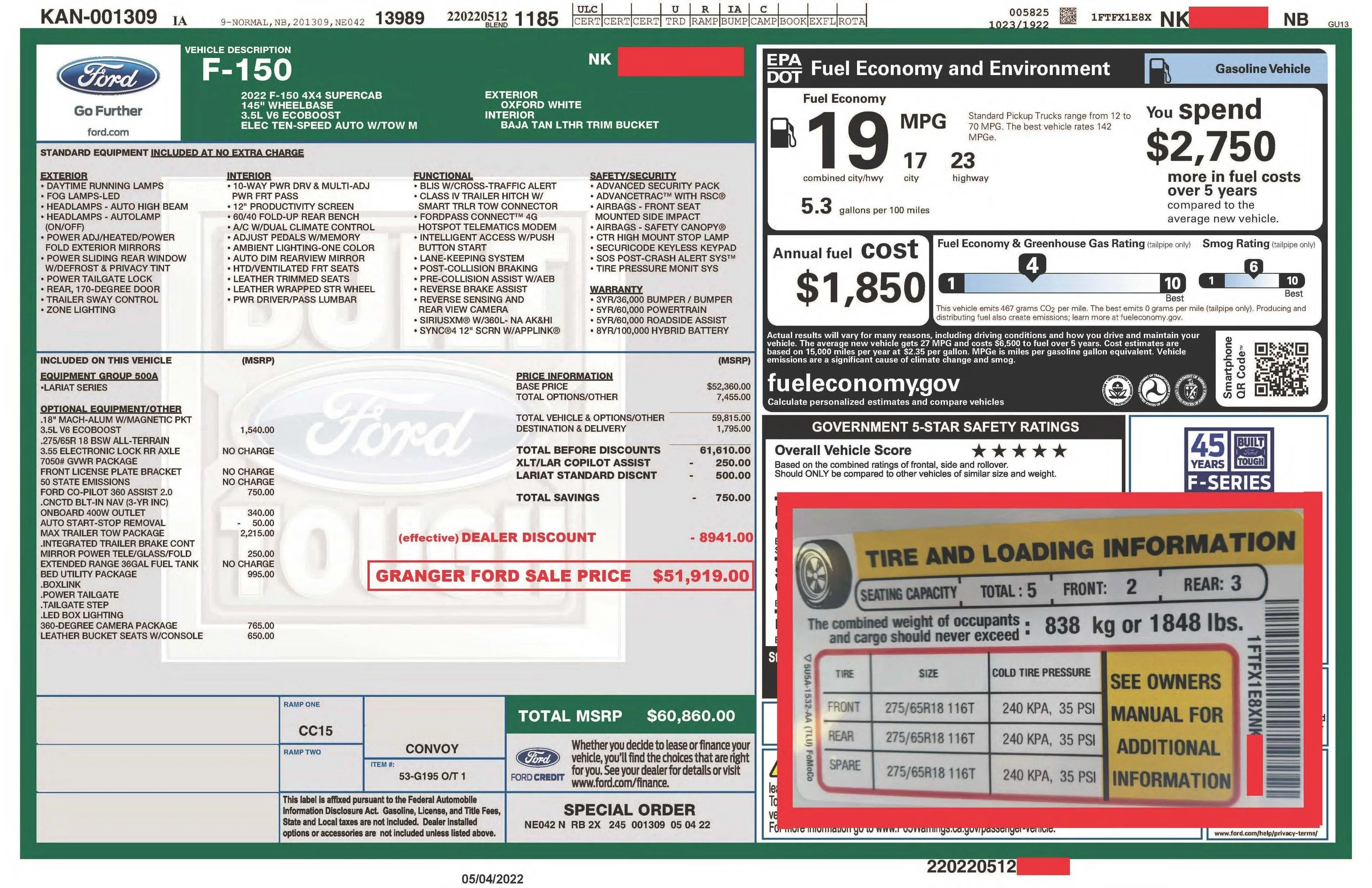

Carefully selective options restraint is the key to payload IMO, and that doesn't mean sacrificing things to 'bare bones' by any means. My 2022 Lariat 4x4 is very nicely equipped with conveniences while also delivering generous payload / towing capabilities .....
Ford F-150 Ontario to Mrytle beach 1500km (~900 miles) towing 7000lb trailer with 2022 F-150 3.5 EcoBoost Max Tow F150 Window Sticker with Payload
