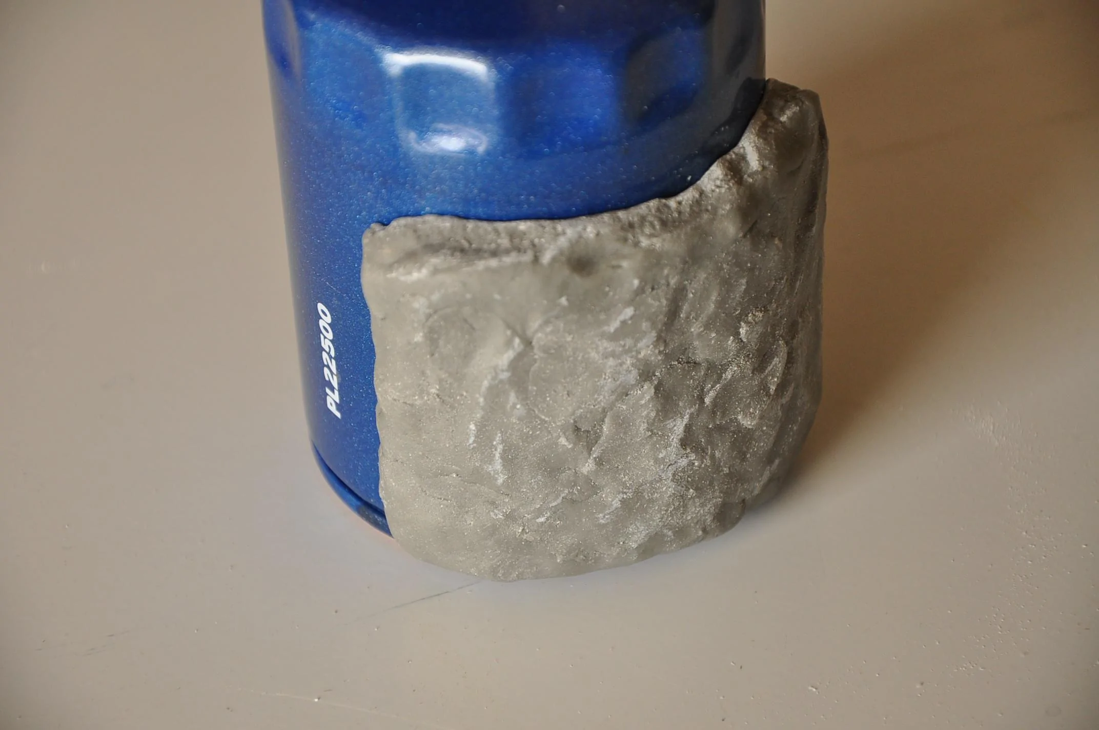

Here is my Frankenstein Filter Mag. It actually came out great! $20 for magnets but I only used 8 of the 12, and $7 for the High Heat JB Epoxy. So in the end about $20-$22 worth of materials, not including the filter I used for the curvature.
The extra mags I may just use "free form" on the filter and see how that does.

Good job! Looks like a scientific marvel. Lol
If you don't service your own vehicle, make sure you have them take that off and give to you.

HA! Thank for giving me the idea currybob. That JB High Heat Epoxy is like a rock now that it has cured.
If the oil filter set up on the 3.5 PB was engineered a little more "owner friendly" I would probably do it myself. However, it does not look like it is the easiest. Couple this with father time marching on for me and I will probably have it done. I'll check it out when I get the truck.
I actually have a nice new Valvoline Change facility right down the road from me and I have been impressed with them. They have a full synthetic too, so I will probably just go there and pay them.

Just to touch on this. I compared the Franken Magnet (FM) to just using the individual mags and there is no comparison. The collective force of the FM was rock solid while the individual mags just did not offer enough adhesion to give me any confidence that they would stay put. Even with multiple individual mags snapped side by side, it just did not adhere like the mags held together with the JB Weld epoxy.

True that and you will find it is almost impossible to pull FM straight off, you have to slide it off because the magnet strength is so high.

I used the 5mm ones. Originally I used 8 mags because I wanted a few left over to see if just the plain mags would work. Also with more mags it starts to get a little long and I feared that extra length might weaken it a little. 8 seamed a little more compact and I thought that would give it some more strength.
After my initial Franken Magnet (FM) build I would do it a little differently next time. Here is what I learned so far but I have not tested this on a drivable F-150 as I am still waiting for mine. I also used non stick foil to wrap around the filter while I molded this.
The JB Weld High Heat epoxy is rock solid when it is cured. This thing is like a brick. I would probably go up to 10 mags next time but not more if I only planned to use 1 full epoxy pack. More than 10 and I feel it might be spreading the single tube of epoxy a little thin and thus lose some of that solidness. 2 ten mag FM's would give you almost full coverage anyway.
Single mags just do not give the stability of the FM and I could see them falling off. The collective force of the FM and the curvature of the solid entire piece, snaps down on the filter and you have to physically force it (slide it) up to remove it.
That Fumoto valve is something I want to use if I do decide to change the oil myself, that would remove any drain plug magnet option, if there even is that option for the F-150. After 4 or 5 oil changes this FM will probably have diminishing value but anything to catch fine metal fragments, in addition to what the filter catches, early in the engines life is money well spent if you plan on keeping the truck. For about $20 - $25 bucks a FM, that is nothing in the grand scheme of things.
