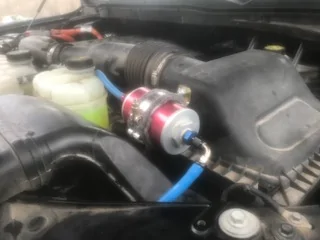

The Bypass filter is not in series with the main oil flow and the pump puts out plenty of flow so the engine sees no reduction in flow. There needs to be an orifice to restrict flow, this is really more for the filter as in order to be a fine filter it needs lower flow. Recall that as a positive displacement pump, its output varies with engine rpm (eg double the rpm, double the oil output). So the pressure at the setpoint is controlled by the spring loaded dump valve. As you go up in rpm the output of the pump goes way up, but that dump valve flows whatever it needs to keep pressure at design.

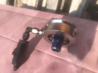

"Don't forget to use Hi Temp thread sealant on the 1/8" NPT threads."
Also, if you put in the -04AN Orifice fitting mentioned, or one similar to it, Use thread locker when you thread the orifice into the fitting proper.

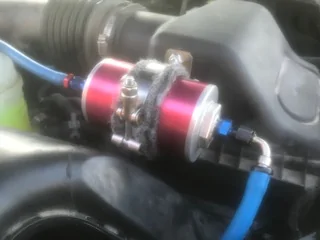

I think this also answers one of my main questions: will a finer, therefore higher resistance, filter just decrease oil flow and therefore have a net negative effect? It sounds like the pump has the ability to put out far more flow/pressure than the lubrication system needs even at redline, such that a higher resistance filter would simply result in less use of the bypass valve. Is that correct?
The way a positive dispalcement pump works is it puts out flow proportional to rpm. It will develop whatever pressure is needed to generate that flow. In other words it'll either break something if flow is blocked or stall the engine... :) So in this case the flow going to the bypass filter is in addition to the main lubrication flow, the pressure regulating valve will pass a little less oil, and both flows are sufficient to operate the engine properly.
