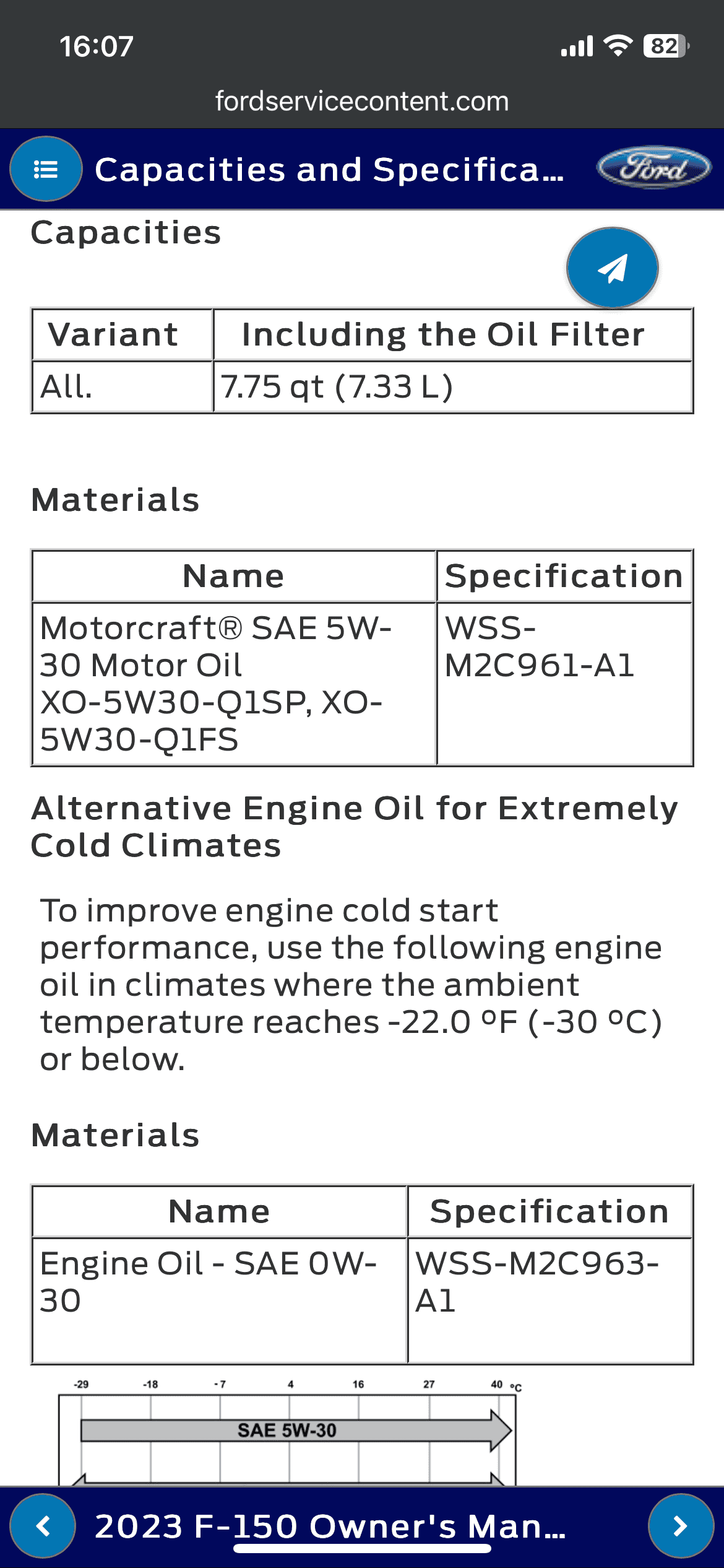

Just found this thread after receiving my f 150 Lariat 5.0L coyote in January 2024. After many searches, I come up to the same conclusion as you did. Planing to keep my new truck for 15 years. Pennzoil Ultra Platinum 5W30 full synthetic (8.8 qt./8.3L.) + Purolator Boss oil filter PBL22500. Planning to do oil changes every 5k miles/8k km.

This engine does not hold 8.8 quarts. It’s 7.75 quarts.
