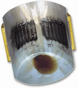

I like to put these on my filter on a bran new engines. Filtermag makes the best and have had one in the past on my motorcycle but they have just gotten to expensive for what they are. I have cut the filter up when changing to see what it was holding and it's impressive.
Ford F-150 Oil Filter Magnet 1611774166762
I ordered the magnets from Amazon for $13 and had some JB weld to make the individual magnets keep their shape the same as the oil filter.
Worked perfect and these together are very strong. So strong you have to slid it up to get it off the filter, too strong to pull it off straight out.
This is to trap all furious metals in your oil filter and keep it out of the engine oil. Breaking in a new motor can cause very very tiny pieces of metal to get in the engine oil. There is some good research out there. It's most likely over kill but hey, that's me. Lol Not like it cost a lot.
Just throwing it out there for anyone interested.

I have done my own, like I said, by cutting up the filter after use and saw enough to convince me.

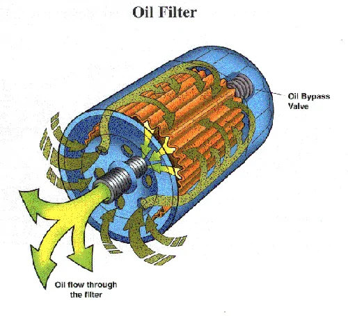

Oil flows into the smaller outer holes and out the large center hole, after passing through the filter media to trap particles. The magnets will only hold the ferrous material against the outer metal wall of the filter. So the oil flow goes by the magnetic before the filter media.
Would the media have trapped the ferrous material, yes, to the size the media can, the magnetic will attract all sizes where smaller sizes are actually easier.
