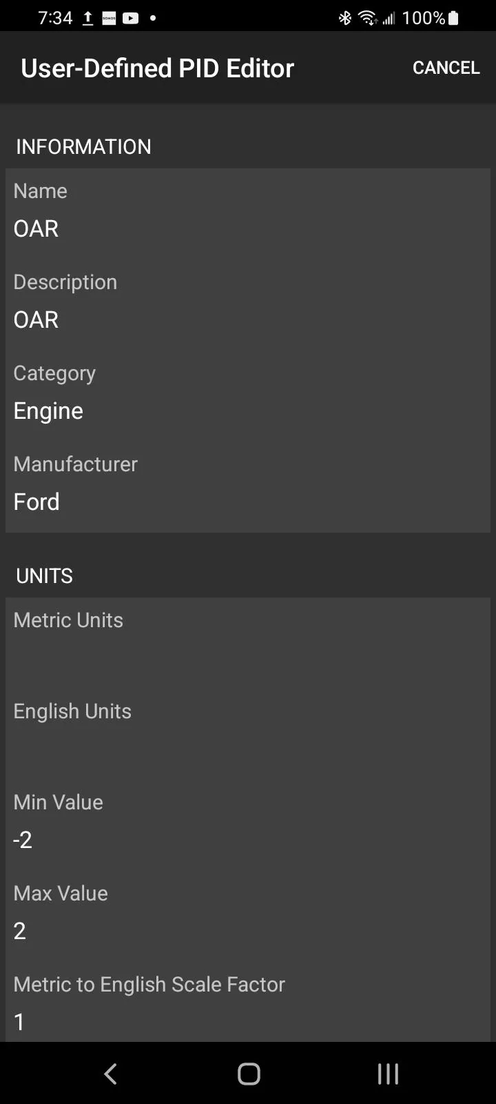

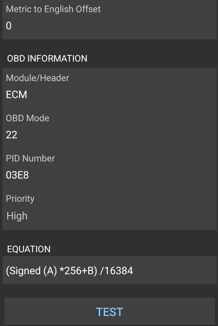

The app that is provided with the MX+ (OBDLink) has the PIDs you are asking for. Of course you have to add the Ford/Lincoln/Mercury in-app package to the app.
It will not have OAR, but I can provide you the formula for that and you can build a "user defined" Pid.

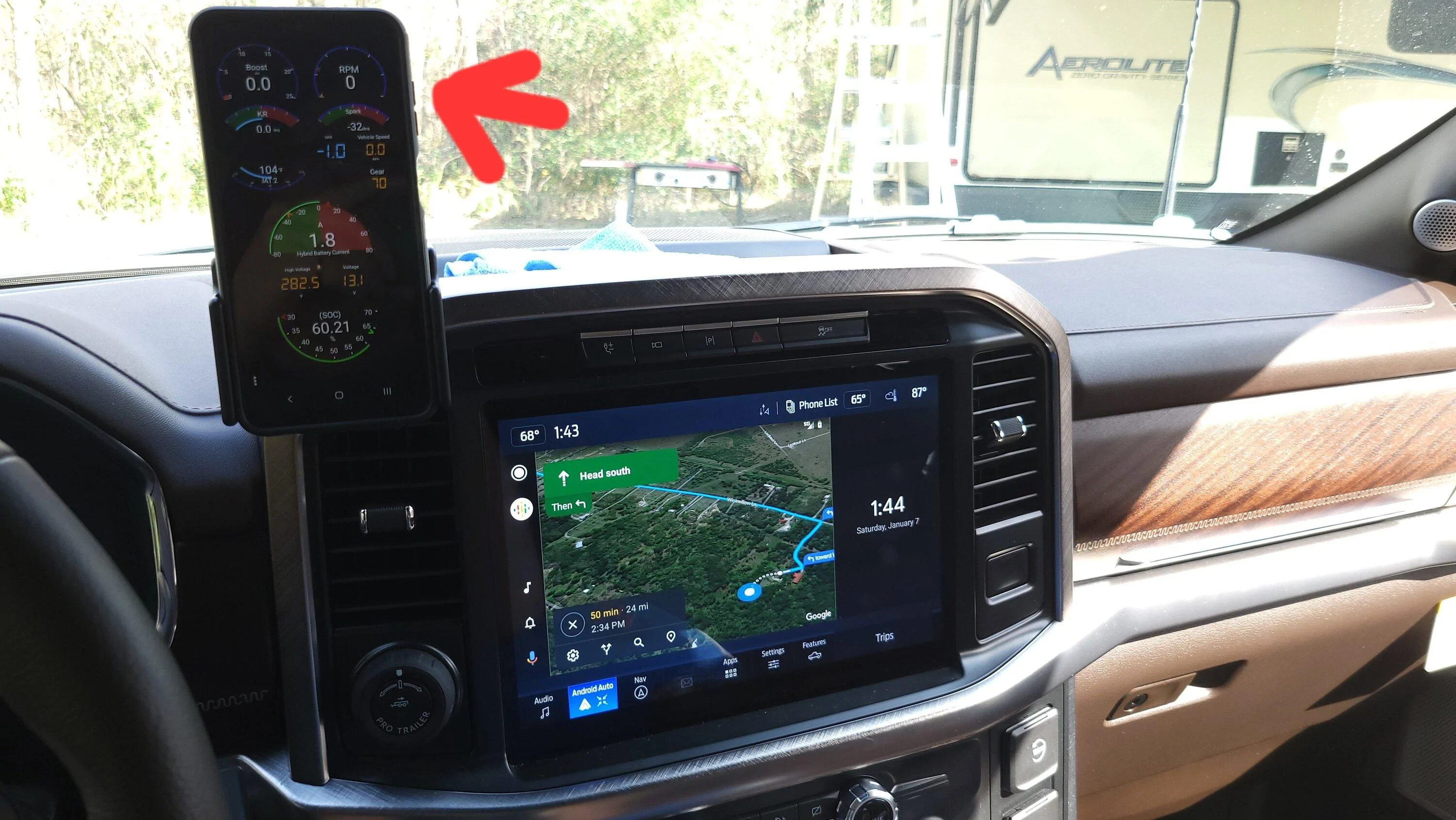

I kind of want to find a small tablet and a mounting location that looks clean, and maybe use that as an all the time monitor. Something that’s just always ready instead of using the phone.
Dedicated phone (no Sim) but can use the vehicle Hotspot for streaming and such. Even Android Auto.
Proclip holder
Bluecruise infrared not blocked
I messed around with a lot of options and I'm finally done.

I have 3 extra old phones. Lol. Use the vehicle hot spot, run android auto or car play, and keep this up as the dashboard. Excellent idea. Can you connect the extra phone to the hotspot of the vehicle, but still have the regular phone connected for everything else, for phone calls etc?
With the latest APIM update and Sync at version 22293, the truck now manages 2 phones with excellence!
Sync has come SO far, and it's now worthy of some praise, in my opinion.
I've been along for the whole Sync ride with Ford. It's been a long ride, but I will give them kudos.
