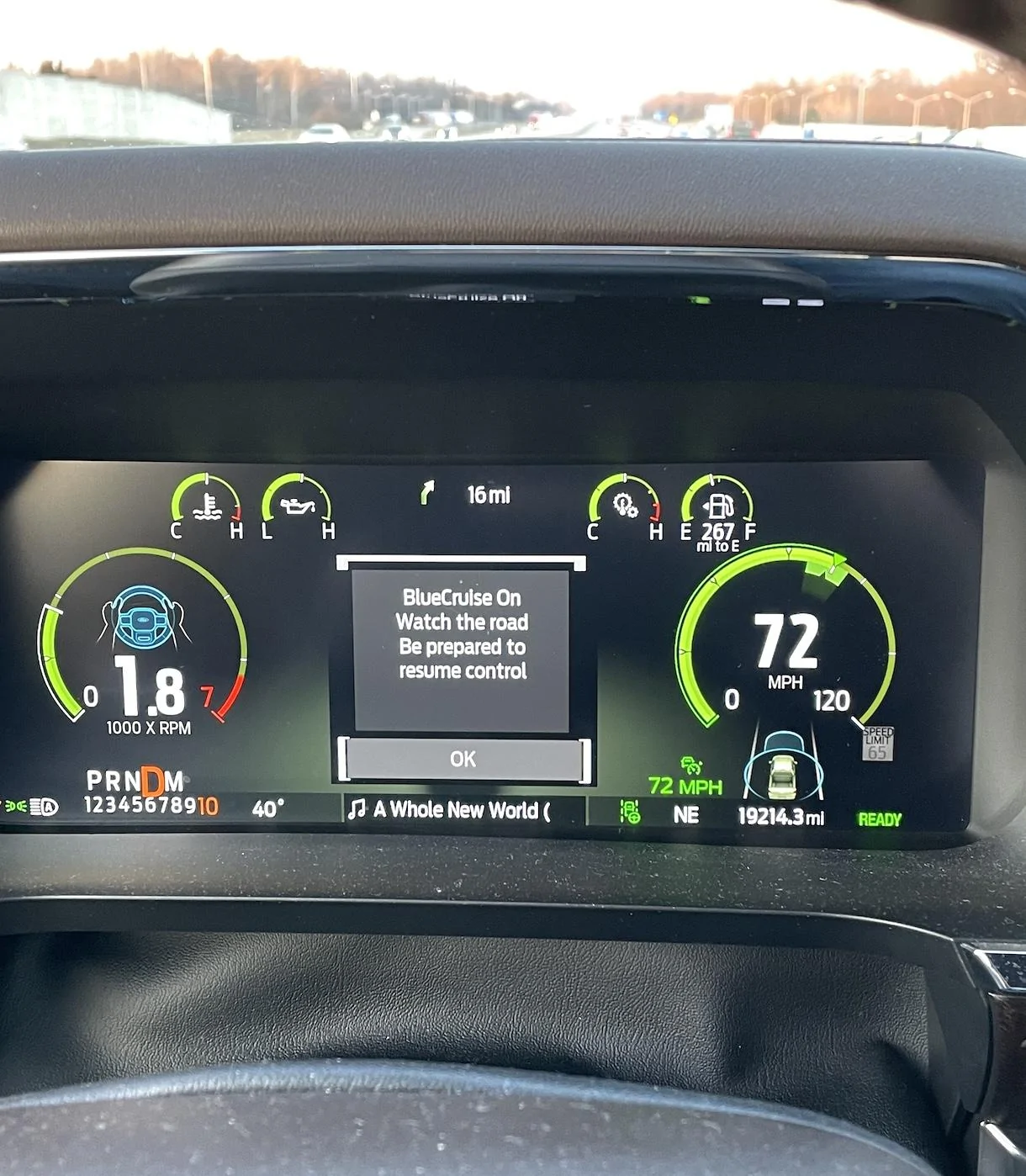

Some good news, I posted my VIN, got word that the 2.8.1 OTA update was in my queue. Sure enough got a notification 30 minutes later and triggered it to update overnight. Ths update was indeed different as it said that it would take up to 145 minutes, which no update before has mentioned. The update was a success according to my truck and Ford Pass.
The update notes mentioned nothing about BlueCruise though. Only that Pro Trailer Backup Assist received some refinements and that future updates would work better. I took it out on I-75 in Ohio, a BlueCruise approved highway, kicked on Lane Centering and Cruise Control, and for the first time in 18 months, I actually see the words "BlueCruise On". ?
Ford F-150 No Blue Cruise and OTA Updates Work Fine BlueCruis
The party ended quickly though because despite it showing this pop-up message that BlueCruise was enabled, the dashboard never goes into BlueCruise mode and behaves exactly like Adaptive Cruise Control. That is, you must still "Keep Hands on Steering Wheel."
Ford F-150 No Blue Cruise and OTA Updates Work Fine CruiseControl
Even though I have that interesting notification about BlueCruise, it's not functional. Weirdly though, it is now also popping up notifications about "Keep your eyes on the road" which are new to me and I'm assuming a part of BlueCruise from what I've seen on YouTube.
So the update was a success but BlueCruise is non-functional, broken, or something. I think I saw another thread on here with a similar behavior.

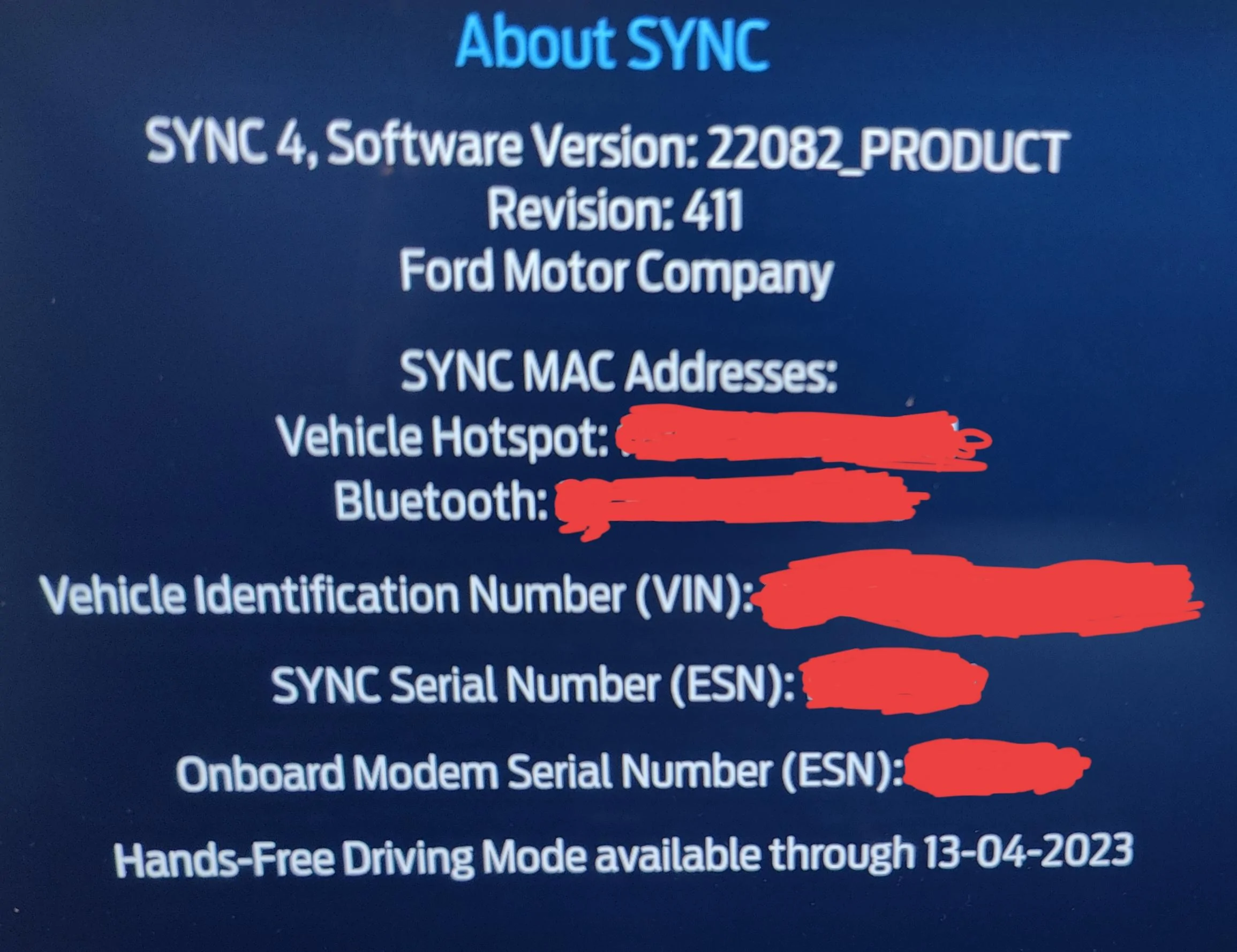

This is also how it would behave if the maps aren't current, I'd check and see if the date is 13-04-2023.

Bummer, I was hoping it was that simple. As moe said, I'd check the sync information and see what it says for blue cruise enabled date, or map date. It's something like that. Mine didn't work the day I drove it off the dealer lot until it got an Ota. My maps are now good until April.

Sorry, I'm not near my truck to get a picture. It is in settings somewhere it's like sync info or sync version, it's where you see what it's you are on, at the bottom of that page of text there is the blue cruise maps. If it's a date in the past, then that's your issue and you need an Ota.

I'm going from memory, but in the "Settings" Tab there is a "About SYNC" selection where it will pull up the following information (picture copied from another post) -
Ford F-150 No Blue Cruise and OTA Updates Work Fine 1673197397604
The date for "Hands-Free Driving Mode available through XX-XX-XXXX" is what many people have been having issues with lately; mine was stuck on 10-12-2022 until Friday.

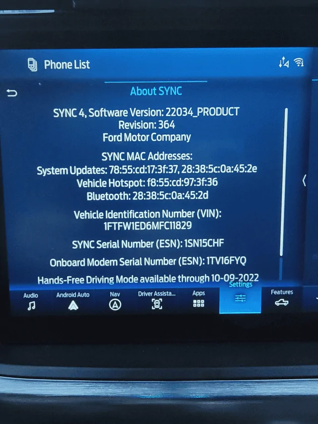

So that's the Settings → General → About Sync info. And mine looks just like that but there is no line "Hands Free Driving Mode" whatsoever. So maybe it's not activated or something?

First I've heard of "checking the maps." How do I do this!?
That update is still shot of the last few of updates needed. That was a package update of the IPMA, CCM, PSCM and CMR
You will ahve one that is the Gateway next. It will enable bluecruise as of now you do not have the maps active and the config is not active for BC

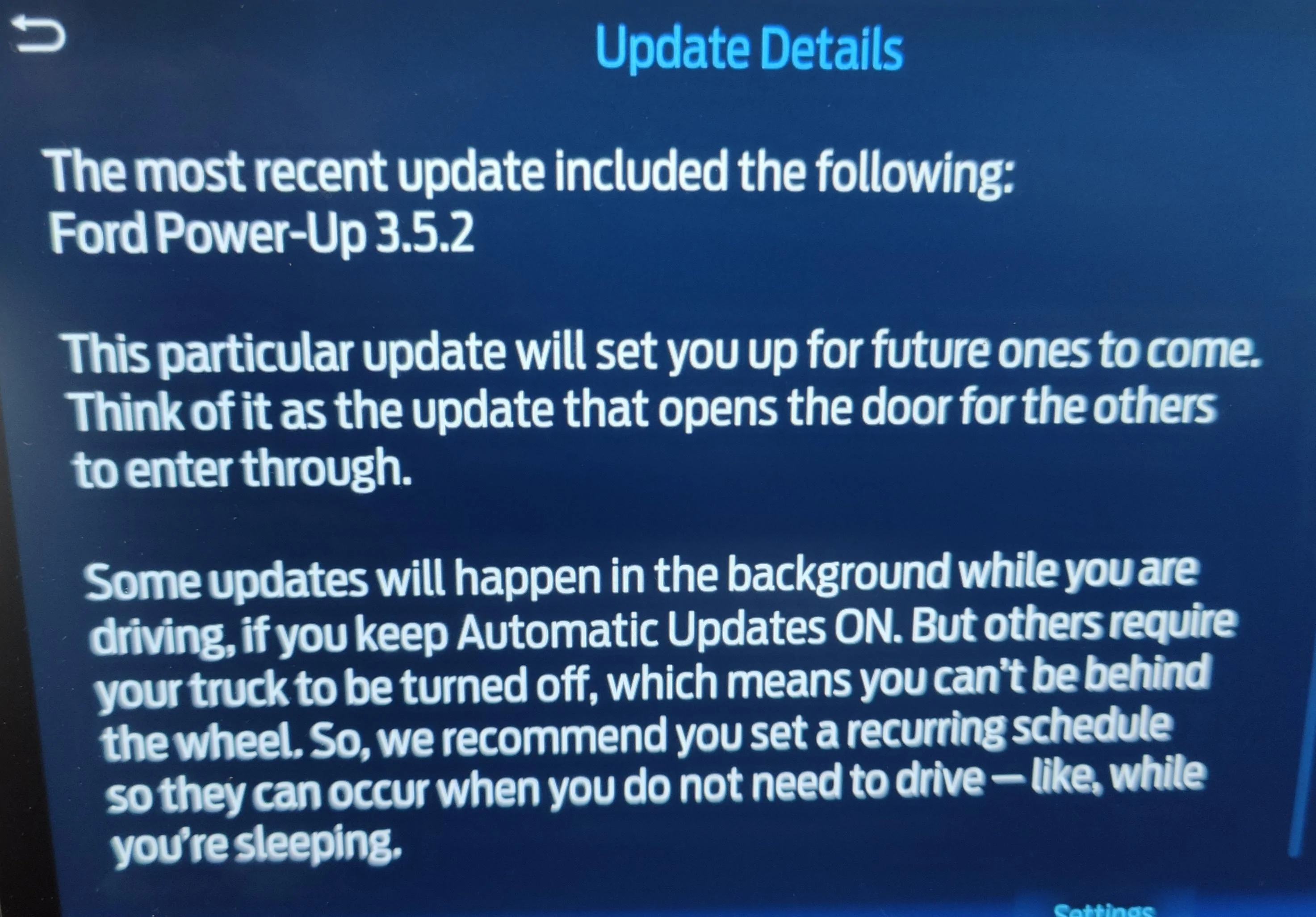

I've never understood the whole "Ford Co-Pilot360 ACTV2.0 Prep" . I don't know what else is needed to get Blue Cruise working, but also I think you are significantly behind on OTA's. As long as it's sync 4, I believe the OTA's should be the same between trims? I could be wrong, Mines a Tremor, not a PowerBoost.
I just got home, here is mine. I'm on 3.5.2 and you are on 2.7.4
Ford F-150 No Blue Cruise and OTA Updates Work Fine IMG_20230108_112756
Ford F-150 No Blue Cruise and OTA Updates Work Fine IMG_20230108_112828
