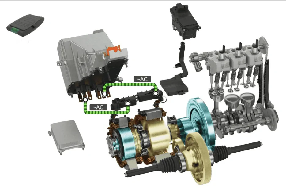

@amschind https://www.schaeffler.com/en/media...gital-conference-book-2022/hybrid-powertrain/
Scroll down to where this starts... I think you'll find this approach intriguing, ICE, e-motor and generator all in one. No gears, all done with electric motors, and will clutch in ICE direct-drive. Crazy stuff and it's being built. Not for a truck
Ford F-150 NHTSA Safety Recall (23V-896) on 113,000 F-150 Trucks with Trailer Tow Max Duty Package 1714641789126-as
Seems complex, yet simple
Ford F-150 NHTSA Safety Recall (23V-896) on 113,000 F-150 Trucks with Trailer Tow Max Duty Package 1714642009955-2k
Ice / trans / final drive all in one (ICE is OEM's choice) -- those are the half shafts at bottom of image.
Ford F-150 NHTSA Safety Recall (23V-896) on 113,000 F-150 Trucks with Trailer Tow Max Duty Package 1714642436913-8s

The simple "remove two energy conversion stages for the price of a clutch" argument is compelling, but what about engine RPM vs wheel RPM? The benefit of a series hybrid that offsets its extra energy conversion step is its ability to keep a heavily optimized engine in a narrow powerband. IF the ICE is great between 2k-2500 RPM, and there is no transmission, then you have to select a gear for a fairly narrow range of vehicle speeds where the clutch can work.
