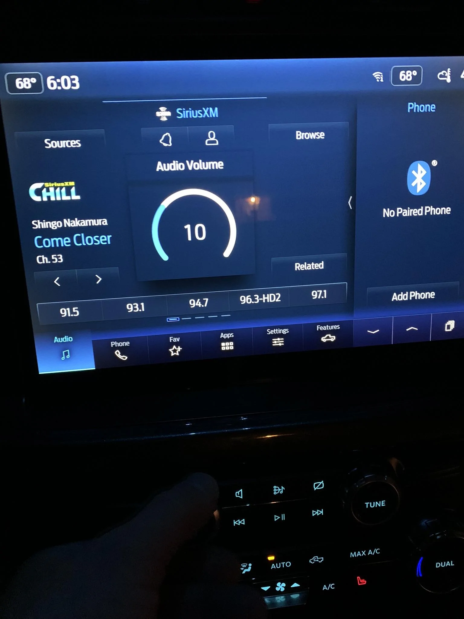

I restored the as-built APIM and ACM configuration back to the original, and reset both modules.
I then went in and changed the 7D0-01-01 first digit from 8 to A and the 727-01-01 first digit from B to 3. I reset both modules and, voila, my volume control display started working again. Thank you for your suggestion to revert back to original config and try again.
The first hextet in my 7D0-01-01 register is A081 and the first hextet in my 727-01-01 register is 30FF.
(not sure if they are hextets, but they sure look like a 12bit Ethernet hexidecimal MAC address)

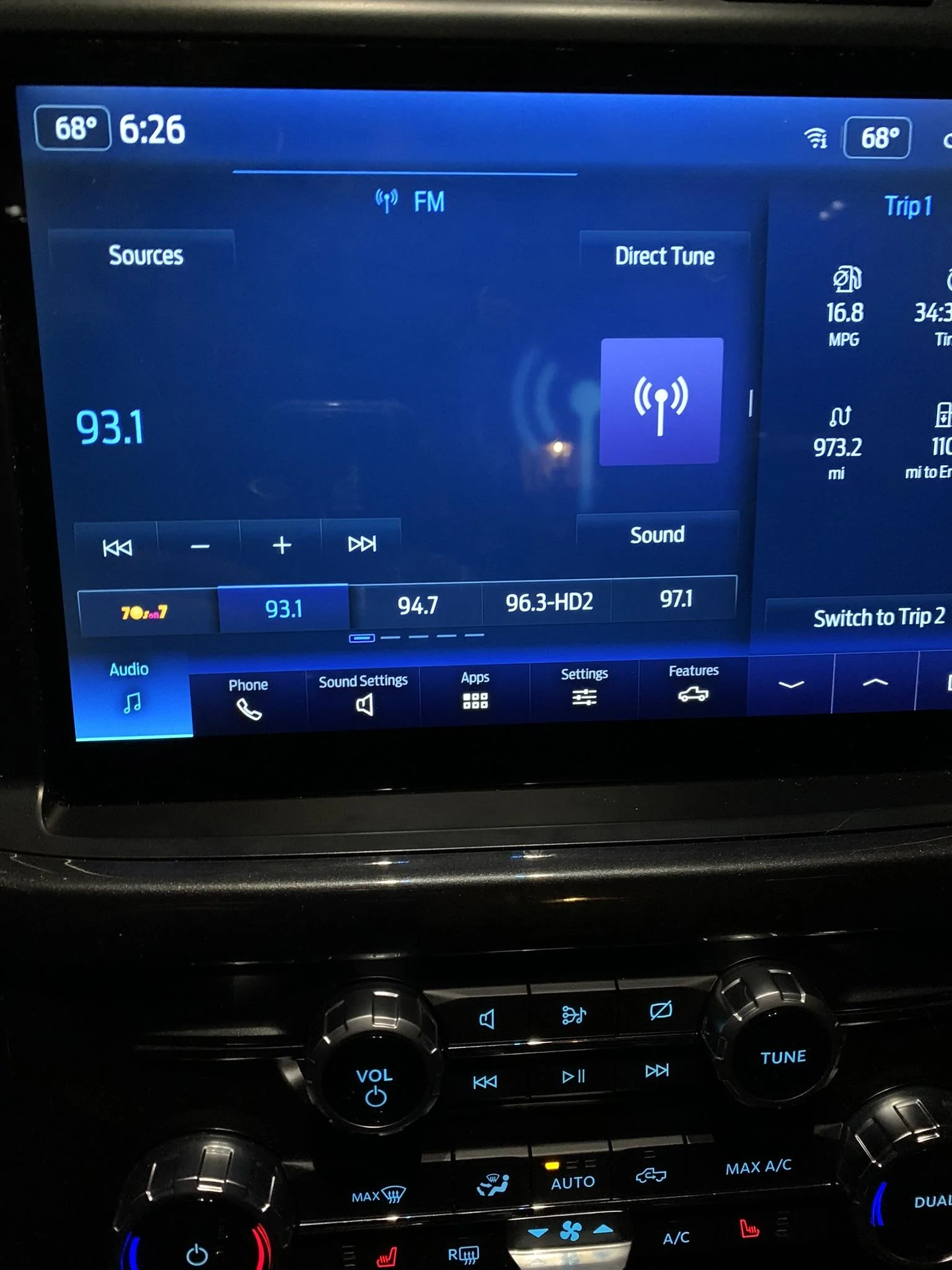

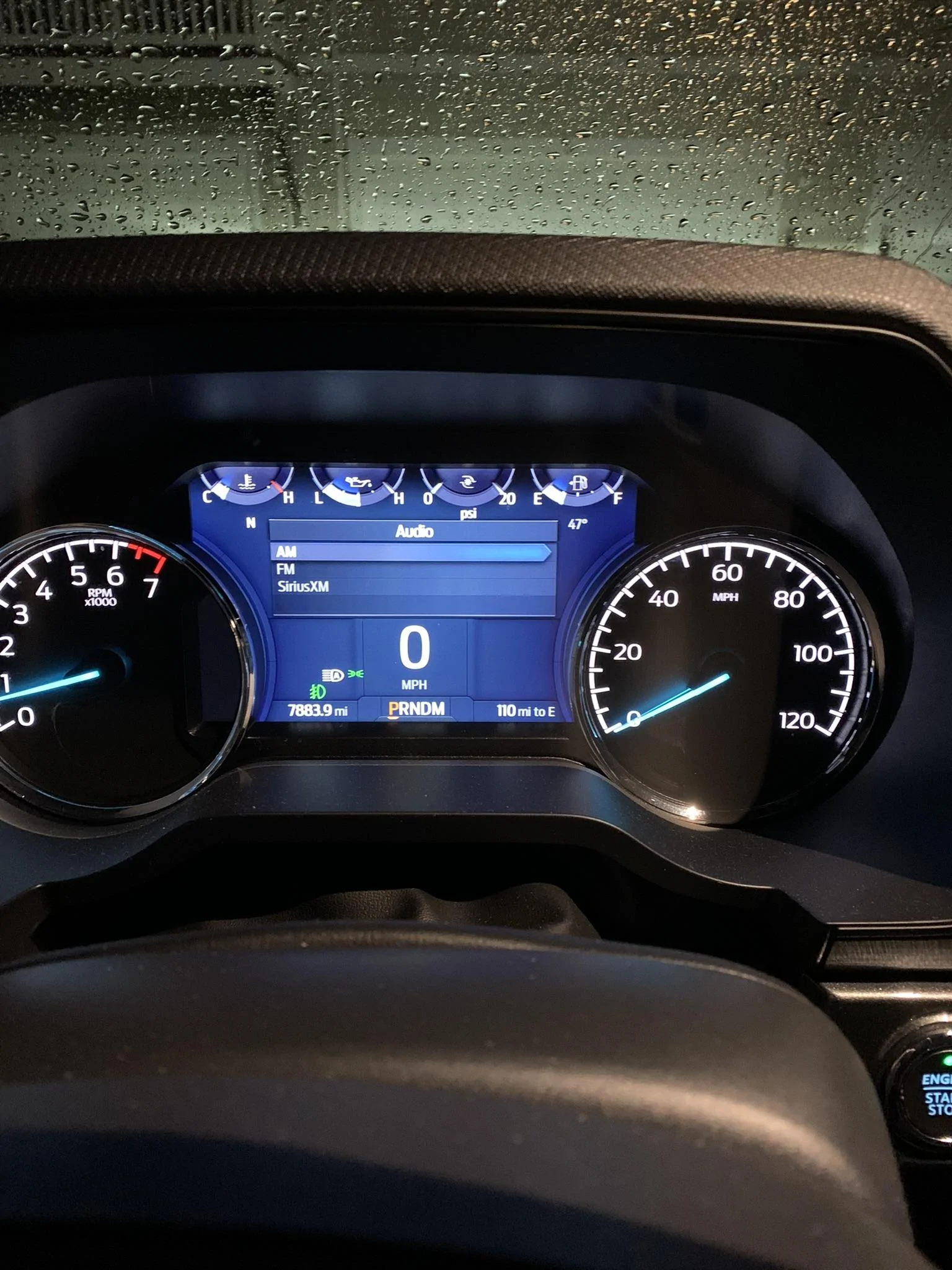

Now the problem I have is with the "now playing" in the My View on my driver's side dashboard. When I'm in SiriusXM the display shows as "Audio Off" or the last AM/FM channel (see attached photos, look at them in sequence). I'm wondering if I need to change the second digit of the 7D0-01-01 to something else? I noticed there's a tuner type (TT) of Dual Tuner.
Right now my second digit of 7D0-01-01 is | 0 - FSM Fader in Sound Menu * TT Single Tuner * TMC Not Available (Disable TMC Menu) * DAB Not Available|
Just out of curiosity, what is your second digit? Also, what's TMC and DAB do i need to enable these as well?
