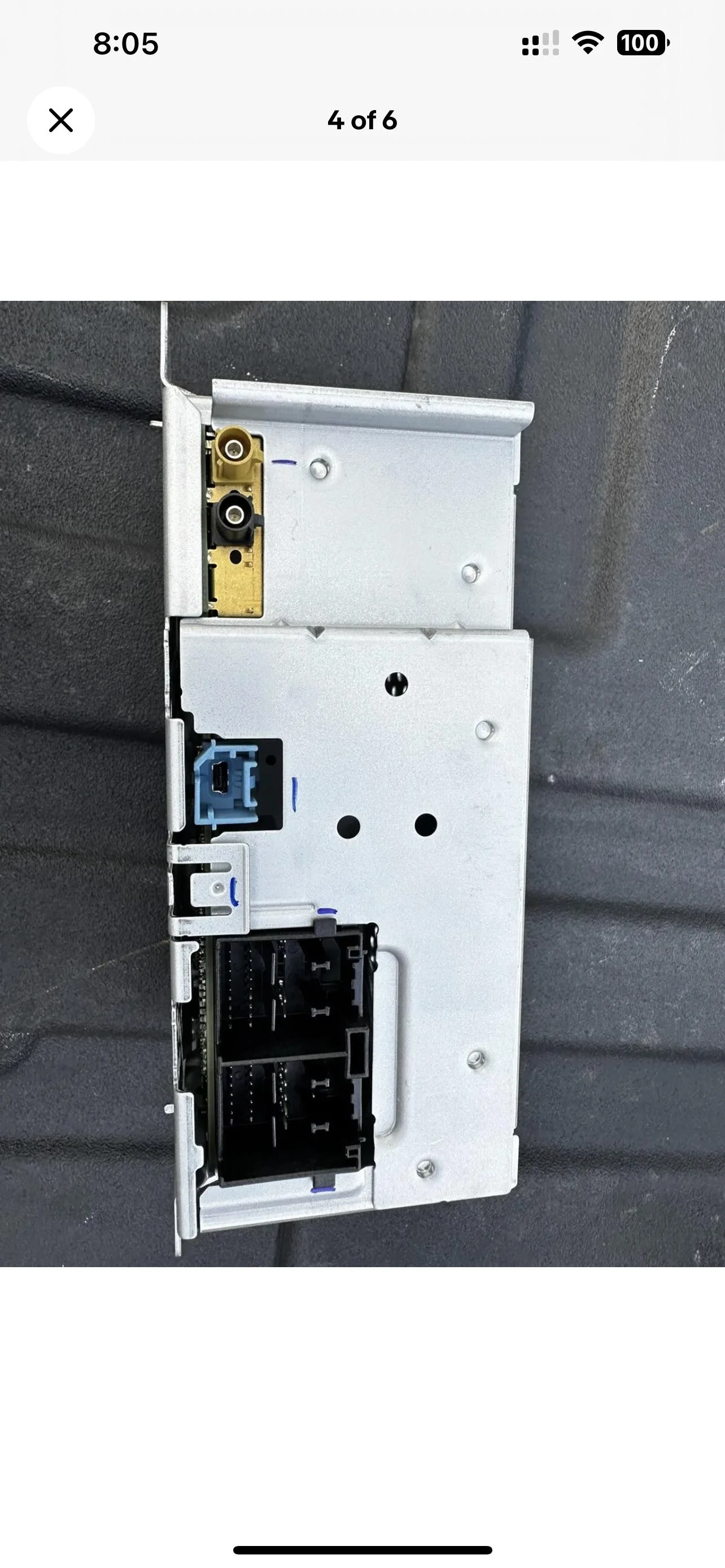

Yes attached here
new unit.

So right now I swapped the receiver module for the one in the post above. Which has XM, not the APIM, APIM IS below the radio correct?
right now I have no Audio and no option to get to the menu when pressing audio.
My thoght in the morning is to reset to AB on forscan and then go change modules as per a as built i found for a XLT with Sirius.
Thoughts>>> I just dont know why I have NOTHING Now.

Yes, the APIM is below the ACM. I can't comment on why you have no audio option but I believe you stated you replaced the ACM? Did your current ACM not have the XM ID number on it?
I have the basic 7 speaker...below are the changes you need to make to the APIM and the ACM. Make sure you reset each module after you make the changes in Forscan. If you have one of the B&O systems the changes will be different.

Did you save the as built file from your original radio? If not you have to swap your radio and save your as built. Then install the new one and load your saved as built to it. Then mike the 2 forscan changes.
Or manually change every line to match your as built

so I swapped the receiver - changed the as built and no audio.
Should I swap back the receiver to non Sirius unit factory then load the As built save it. Reset then install the Sirius unit ?
Im lost where to go right now and frustrated.
couldn’t I just load the as built from the internet thru forscan as built?

You can try what “pelon222” stated but make sure you back up both ABs before overwriting. On post 10 by XLT22 he did state having to run a PMI in FDRS. This is not a free software you have to pay for this and need a mongoose adapter. I’d try the AB change first just take your time.

I think I’ve figured out where you’re going wrong. You’re skipping steps and getting ahead of yourself. Do this:
If you did not save your original ACM as built, reinstall it and save that.
If you saved it before removing, use the Load All and Write All function in Forscan.
Reset the module and make the necessary changes. Reset It again and test it.
Like I said earlier, if you don’t know how to do that then please read the Forscan thread or watch a YouTube video of how to use it. The actual changes to activate satellite radio are very simple.

So I’ll keep the new Sirius acm in.
default the asbuilt, write To the truck.
then go to reset acm in the reset functions.
change values and mentioned in your first post, see if Sirius comes up?

Save the as built from your Sirius ACM
Remove it and install the original ACM
Save the as built from the original make sure you name your files accordingly
remove your original ACM again and install the Sirius ACM
load your as built from your original ACM
make the 2 changes to the apim and the ACM after you load your original as built file
APIM
7DO-01-01-2xxx-xxxx-xx
ACM
727-01-01-3xxx-xxxx-xx
