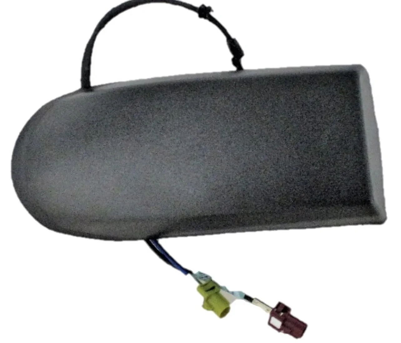

So I ordered the antenna that was mentioned in the first post, but I don’t see a blue connector on it. This is the wrong antenna to replace with?
just the curry and purple…..

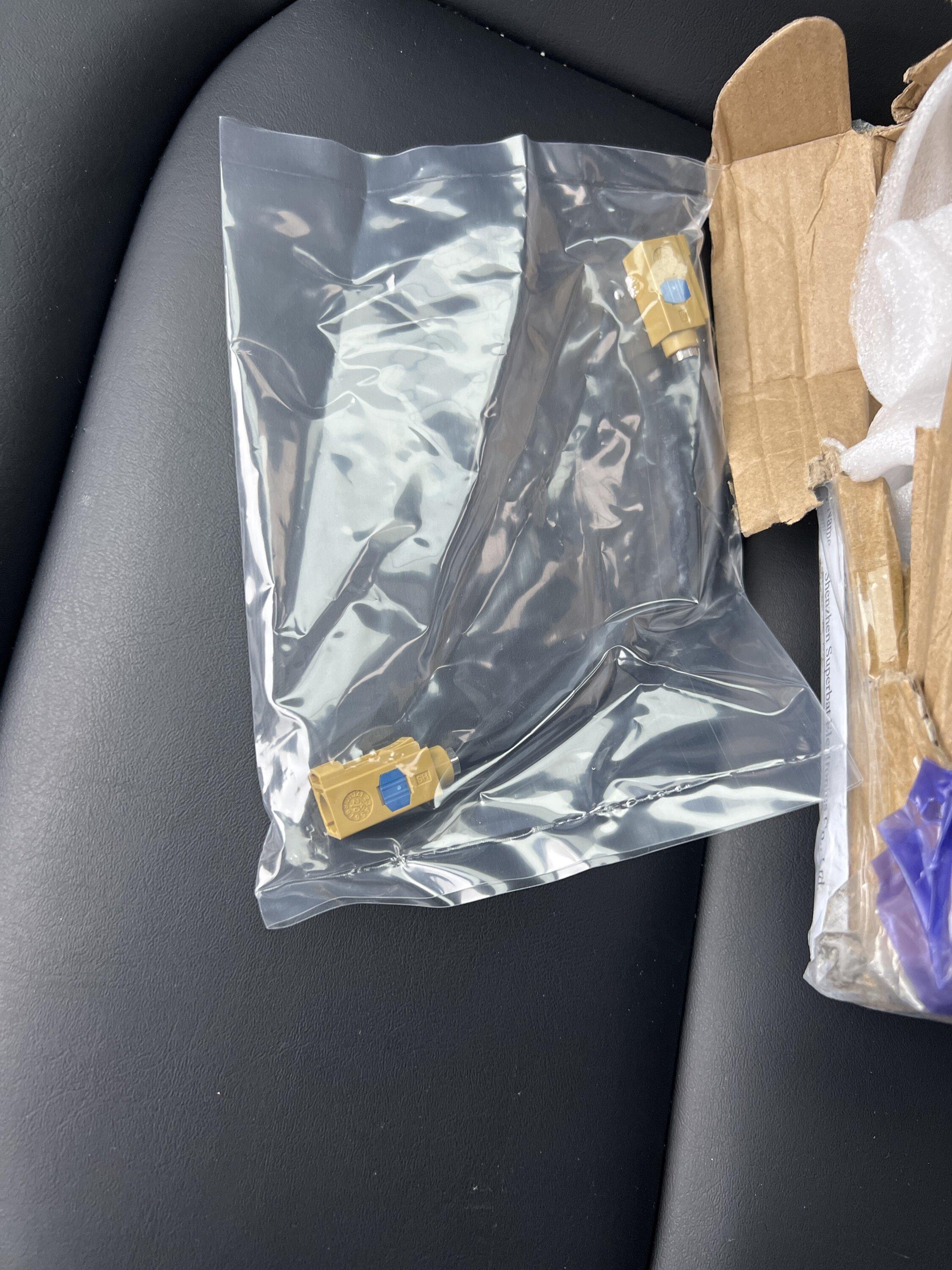

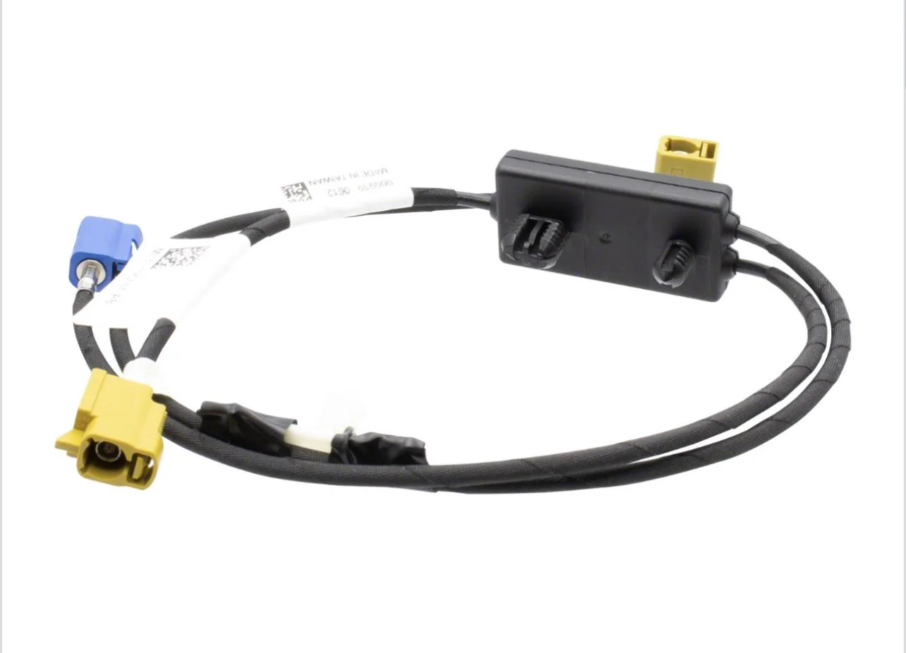

I did get the splitter too maybe that does it?

I would suggest reading the first post entirely again to make sure all steps have been covered.
You will disassemble the antenna you remove from the truck in order to remove the GPS chip with blue lead. Connect that to the body harness as it was before and you will not have any DTC issue in the TCM. You won't use the blue connector on that splitter unless you add a navigation APIM.

tools needed are a small torx bit , the same that are on the bottom of the new antenna,. I used a drill press to enlarge the hole that the antenna wire runs thru, enough that you can get the connector thru the hole. connect the blue connectors in the roof , tape it oriented the same way on top of your headliner. I put my antenna in a small baggie before taping it onto the headiner , probably not a needed step i just happened to have one handy at the time.

Pulling that GPS chip out of the old antenna was hardest part of this process for me.

The blue male connector does come off the actual terminal itself making the job much easier. A small screwdriver and a pick of some sort will release the tabs. It pops back on.
