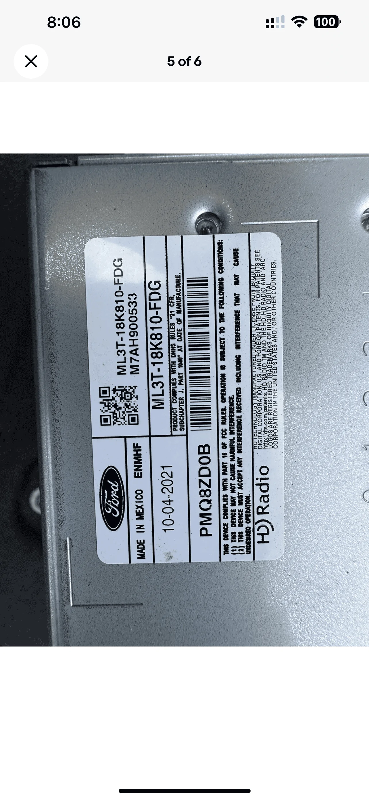

Reason I ask is because I keyed in the radio id on xm and nothing proceeded I’m assuming I’ll have to call like other posts and link to the car?
Texas2022XLT
Jan 13, 2023
303
131
2022 F150 XLT 302A
Yeap that ACM is good, yes you’ll need to call them or do the online chat.
Correct they have no record of that unit at all in their system. They must key it in manually. You should also get 3 months free service, mention you purchased a new ford.
