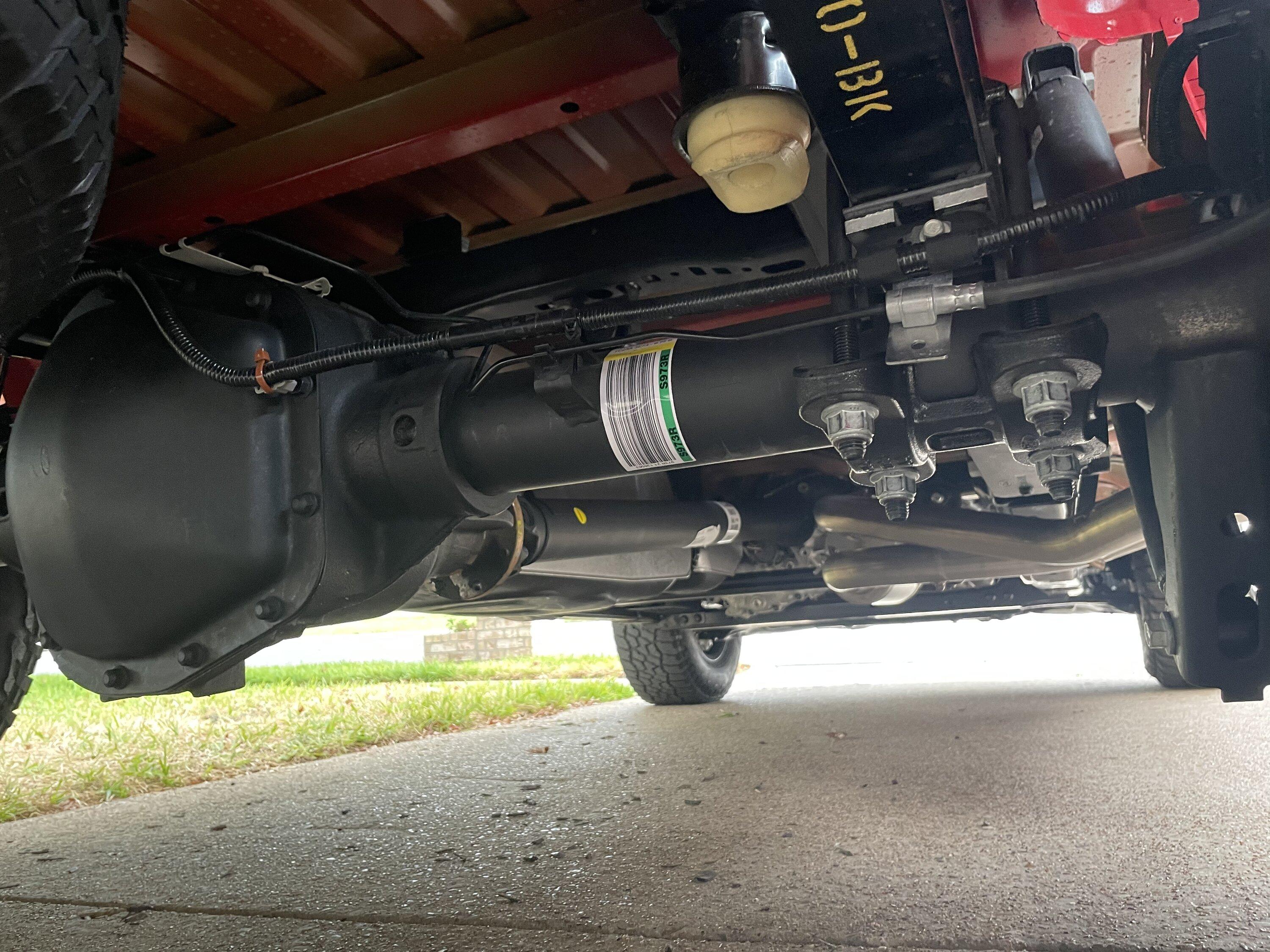

Just did the reverse level. 1” max trac shackles, 2wd unbolts, and 2.5 degree shims. I have a ford dealer as a sister store so the bolts were like $100 and the shackles were like another $100. Shims were like $20-$30. Just did it myself in driveway.
Per chance, did you measure before and after pinion angle?
BTW - that is the way the undercarriage should look on every truck delivered by Ford. Crisp and Clean.
I didn’t measure sure before but this is after
