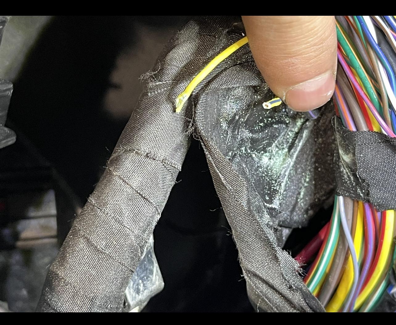

Mine had a bunch of errors pop up and wouldn’t start. Dealer found a broken wire in the harness connecting to the body control module. Sounds like it got pinched somehow and worked it’s way apart.
