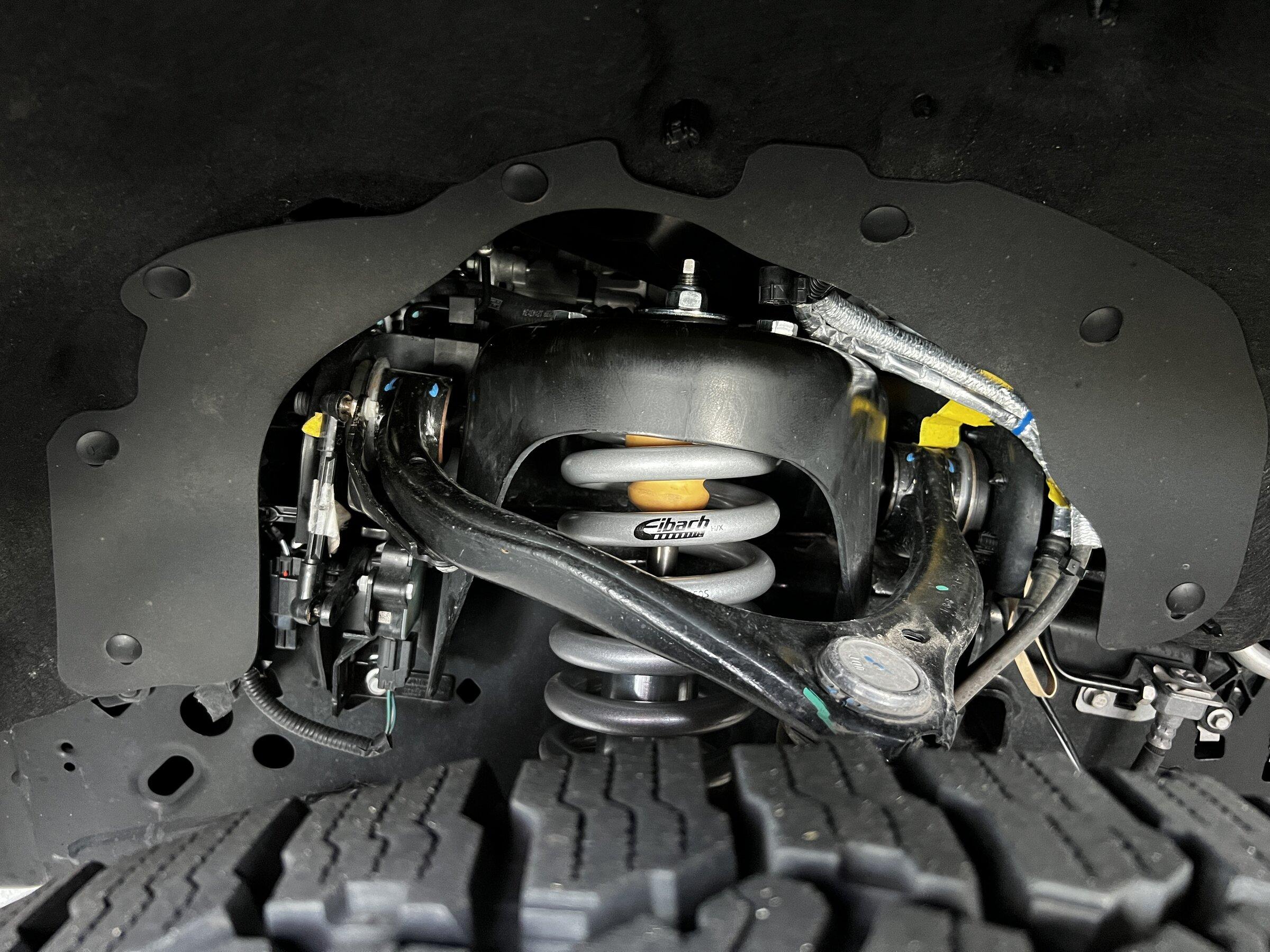

What up gang…thought I’d share my new truck. Long story short: had an Oxford white on order with Ford, but got frustrated after 5 months of waiting and no end in sight. Flew to Colorado from SoCal last weekend to pick this beauty up and drove it home. Has everything I had on my order except for the work surface, that I probably never would have used anyways. In the 4 days I’ve had her, here’s what I’ve done:
Icon Rebound 17” wheels
Falken Wildpeak AT3 285/75/17
Eibach ProTruck coilovers set at 2”
Rear blocks removed

Looks incredible! What are your ground to fender measurements? I have a 2 inch level and I'm 40.5 in the front and 42 in the rear. Removing the block would leave me dead level and I'm wondering if that's where you're at?

Not sure…have never measured. I did however put the blocks back in after adding all my bed rack gear.

Thanks for the prompt response. Did it end up squatting easily? Also a concern of mine.

Not really no…it was really just a hair over level once I was fully loaded so I just popped them back in to even it back out.

Were you able to get the full 2” of level height in the front with the eibachs? I have been looking for a suspension level kit for my 22 platinum powerboost but everything from kings, fox, to even ford’s new bilstein colab level kit says “not recommend for powerboost”because of the powerboost extra curb weight. They’re not tuned for and won’t get full lift. I’ve also read if you have the adaptive turning headlamps or bluecruise changing control arms is a no go because of the sensor down there….

I never measured to see what it ended up at, but I had my shop turn them down 1/2” from how they come from Eibach (which they say is 2.5”) and Ive been very happy with it. On and off road performance is fantastic. I don’t have blue cruise but have had zero problems with adaptive cruise or headlights.

Thanks! I went with Eibach for 3 reasons:
1. I’d read that the spring rates they use are not as heavy as Fox (which lots of people claim to be too stiff) but not as light as stock. Don’t quote me on the numbers, but something like 500 pounds vs, stock which is like 400 and Fox which are 600. They appear to be right in the sweet spot.
2. I’ve been using Eibach stuff since my early days in the import scene, which is close to 25 years now, and have always been impressed. They actually make the springs that Fox/Rousch uses on their coilovers, along with lots of other OE manufacturers.
3. They’re local to me and have been long-time supporters of motor sports in SoCal. They host a big open house party every year that’s a ton of fun.
So far Im in love with the ride. Definitely got rid of that floaty feel going over bumps on the freeway, and less body roll in turns, but still a smooth luxury-feeling ride. Looking forward to seeing how they perform off road.
