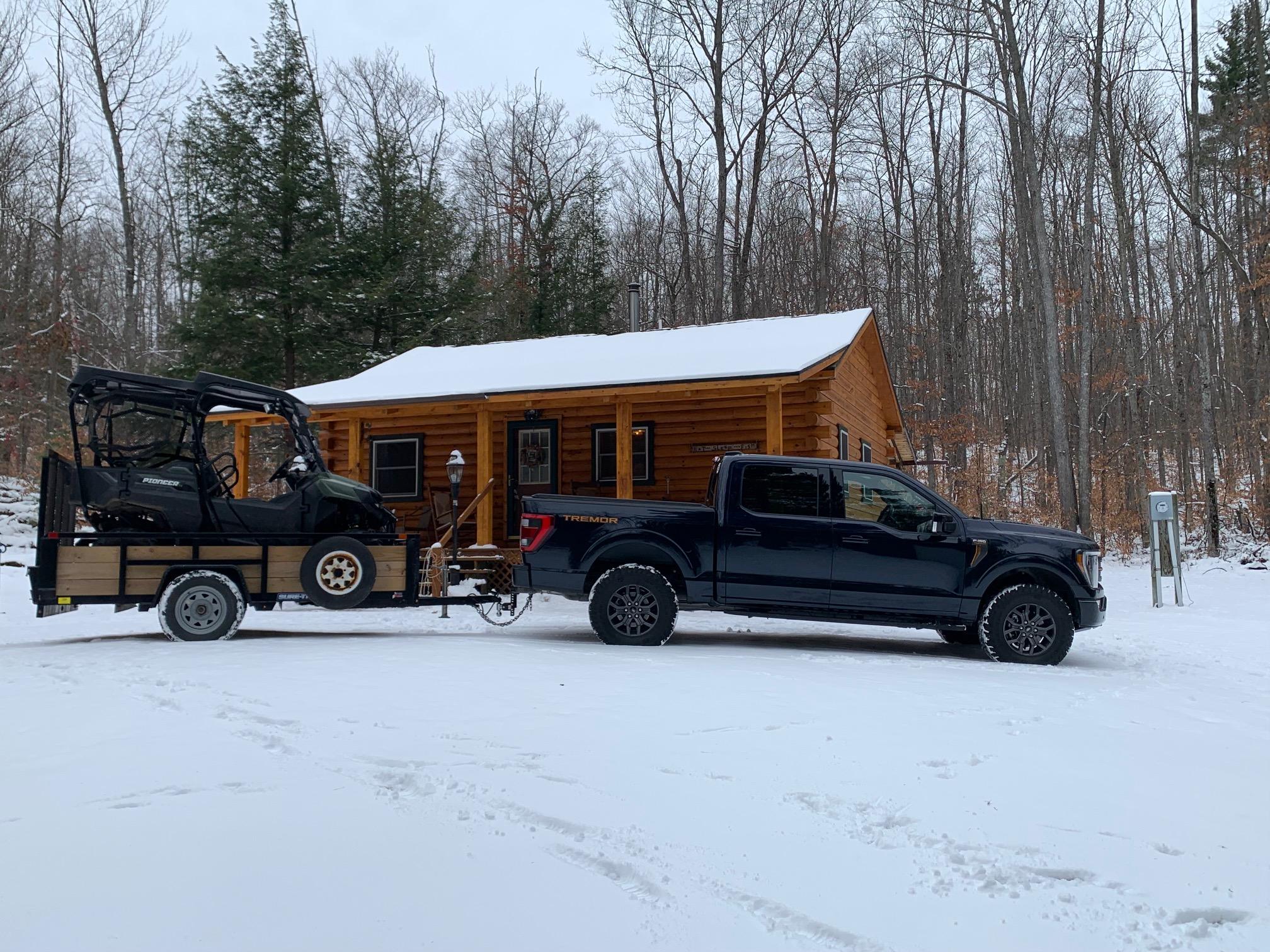

I'll normally get 17-19 MPG for my 300 mile trek to Northern Michigan, with no trailer. I got 10.4 with the cruise set at 72 MPH towing a 10ft utility trailer hauling a Honda Pioneer SXS in 28 - 32 degree weather. Between the mesh gate, the height of the Pioneer, and its windshield, it is like pulling a parachute back there. I did lock out the 9th and 10th gears to keep the turbo from blowing so hard. I was getting around 9MPG in SE Michigan flatlands before I locked out those gears.

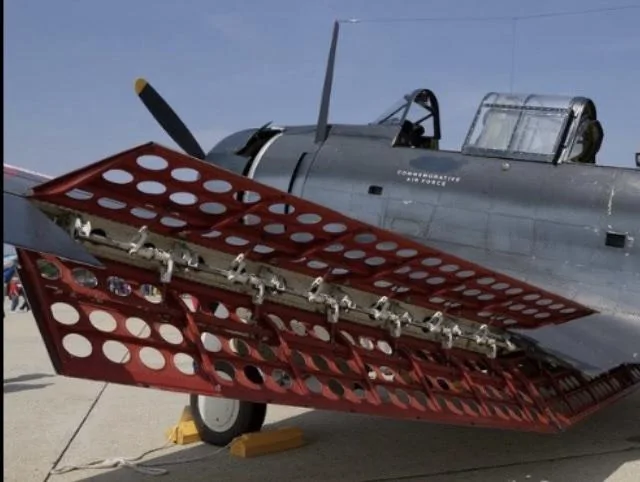

A lot of automotive journalists and forum members disparage the aerodynamic qualities of bricks and barn doors but there are things even worse.
That steel mesh ramp is basically a perforated air brake like the one on this WWII dive bomber, which is designed to allow it to descend straight down under power:

Yes, what another member said. That mesh ramp is just like a sale even though it has air flow through it. Once I towed a trailer with a ramp up empty to pick up a car, after loading the car I got the same MPGs with a 5000 lb car as I did with the ramp up empty. As well as make sure you're locking out 9th and 10th. But most of it is that aero drag.

Like many people have already said, the 4' mesh tailgate is what kills your mpg. It's a huge parachute.
Take it off, leave it at home, and bring some basic ramps along in the bed instead, you'll get half your mpg loss back. Tow/haul mode is optional, see if you like the shifting patterns better, but lock out 9th and 10th gears in any case.
