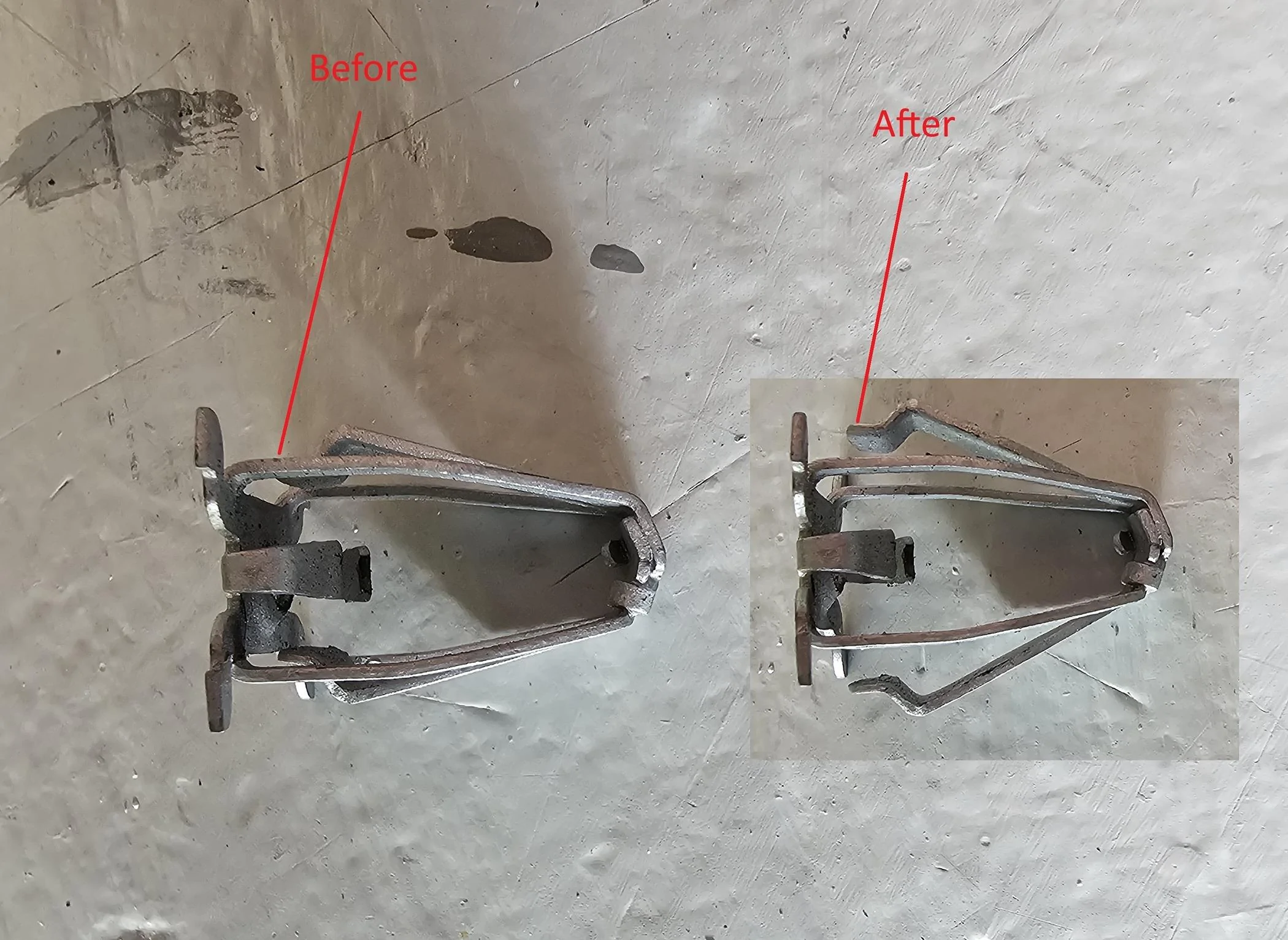

I just "fixed" mine. I was about to just live with the loose sun visors but my driver side fell out again. Serious safety issue (if I had been driving). Though that said, with the screw retainer now out, I was able to bend out the retaining clips. I was able to pop the screw retainer back in and that seems a bit more secure. Though when I remounted the visor it was obviously still bouncy loose. I again removed the visor and used some cut up toilet bowl shims (yes, that is funny and I cracked up when I thought about it, while I said, "What a piece of Crap"). I inserted the "crapper" shims behind the headliner at each side (4 total). The idea is to sandwich the headliner between the visor and mounting point. I reinstalled the visor and now it's tight. Doesn't move and doesn't bounce. The passenger side, although loose, wasn't wobbly, but I fixed that one too. This time with wooden shims (about 1/8" thick). Took about 10 minutes total to fix both side. I can't imaging ford is going to fix this but hope this helps until they do.
