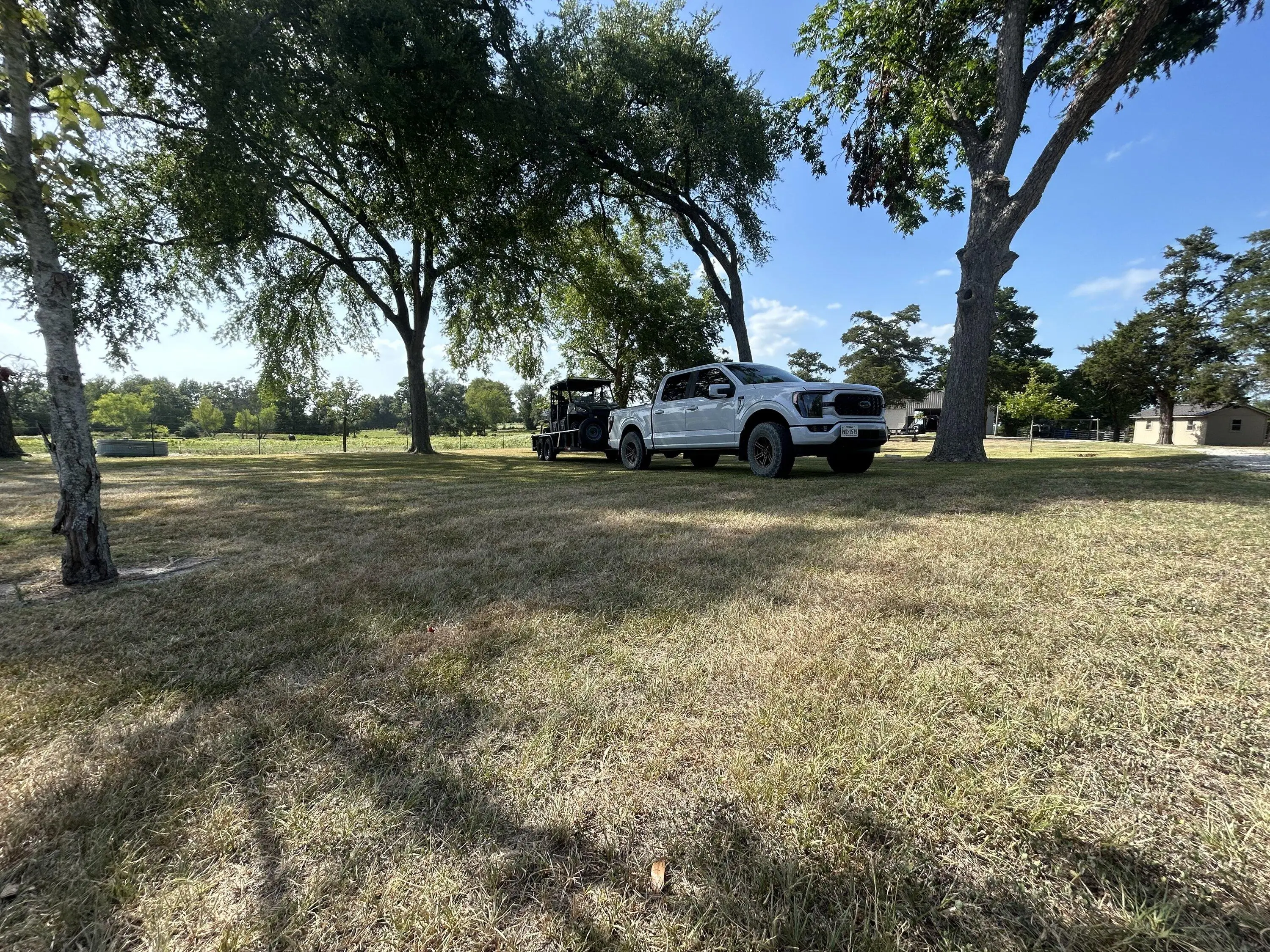

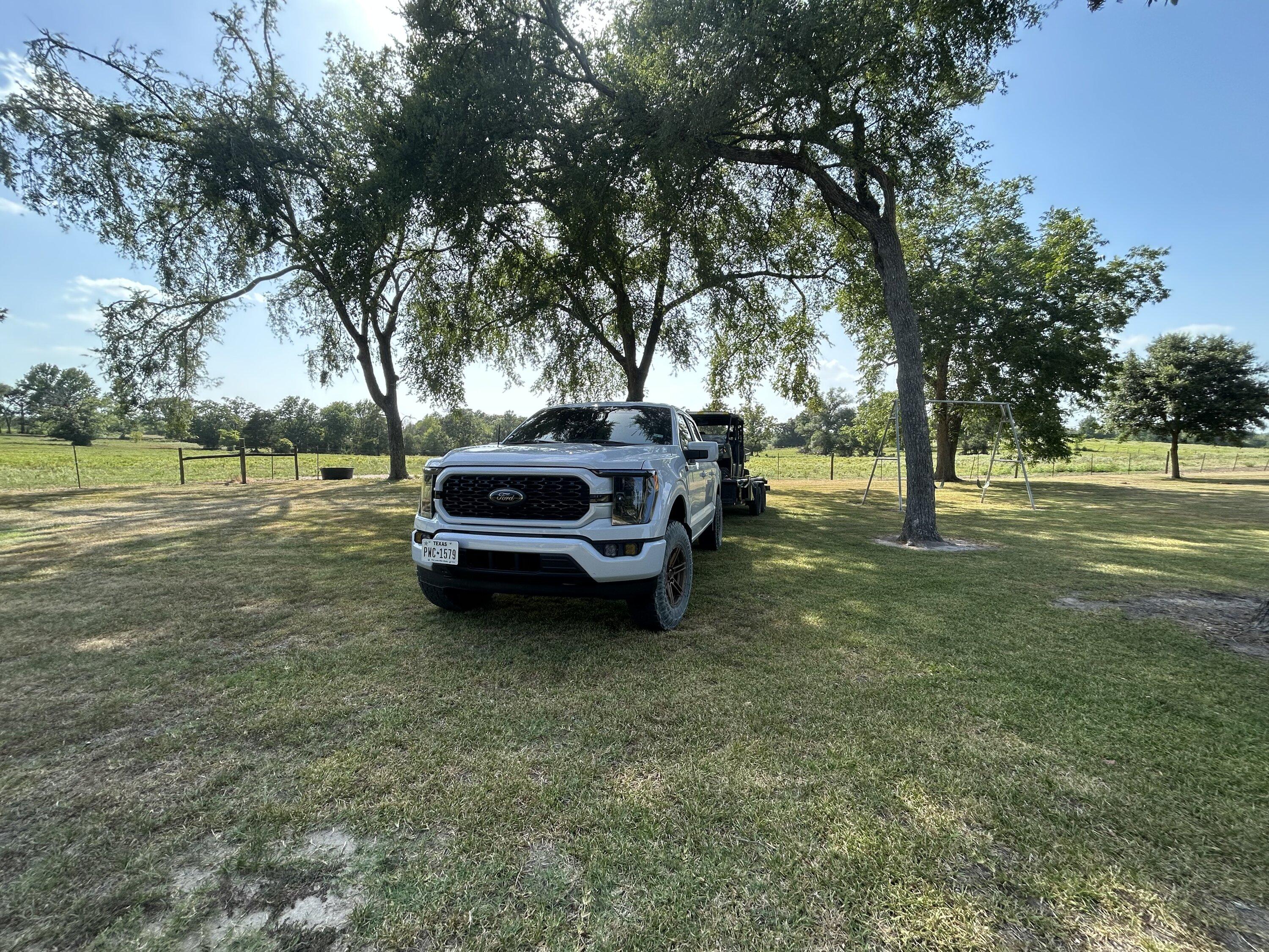

Leveled trucks put in work! They also handle the load better with the upgraded dampening with the bilstien 5100s on four corners and a higher load range tire! Just saying, pic’s show loaded with 4 people and ~5,000lbs.
Ford F-150 LEVEL VS KEEPING THE RAKE IMG_2757
Ford F-150 LEVEL VS KEEPING THE RAKE IMG_2758
Ford F-150 LEVEL VS KEEPING THE RAKE IMG_2759
Ford F-150 LEVEL VS KEEPING THE RAKE IMG_2569
Ford F-150 LEVEL VS KEEPING THE RAKE IMG_2761
*ground is slopped!
