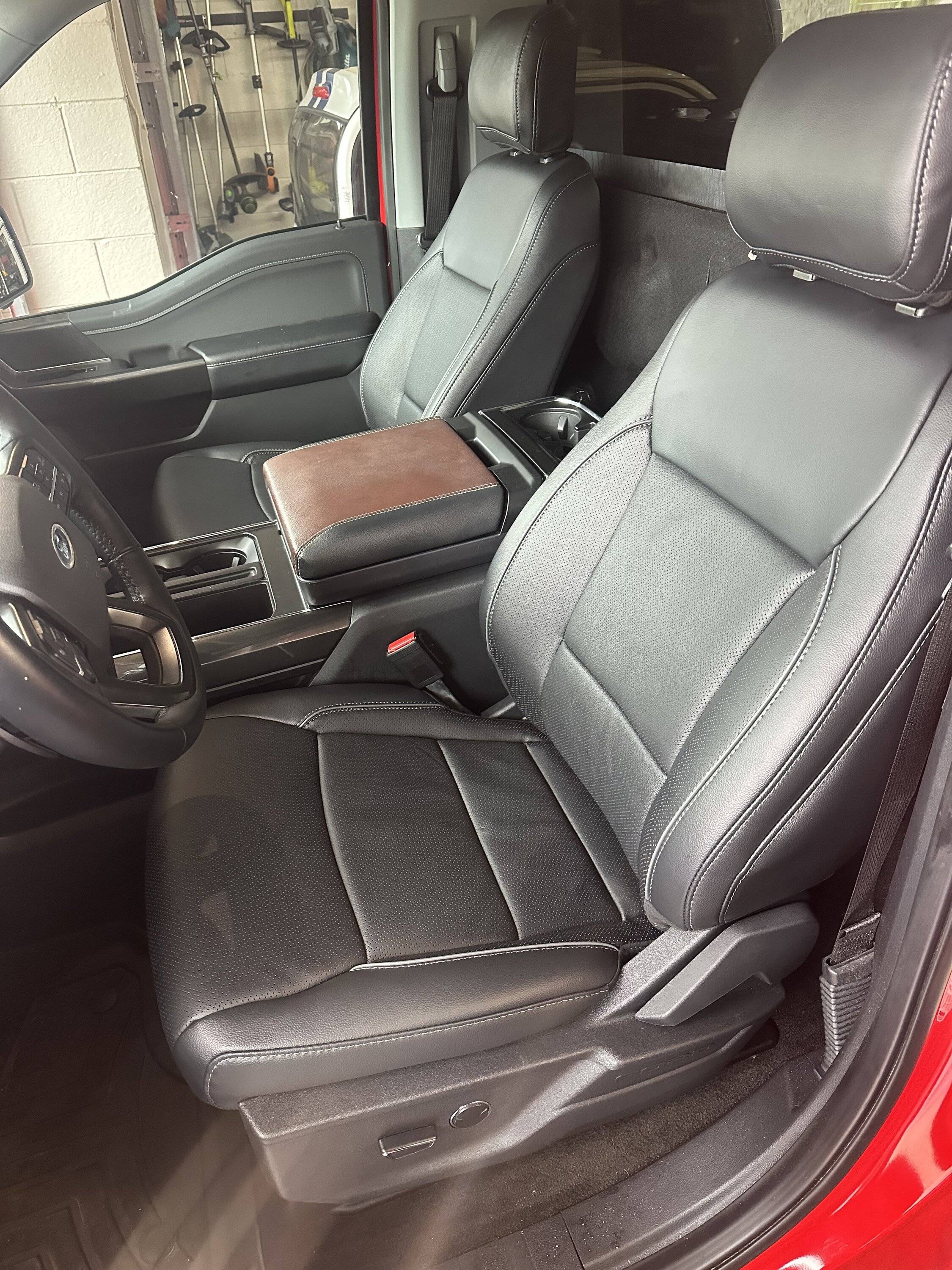

I was given an early Christmas present with some factory Lariat leather for my seats. I was intimidated at first then I watched the video and man it’s easy. I did both seats in about 2.5hrs.
eBay and it’s exact to my Lariat SD. The only thing that was different is the seat bottom cushion on the XLT has one blue plastic clip running across where the Lariat covers are all Velcro so there is one seam that is unattached. Doesn’t seem to affect it visually so I’m not going to sweat it.
I still have a few things to do but that was huge on looks. I’m going to get the center console lid recovered soon to get rid of the brown.
Looks nice but I would’ve went with the red brown piping to match your center console.
