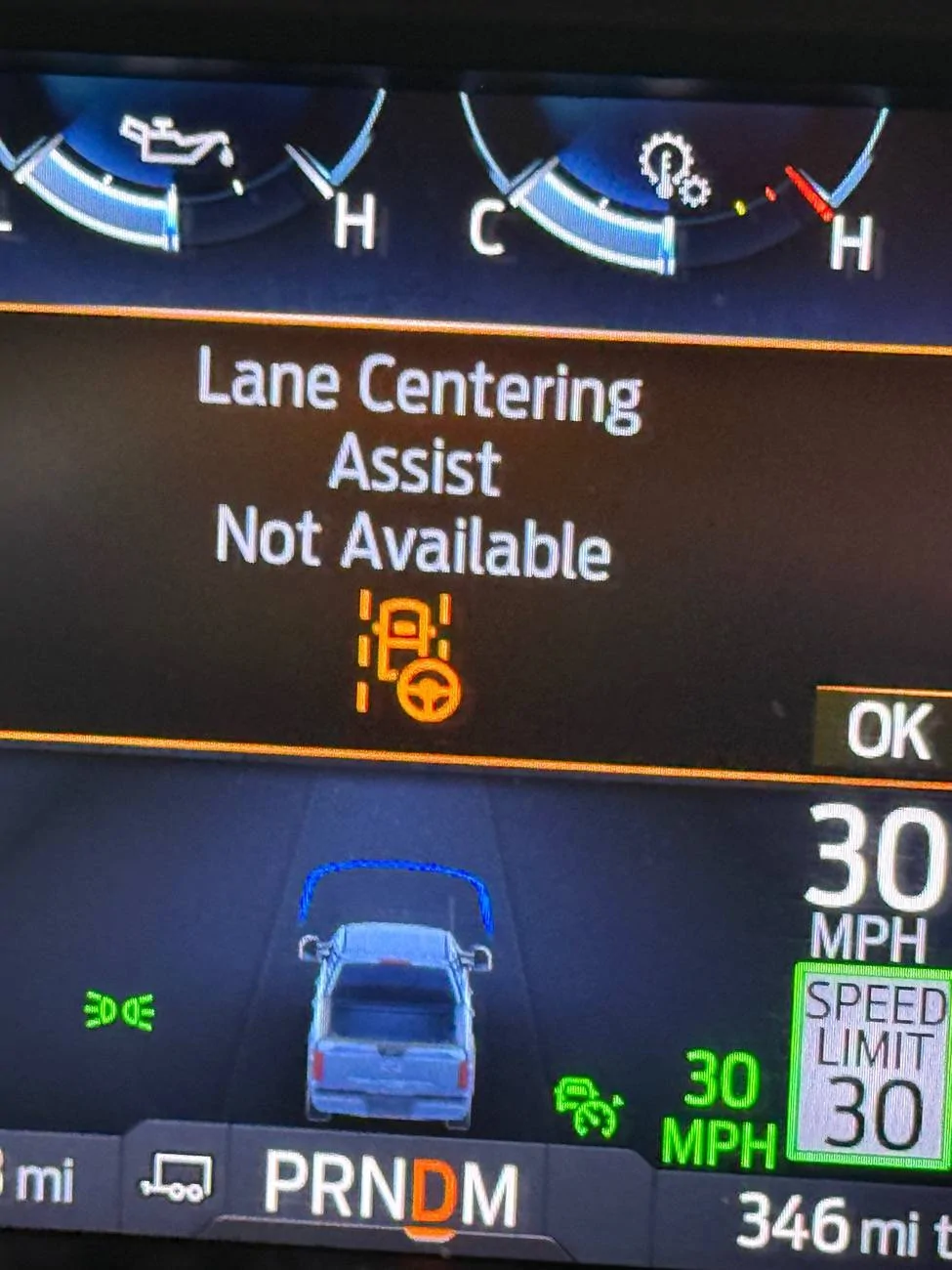

I also enjoyed having lane centering while using my bike rack with lights. Don’t see any safety issues with that, in fact I’m probably less safe now since I just don’t plug the lights in.
@rugedraw if you and Jesse find something that might help re-enable please PM me! I chatted about this with @superfordman a bit ago but it seemed baked into the firmware, couldn’t find a forscan workaround.

Yep, this has been baked into IPMA since MY23 and all the newer software is trickling down now if you update. Love having LC when I towed my RZR but lost it as soon as I got my 23. Tried everything in the book, there is a whole thread on this from a ways back, and nothing would do it. As soon as it see's a lamp signal on the 7 or 4 pin and a trailer connected, it kills it. So @rugedraw don't waste your time, we already have our answer. You could for sure backdate if you want and get all the right files, just would be running older software. I keep seeing these tail light decoders offered by some companies and wanted to try them out maybe to at least get lights to the trailer without the truck even knowing a trailer is connected.

Yea, brother......better people than me tried and couldn't figure it out. I'm not going down that rabbit hole. :ROFLMAO:
