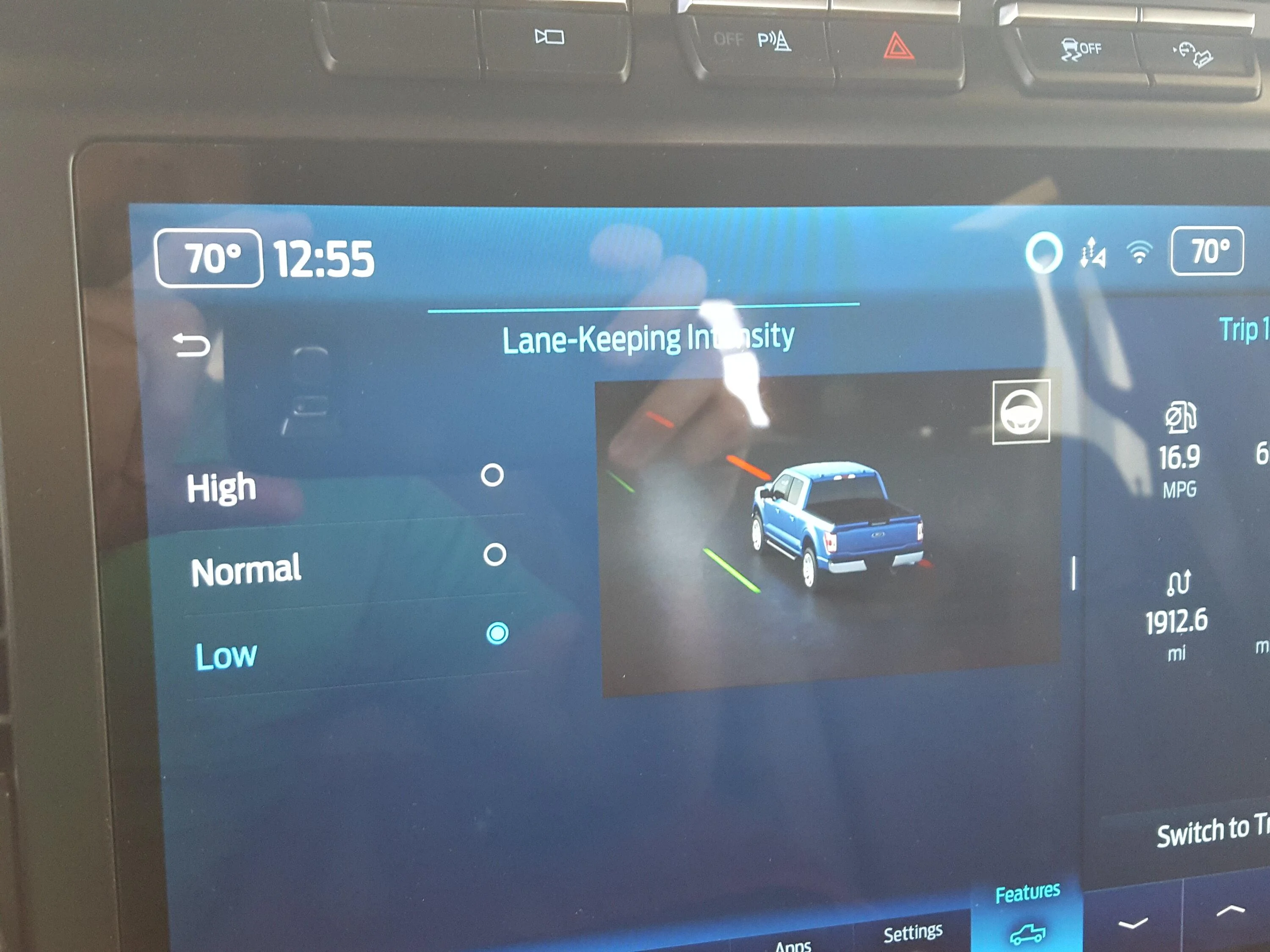

found the screen , mine was set at NORMAL and changed it to low
but does mean the sensitivity to stay in a lane is low, or its the driver input resistance is low?
pretty vague screen
and yes my trip mpg is horrible
Ford F-150 lane centering and lane drift lane centering
pretty vague screen

Looking forward to YOUR feedback on how the settings change actually affected lane keeping experience.

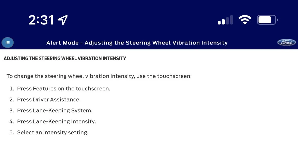

Lane Keeping Intestity is a setting to adjust how much your wheel vibrates in Alert mode if you drive over the line (three pulses). It does not adjust steering torque.
Ford F-150 lane centering and lane drift 644EC028-72CB-4D84-A7FC-A55844BD3644
https://www.fordservicecontent.com/...&userMarket=USA&div=f&vFilteringEnabled=False

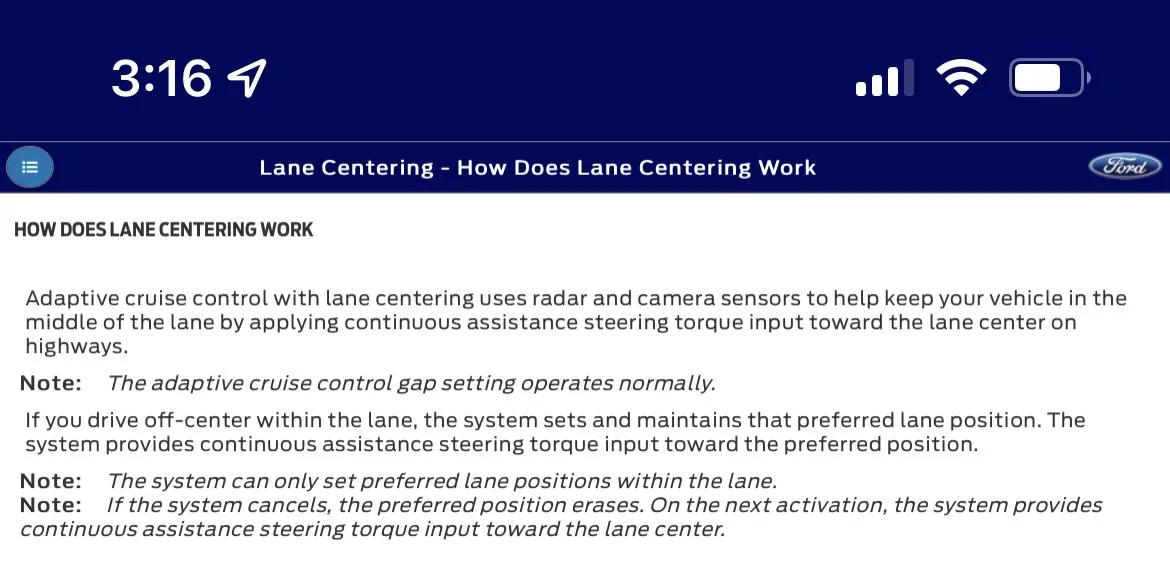

Related to the topic, this is in the manual too:
Ford F-150 lane centering and lane drift B21E5F02-768B-4CEB-99C1-4AEE959BF859
But I don't know if adjusting the position was something BlueCruise kept or not?

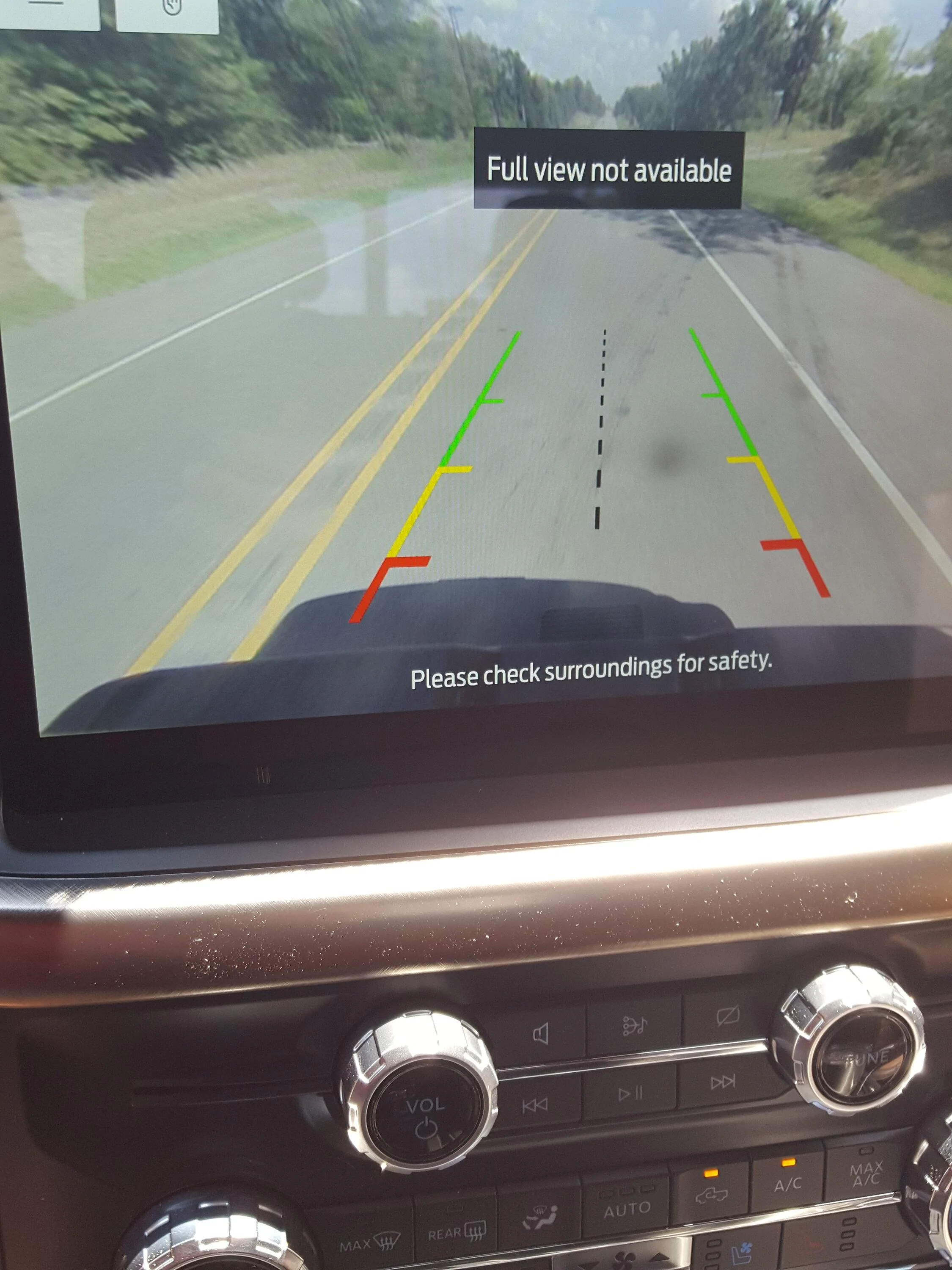

i just drove 19 miles at 65 to 70 on 2 lane well marked road with setting on LOW . it wandered all over the lane and kept me close to the left side
on return trip , same road same speeds i selected HIGH and it put me in the MIDDLE and tended to be more on right than the left as before and it wandered a whole lot less..
drag or driver input pressure IMO was same on both settings
i did snap ap pic (driver distracted) to show the rear view on HIGH its centered more than it was on low or normal, still to the left but not nearly as much, it was more comfortable to me as trucks passed me in the other lane

Lane Keeping Intestity is the intensity of the steering wheel vibration alert when you drive too far over the line.
Any change you see to lane centering or "drag" is a coincidence.

i get that
but how do we get it to stay more centered vice the tendency to hug left line closer, even though its probably not that close in real world terms.
and then why on same road on low it wandered, but on high it tended to not wander as much?
my only explanation for science is the SUN.
it was 1:15 pm going north , with sun and clouds to my south west, return trip was 1:37pm heading south and some clouds to the south west of me
wind was light and most likely less than 2 mph as lake was smooth as glass
i did have considerably different vehicles in front of me both ways. on way up was a sedan and return was no one for about 10 miles then it was an older jeep, and a deputy in front of him
imo drag from driver on wheel was same as i felt it and described

Now that we have (again ;)), at least for this post, clarified Keeping vs Centering....those wishing for a "trim" knob to set the Center position may be missing what was posted above from Owner's Manual:
"If you drive off-center within the lane, the
system sets and maintains that preferred
lane position. The system provides
continuous assistance steering torque
input toward the preferred position."
"Note: If the system cancels, the preferred
position erases. On the next activation, the
system provides continuous assistance
steering torque input toward the lane center"
Of course not exactly a trim knob, especially since it is only good for 1 use (i.e. it resets after each restarting of an ACC or BC session). But you should be able to "force and hold" the position you want in the lane "center" for a little bit and then it will use that.
