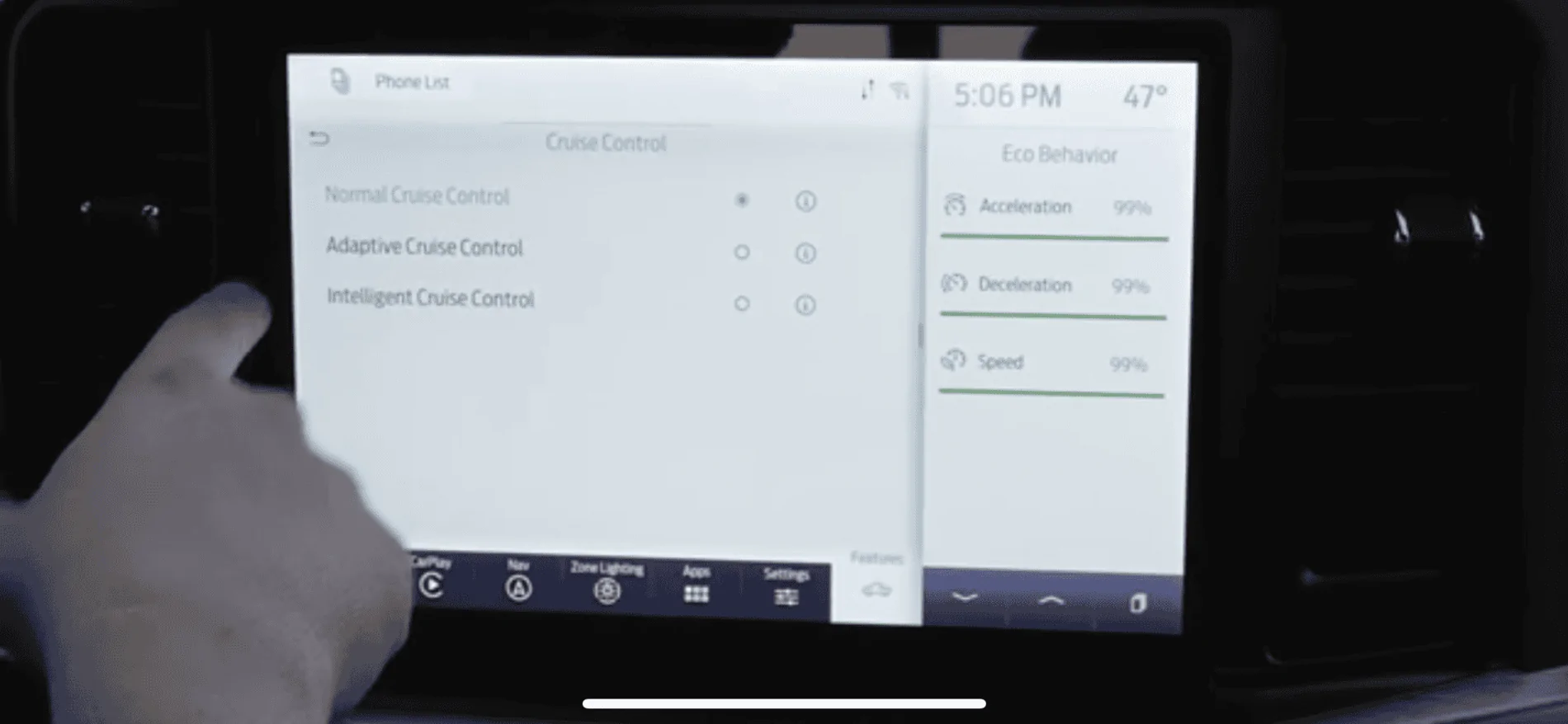

I don’t have the luxury of having my truck yet, but this tutorial video on the other thread was pretty helpful ?
He goes over cruise control settings beginning around the 35:55 mark.
https://www.f150gen14.com/forum/threads/full-video-tutorial-of-sync-4-system-in-the-2021-f-150.2037/
In the “features” section, you can go to the Driver Assist features and adjust the three different cruise control levels, Normal, Adaptive, and Intelligent.
Hope this helps!

You want the Lane Keeping setting set to "Alert".
This is not the same system as ACC with Lane Centering.

Thanks. turning off lane centering under the cruise control section worked.
i kept switching around the lane keeping options with no luck.
