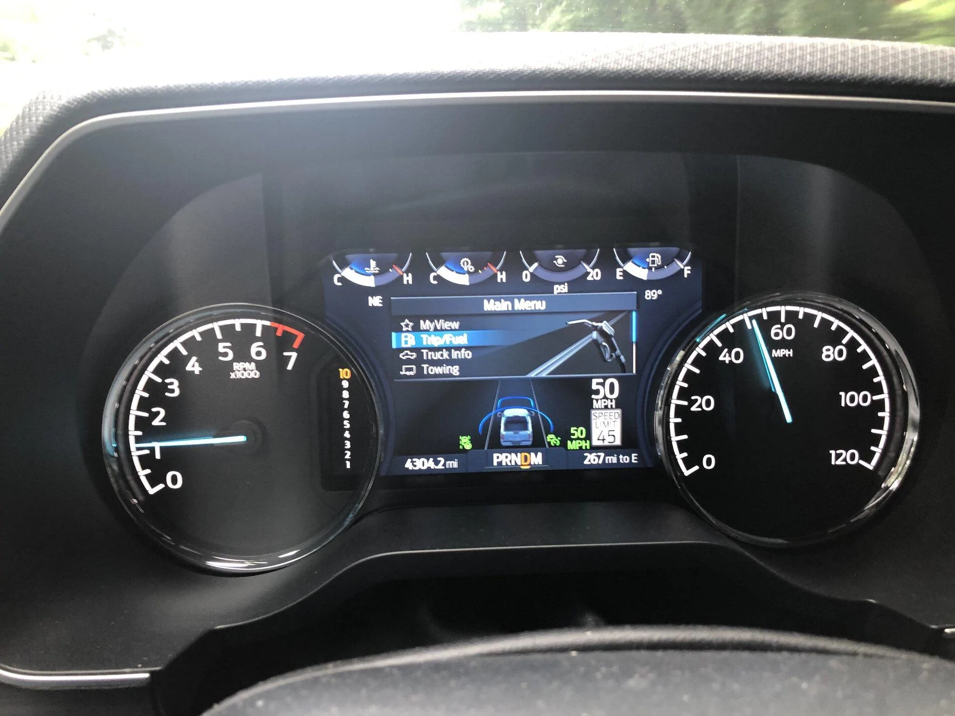

You have lane centering enabled in that pic.
The U in front of you is representing that adaptive cruise is enabled, that’ll be on whether lane centering is or or not. The lane centering being active and “locked on” is represented by the blue semicircles to the left snd right of the truck.
