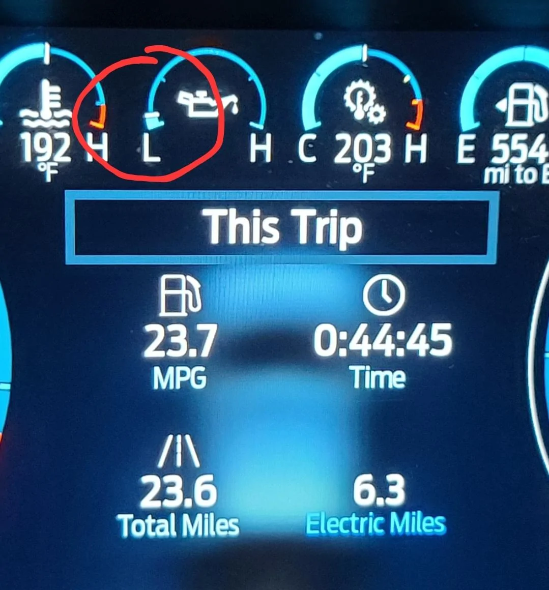

Ford Escape Hybrids have been known to spin bearings specifically because of going to high power from electric ops. My PowerBoost shows an oil pressure of zero during electric ops.
Your oil pressure gauge doesn't have that little space above zero pressure? Admittedly the gauge cluster doesn't have a numerical value for that position, but the ODB is reporting between 14.8 & 15.4 psi at that gauge spot.
Ford F-150 Lag then Quick Acceleration from electric to gas? Screenshot_20220216-180628_Gallery

K, I'll get out my magnifying glass and look more closely... If you're seeing something that says a pressure is present, then either they put in an air bladder oil source or a small electric oil pump that kicks in when the engine stops. I put just such an oil pump into the Escape Hybrid I've owned since new in 2006. It kicks in when engine oil pressure drops below 15#. Purpose is simply to keep oil pressure on the bearings. I had had a jump from engine off to high power blending in with traffic... Heard a thump. Based on my experience in Navy Submarine Force engineering, I took a hint and put that in. The Escape Hybrid is still going strong.
