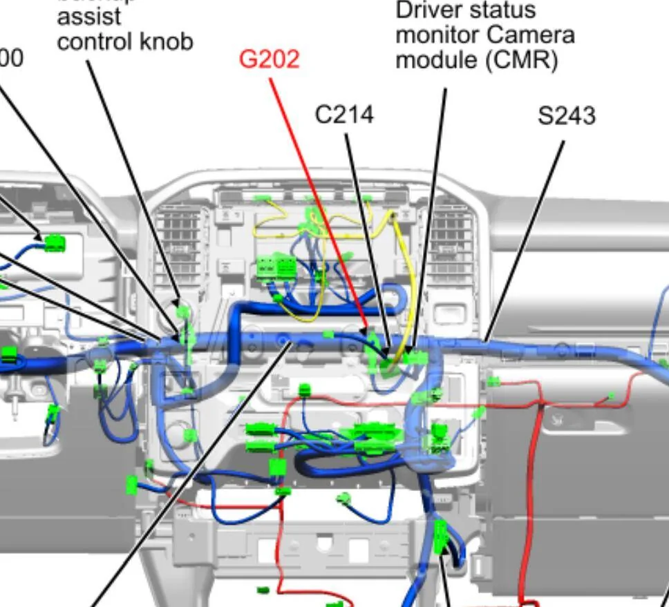

Not sure where you grounded the amp but you might try running your ground to the same point (G202) the ACM grounds as that's where the factory amp is. It's in the dash. Unsure best method for accessing it.
If it's the locatiin I'm thinking of, it will require pulling the HVAC module to access it. Where do you have the amp grounded currently? Could there be a better ground more accessible you could try first?

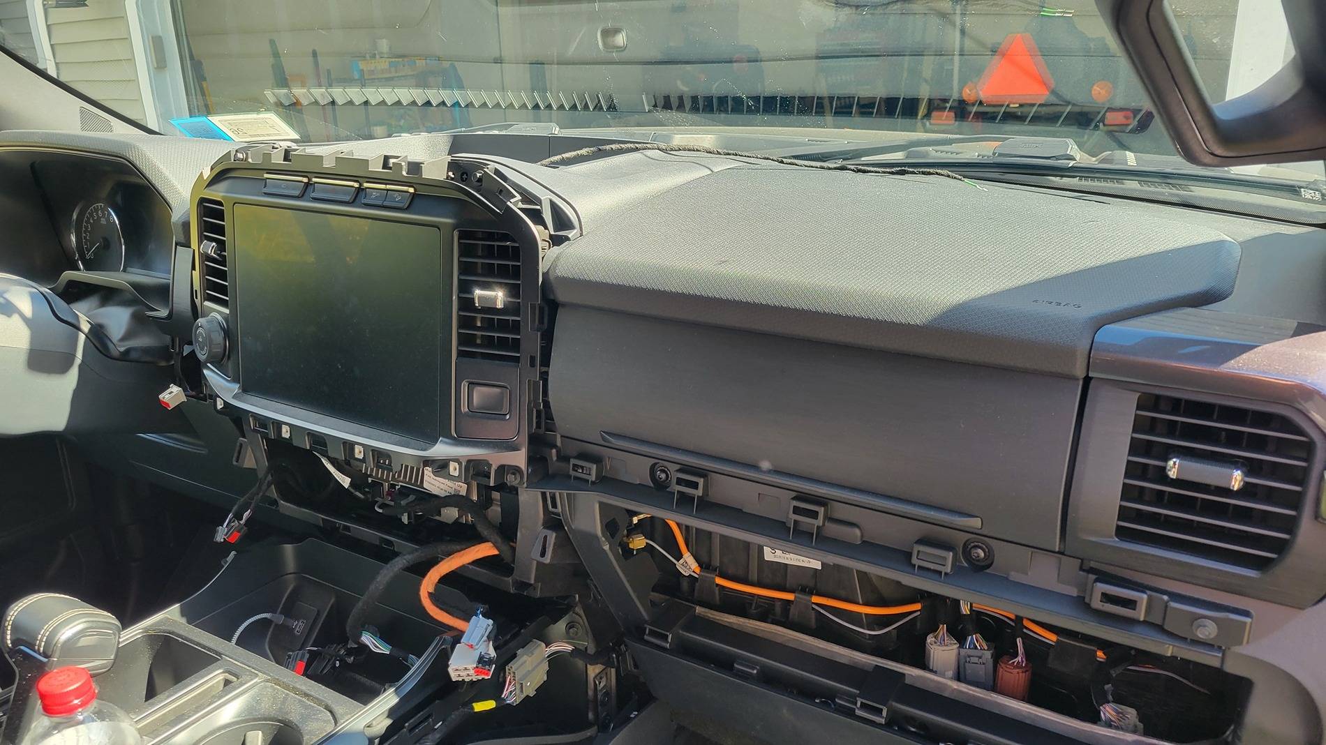

Ford F-150 Kicker Key200.4 - Great sound with one big problem 1000013644
Might be able to access it behind the screen -- I have no idea of its exact position.

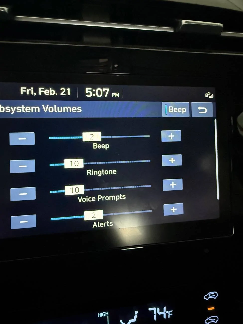

Here is a photo of the settings in my wife’s Hyundai. Wish our trucks had this adjustability.
