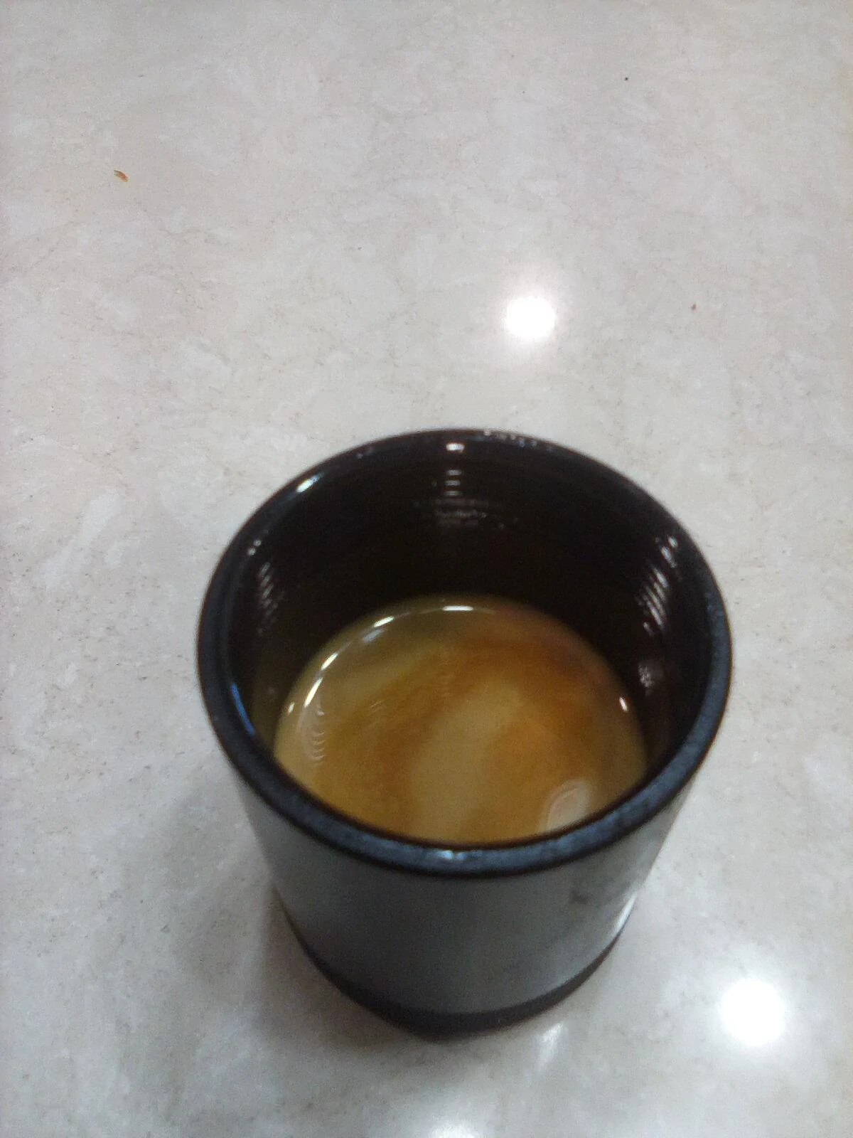

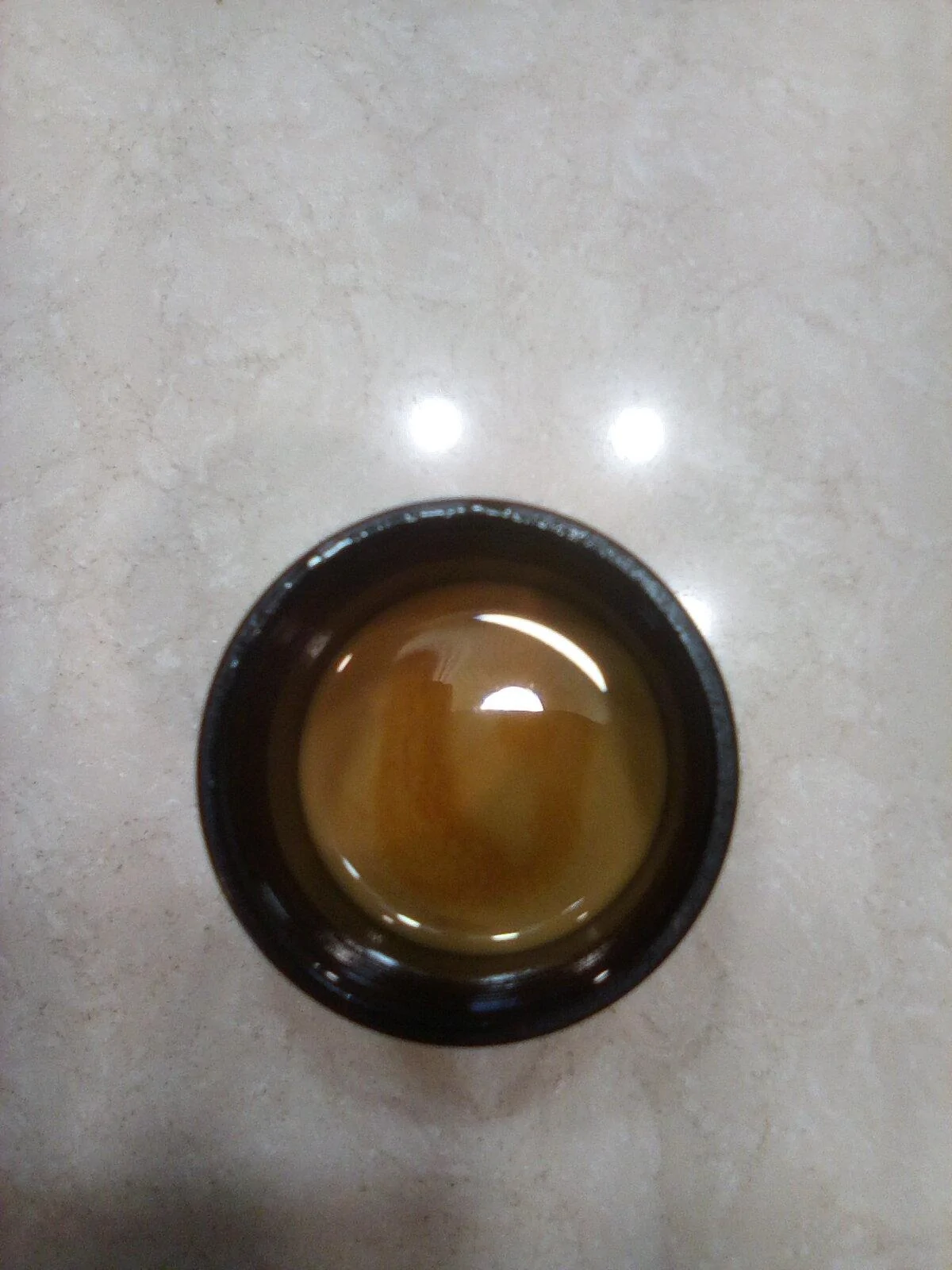

Installed a J&L oil separator at<100 miles. The catch can is just over half full at 3,350 miles.
Ford F-150 J&L Oil Separator 3.5L Ecoboost IMG_20220129_130104
Ford F-150 J&L Oil Separator 3.5L Ecoboost IMG_20220129_130132
So, that's about 1.5oz (noting J&L says the capacity is 3 oz)?
Personally, it's hard for me to get concerned or 'unnerved' about ~1/2oz per 1000 miles, especially with PFDI.

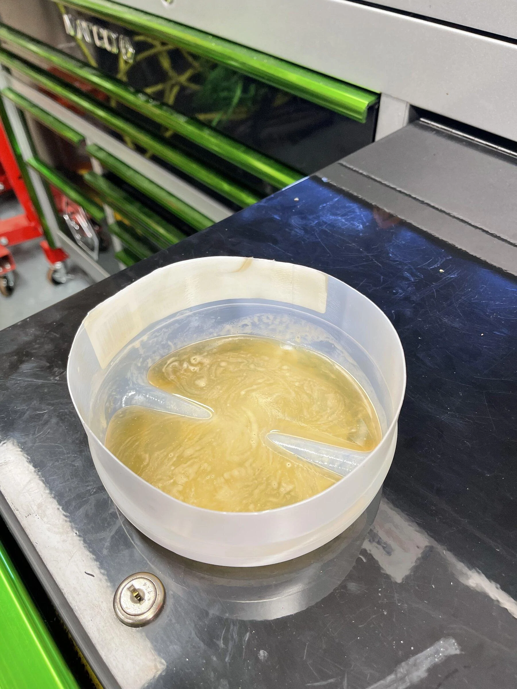

And 4500 miles
Ford F-150 J&L Oil Separator 3.5L Ecoboost 9F5673E3-E91D-4E47-B0A7-0B171425AD63

That’s actually a little unnerving.
It's only been designed into every engine that's gone several hundred thousand miles since PCV systems were implemented in the 60's. Definitely a non-issue since port-injected, too.
