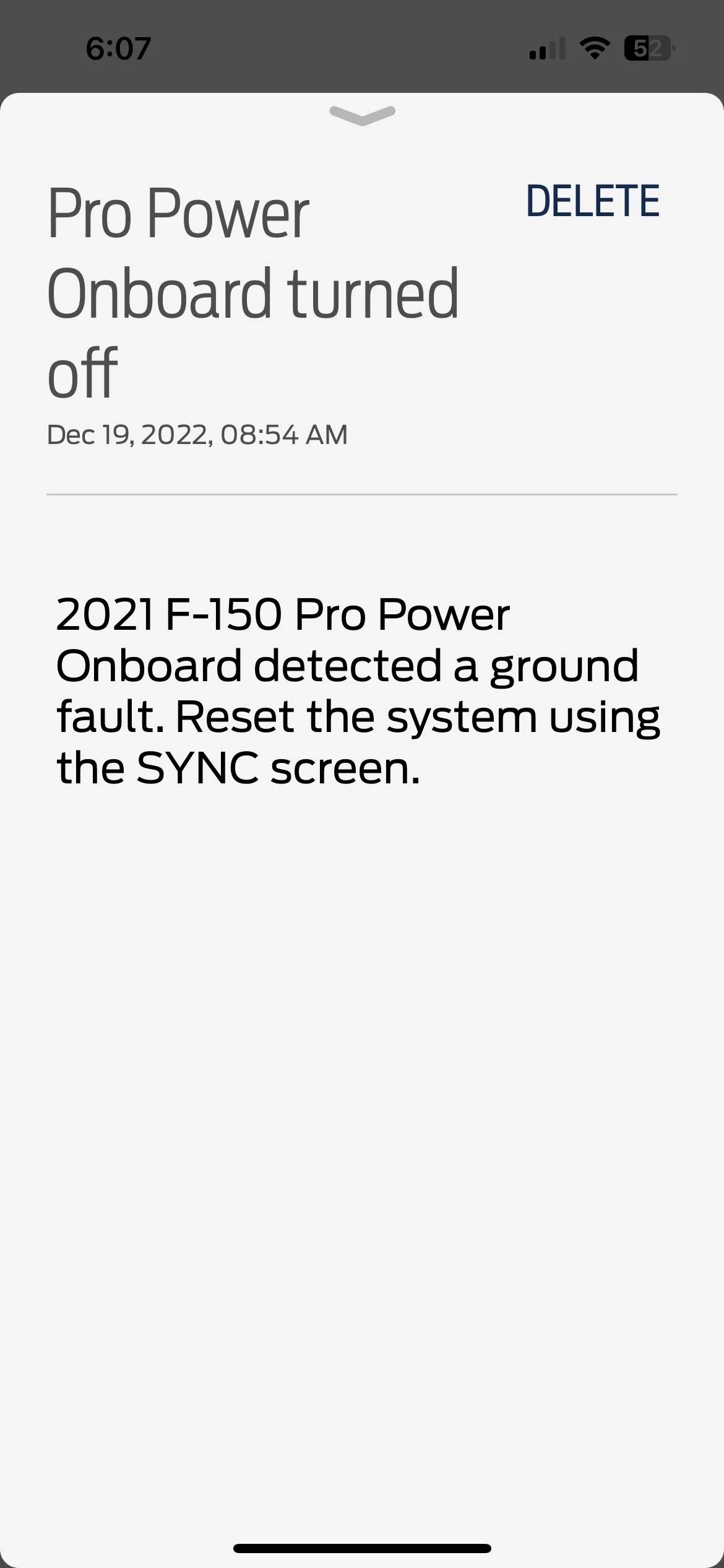

So here we go again, the first snow of the year and WHAM, Pro Power Onboard tured off. So much for the garbage story that a software update will fix it last April but now I get it on my Ford Pass app too.

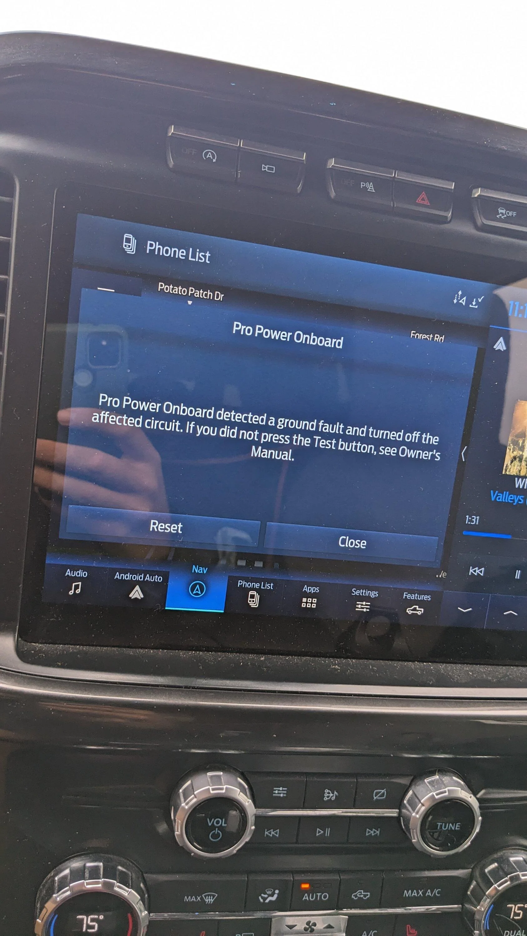

Following this thread, as I just had this exact same thing happen to me. I have the 2.4kw, and use it to charge an electric moto between rides. I haven't used it for months. I blasted through some 3' snow drifts, throwing snow on the windshield. Got on the highway, cruising at 80mph, and it flashed at me. Hit the reset multiple times, nothing. Unplugged the genset connectors, turned on the truck, turned off the truck, plugged it back in.... gave me the fault again. Truck sat for two days... seemed fine for about 45min on a drive up to the ski track – right at the top, got the error again. I have an appointment w/ the dealership, but I honestly have ZERO faith in them when it comes to electrical/software – had to buy and mongoose controller and clear some codes/update modules myself late last summer.
Oh, I should mention: I have turned off OTA updates, since my fiasco last summer. So I know this has NOTHING to do w/ software.
Here's a pick of the recurring message:
